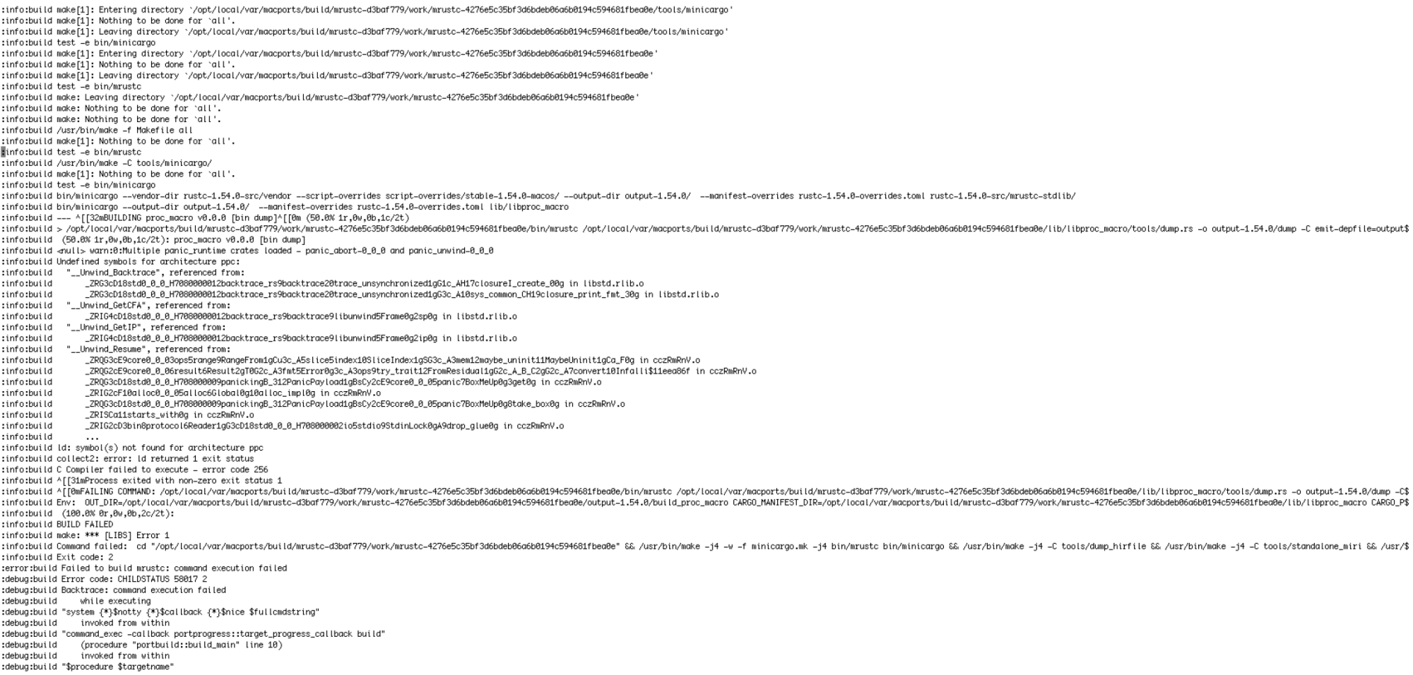

EDIT: I get an error related to Unwind semantics when I build mrustc on Leopard. I think I can edit the `config.toml` to tell rustbuild to build std using abort-only panics, but I'm not sure if that's the move here...
EDIT: I get an error related to Unwind semantics when I build mrustc on Leopard. I think I can edit the `config.toml` to tell rustbuild to build std using abort-only panics, but I'm not sure if that's the move here...View attachment 2594618
Yeah, that’s what @Matias_ reported recently: https://github.com/macos-powerpc/powerpc-ports/issues/62#issuecomment-3720532444
The issue is that while 10.6 (incl. unofficial powerpc version) has libunwind in the system, 10.5 does not. It should work if libunwind (from ports) is linked, we just need to figure out how exactly to do that in this case.
