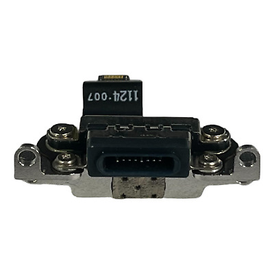

2. Search for a replacement part:
Forget it, there is only one seller and it costs 150€ in Germany.
I literally talked to every seller on Alibaba, whether they had this kind of cable, unfortunately now.
Also I don’t have the experience to design it myself and since I don’t want to spend 150€ for a device that broke three times, I gave up.

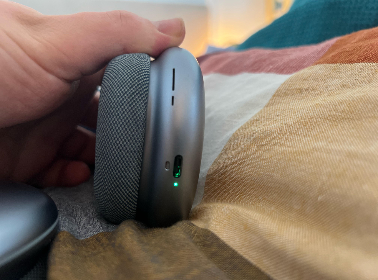

Apparently there is someone in Switzerland who made usb-c mods for AirPods and plans to do it for APM, so with all my trust I simply order, even though it was not released yet and well, look at this (Probably the photo is not embedded, but on top of this post). The mod arrived, unfortunately the small plastic microphone holder was broken on arrival, but Ken, the guy who made the mod sent me a new one, which was perfectly fine. I installed everything and they work! Wow everything works so smoothly and after almost 4 months without them, it’s so amazing to finally have them up running again! 🙂
Original Apple AirPods Max Repair 8 Pin Lighting Charger Port PCB (Black)- Parts | eBay
Original Apple Airpods repair part. Fits Model: Airpods Max.
www.ebay.com
