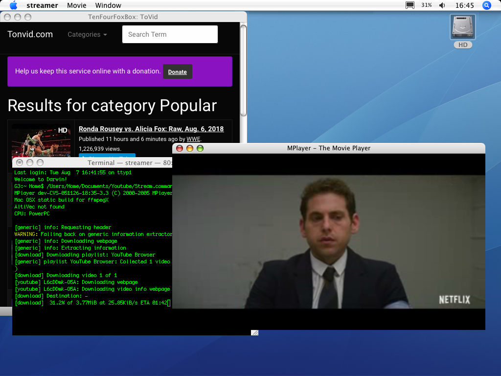

Omniweb and TenFourKit with a mobile device user agent going to https://m.youtube.com will give you instant playblack with maybe some dropped frames.
This method offers streaming but on a G3 the initial connection takes a while - downloading, then playing back is better:
https://forums.macrumors.com/threads/new-youtube-player-downloader-even-for-g3.2031523/
And this one is download then playback only:
https://forums.macrumors.com/threads/youtube-on-a-g3.2022464/
Streaming on my G3 today - note low CPU use top right:
