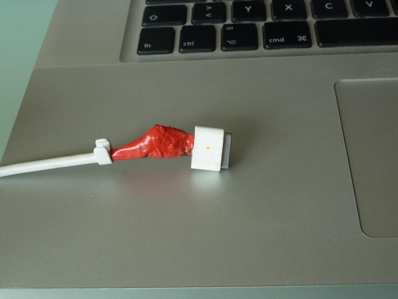

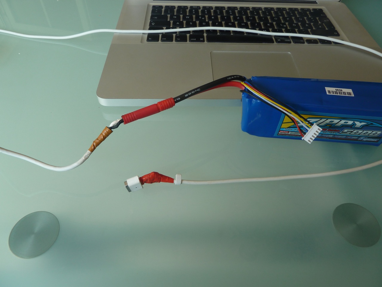

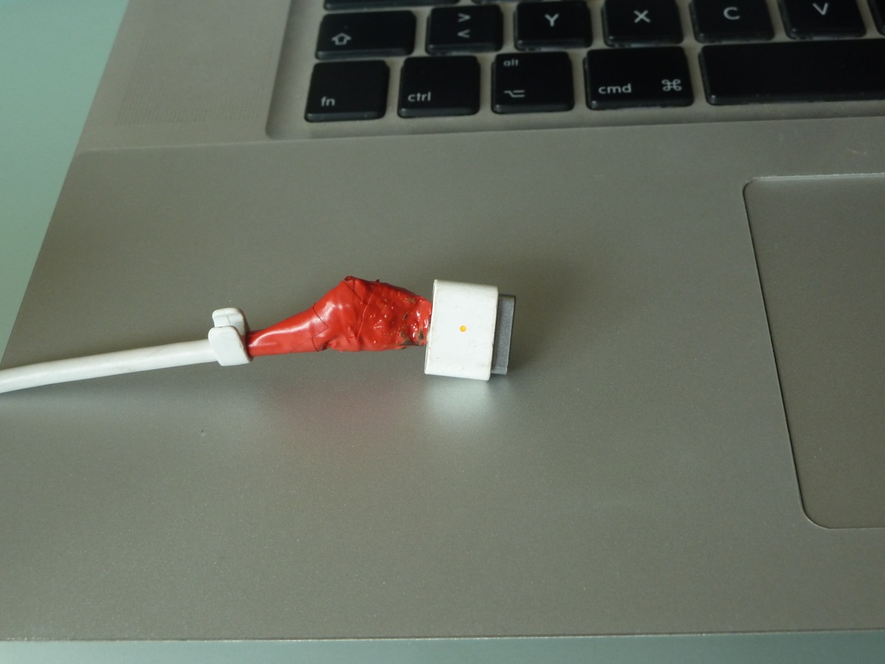

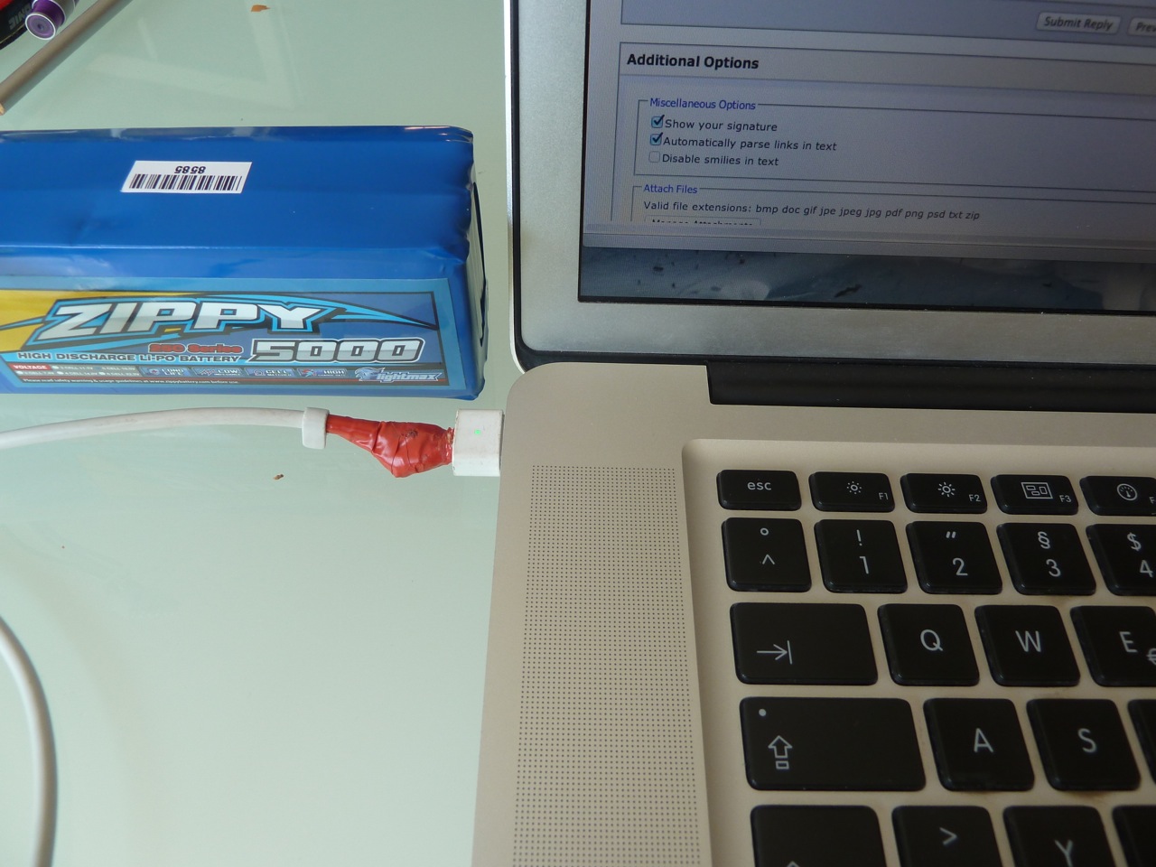

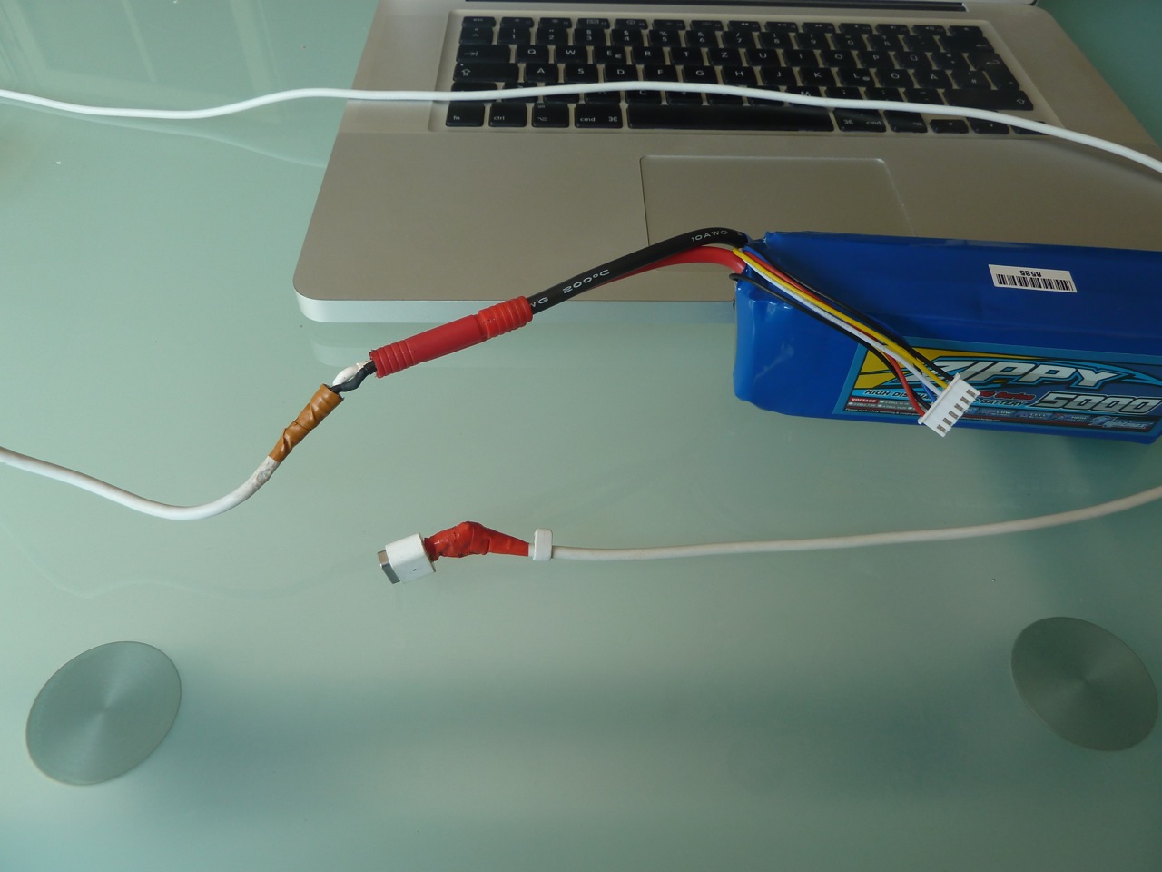

Good afternoon people 🙂
My battery arrived yesterday and the bullet connector the day before.
Sadly my charger has not arrived yet, should be tomorow 🙂
I spent the last hour soldering the cables together and testing. Soldering the magsafe cable to the bullet connectors was done in like 5 mins. I then plugged it into my MBP and heard a slight pop, and hiss. I unplugged it quickely and it stopped. The MBP wasn't indicating that it was being charged.
I checked the cable and found that the end, close to the magsafe was broken. I guess that was the reason for the charger to stop working. I didn't pay anything for the charger because it was a friends who wanted to through it out.
Took me 20 mins to fix this. I stripped the wires and reattached them, used special tape to wrap the wires in. The finished product does not look particularly nice but it seems to do the job.
Although I have not received my charger yet I started testing. Luckily there was some juice in the battery.
I plugged the magsafe into my MBP and the light lit up green, MBP indicated not charging, then it turned orange and it indicated that it is charging.
All seems perfect so far. I checked iStatMenues to see how many Watt are going through the DC input. It rose steadily from 35W to 64W and stayed more or less around 64W. Peaked to 68W shortly, and occasionally drops to 55-57W.
This leads me to my first question. What Wattage should the battery be putting out? Would a wattage like this over stress the zippy battery? I have found nothing on the internet about what wattage can be output. I have a 5000mAh, 18.5V, 25C.
Second question: When I unplug the magsafe the charging light remains orange until I disconnect the bullet connectors. Is this normal? or has something gone wrong?
I am more or less happy with the results so far. I just need to iron out the last few things.
I am planning on making an aluminium case for it aswell 🙂
(PS. the repair job on the magsafe wire is only provisional, I will purchase a different magsafe and use the wire. I don't trust it the way it is, and it looks crap. The burnt spots on the tape are form shrinking it with heat. I will also put some of the electrical tape where the bullet connectors are attached)
