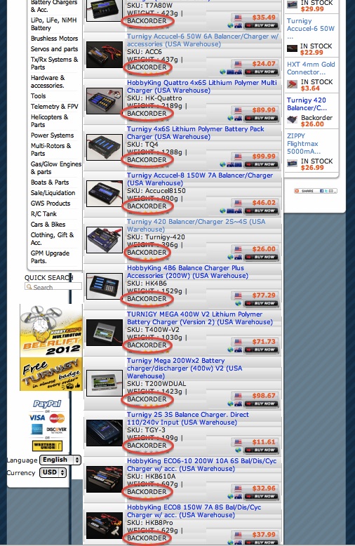

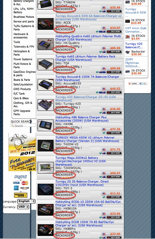

Argh
What an annoying site Hobbyking is! American flag freakin splashed all over the place, but it wouldn't let me place the order--scolding me for ordering from different warehouses?! Turns out, "global" is a warehouse unto itself. Now, if you are ordering connectors, then when hobbyking says they ship globally, they mean from any of their warehouses; but that's the only time globally means "wherever you are." If you select items from the "global," even if it says "us warehouse," then it won't let you add it to the basket. Global--US is not the same as US. Crazy. And everything in the cart must be from the same warehouse.
A poorly designed site. They bury the search field at the bottom of the page (don't think I've ever seen that at a PARTS DEALER, where, you know, people need to search for parts). And, they made me establish an account (addy, phone, whole nine yards), just to as a question.
To top things off, the US warehouse is out of every, single charger they carry. Seriously, a north american run on lipo chargers?! Really, look at the pic. Mental.
So, until their customer service gets back to me I can't order the items--and I'm not particularly hopeful, since none of their other "customer service" things are operational (spent an hour trying to generate a chat; no email addy). I could order everything from the German site, but then the $57US of parts is $80, which seems like an unreasonable cost hit just because the hobbyking hasn't the first idea how to design or maintain a website. If I have to fork over an extra $20, I'd rather it be to a company that didn't suck 3 hours out of my life with their crap site.
If anyone can recommend a NOT hobbyking site, that would be great. Otherwise, I'll probably be stuck with Amazon or ebay.

What do you expect? Hobby king is an electronics freak with a ton of stuff in his basement. It's not Amazon.com. This thread probably depleted his inventory.
I talked to customer service and at one point I told them that its a very poorly designed site and they should do something about it. They took it into consideration 😀 haha
Huh?
What is your evidence for this claim? He is an unusual "electronics freak," since he has warehouses in Germany, the US, Australia, and China. People on this thread have reported ordering from the US and the German warehouses. And a few domain names point to this site (hobbyking and hobbycity, that I know of). So, actually, like Amazon. More over, the stock quantity is not the problem (except regarding the charger I note); the problem is the site's failure to make clear (a) what they have and (b) what combinations are permissible in a single order.
Really maddening to have to scour the entire site for a few really common items.
So you managed telephone support? A us call? Maybe I'll give it a try. Prob a M-F/9-5 sort of thing, though.

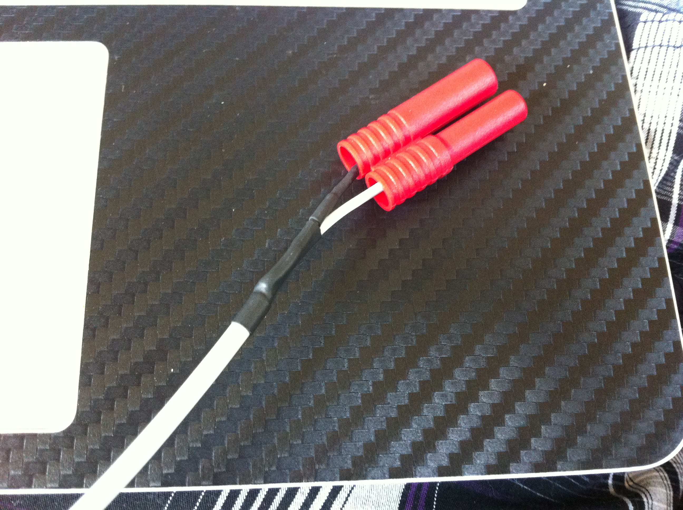

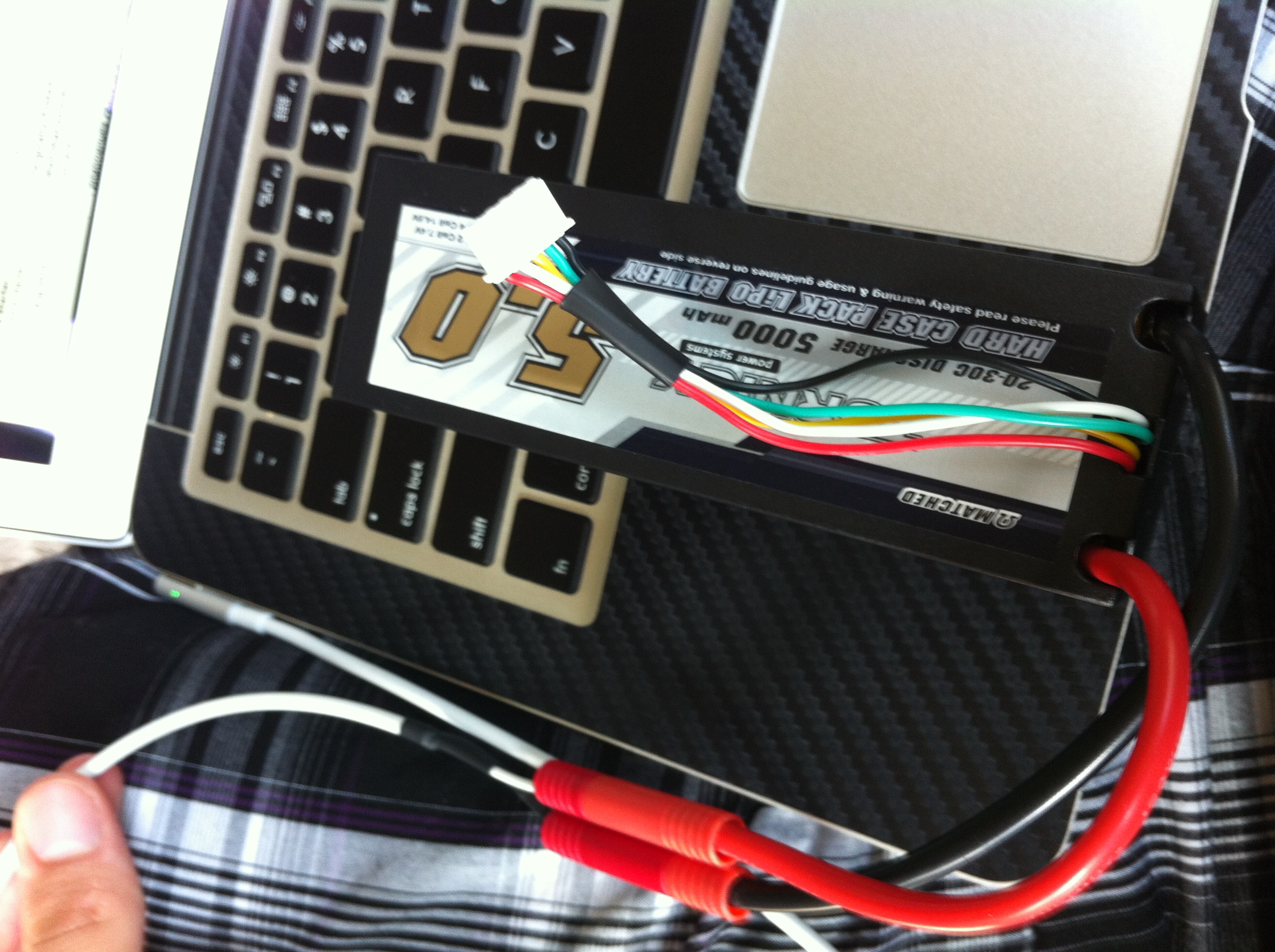

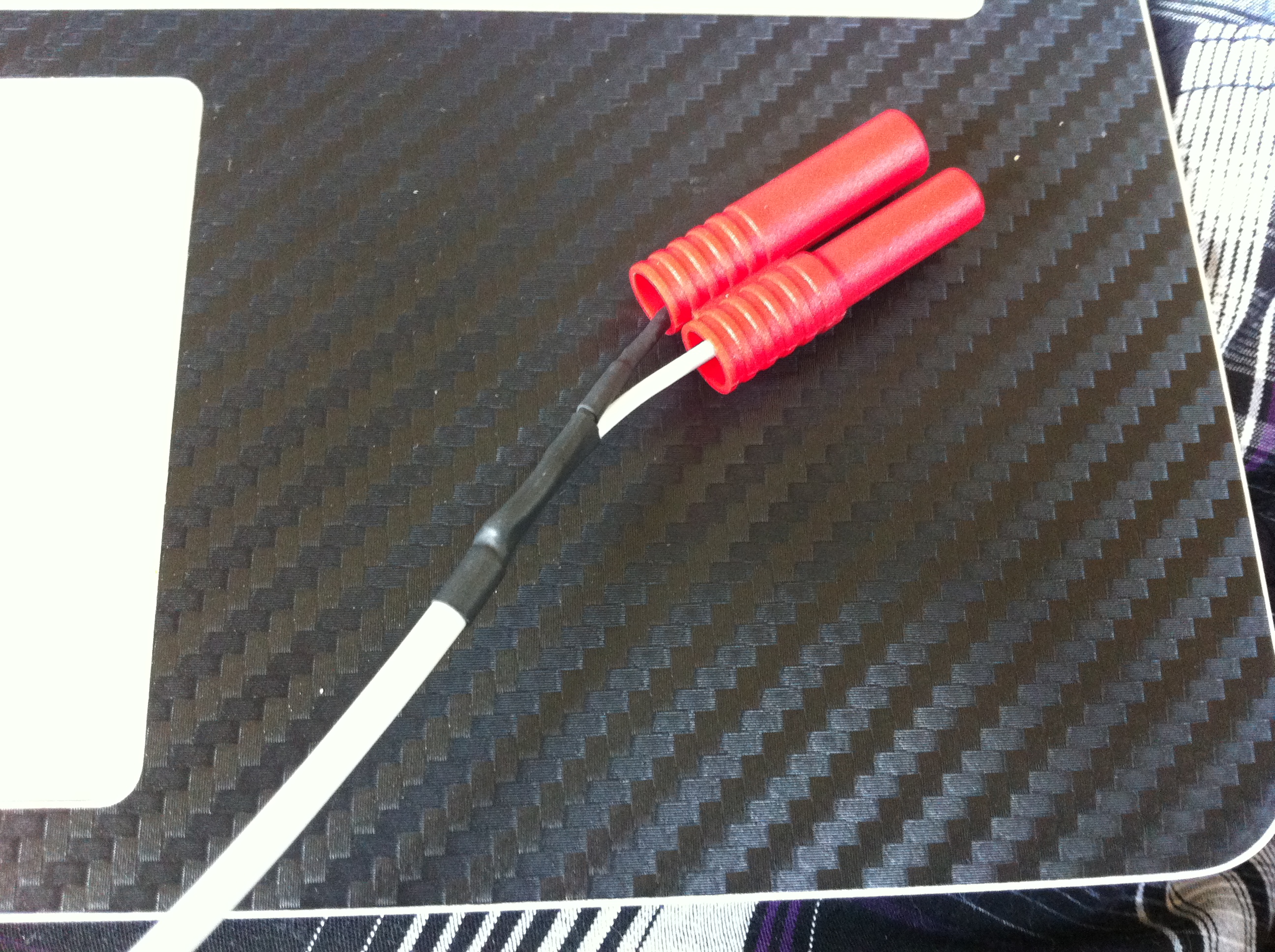

Well I finally got around to putting together my battery. It was quick and easy and works great so far! I have not tested out how long it lasts yet but I will eventually. Here are the picture of it. A little shrink wrap, solder and bullet connectors is all I used to put it all together.
I plan on also using a usb car charger wired to bullet connectors to use to charge my iPad. But I will get to that later.
I also purchased a voltage monitor for the battery but it turns out it doesn't have the power saving mode that it said it had so leaving it connected to the battery at all times is just a waste of juice. I am just using istat menu to get the batteries voltage.

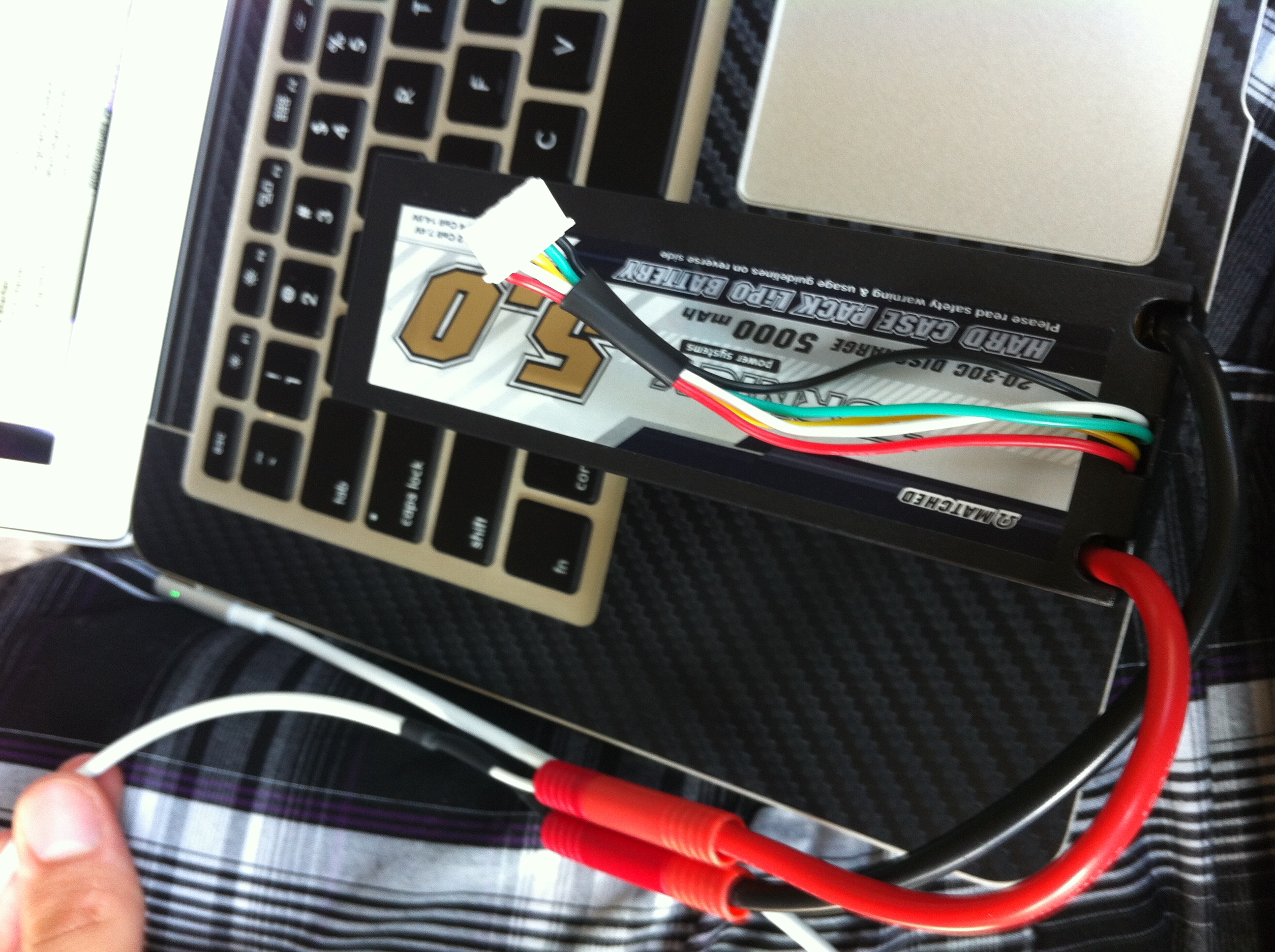

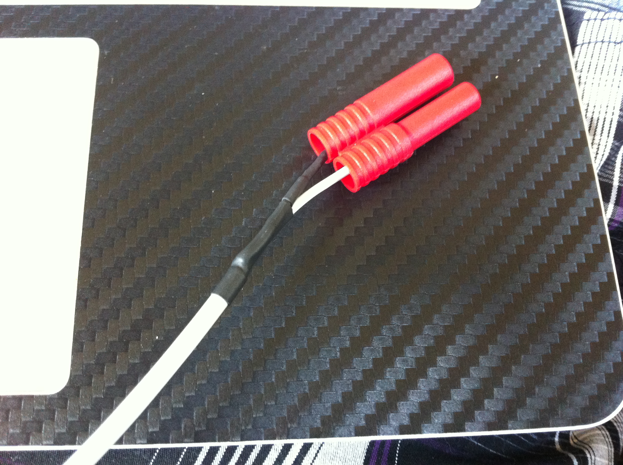

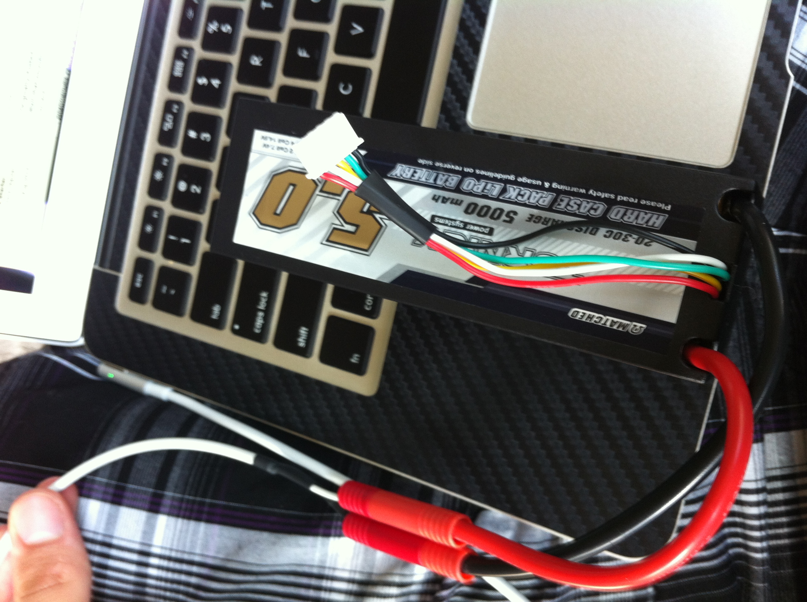

Nice! What size battery did you end up getting?
EDIT: Sorry, I see in the pic it says 5000 mAh 🙂
