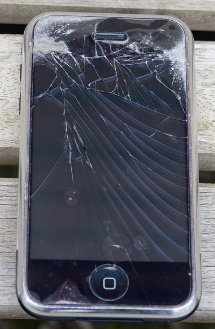

well i did it today! barely hit the ground and it looks like a car windshield from a 7 car collision! UGH.. i like you guys am stumped. I'm not paying 200 for a repair (or more) when i can get a newer model in a month.. just SUCKS! i do know that as soon as i have a replacement.. i'm going to see if i can follow some of these instructions and fix the front of this one so i'll have a backup.. please keep me posted on your progress. Or if I can't fix it i'd be glad to work something out for someone that wants parts .. this one is working wonderfully.just looks like crap.. i put tape over it to keep the SHARP SHARDS of glass out of my FACE.. thing about this.. this is my third iphone.. it was finally working correctly.. first one got so hot it just stopped working they replaced it.. 2nd one left the apple store and the home button didn't work.. so third was the charm.. also i bought mine when they first came out.. so it was full price until the rebate.. i'm soooo aggitated.. any ideas are GREATLY appreciated! thanks:confused::eek:

I replaced my screen with one of the glass pieces off ebay. It didn't go 100% smooth, but it works and looks good. Total cost ~$35. I used rubber cement to put the glass in place. Check out the broken iphone glass replacement post on my blog.

I Did It!
I got the glass off 100% without ANY damage to the digitizer. The key was using the above information and taking your time. I used:
a #1 light duty hobby knife scalpel- $3.49
and a Cheap glass cutter - $3.99
Some tips:
1 There is no need for solvents. The digitizer is completely glass so there was no worry about scratching the glass.
2 I closed off the vent to my office so it was much warmer in there and it made the glue much more pliable.
3 Think of it as one of those puzzles that is all mixed up and you need to move the parts around. Push the glass, DO NOT PRY any large pieces.
4 The glass cutter made a huge difference! Be careful to use multiple passes instead of pushing too hard.
5. Wear glasses. I got pelted about 30 times in the face with small shards of glass. Luckily nothing in my eye.
6. You can do it. Take your time. Every small shard is a win. On the outside edges push the glass towards the middle. NEVER pry it up inwards.

Follow up:
Using a hairdryer and a blade I managed to remove all of the glass without damaging the digitizer and LCD below.
Only problem is it fails to respond to inputs every now and again, can't slide to unlock it but it will work eventually. Strange

Thanks to everyone's suggestions I was able to remove my broken glass. I have tested the iphone with the new glass and it appears to be working fine, tried typing in notepad and in safari both horizontal and vertical without problems.
Here are some of my suggestions:
- Wear safety glasses, aside from all the debris my razor blade snapped off and hit me dead in the glasses.
- Firstly, if your glass is not shattered all over the place I would suggest doing this before starting the removal process. I didn't have too much luck with the glass cutter since you are supposed to score and 'fold' the glass, in this case bending the glass would be prying on the LCD which has to be avoided. I thought the scored glass would break easier under lateral stress but in my case I had no luck with this approach. So, since it is nearly impossible to remove large pieces of glass without damaging the lcd/digitizer I just carefully hit the glass with the other end of the tool (a steel ball). It is my belief that the LCD is more sensitive to stress applied while prying glass up then impact. While you still have all the glass intact you won't have to worry about missing with a scoring/striking tool and hitting an empty spot where the digitizer is exposed. Also, some stress will be distributed over the entire area as opposed to directly on an isolated piece of glass. It sounds risky to hit the iphone with something to crack the glass but as mentioned before, you can't remove large pieces of glass. I would definitely shatter mine more if I where to do it again.
- I tried a heat gun and ended up using a 'space heater'. If you have an extra hand to periodically hit the phone with a heatgun it might work but mine was too powerful and got too hot. With the space heater in place i turned it up to the point just where my hands could stand it and then would periodically move closer and further away from it. The glue definitively gives easier once heated but make sure not to overheat, if you smell anything funky cut back.
- I used a VERY MINIMAL amount of "Goof Off" because it's what I had laying around, can't speak for any other brands. I only used this as a last resort because my patience was running out, I tried to stay away from the edges , if you can completely stay away you have a chance of preserving a rubber gasket that keeps dust out.
- Changing directions of attack frequently is important. It helps in many ways... helps control patience, don't get too stuck on one good angle and keep pushing and pushing just to get the piece off because that is certainly what you will want to do; get in some work and then move on. Loosening the glue from all angles is good, and trying to rotate a piece of glass back and forth around an axis worked. You get pieces that crack off better this way, remember where you have the good angle and always come back to them, but don't stay in one spot.
- About how much stress the LCD/digitizer can handle. A handfull of times I saw some discoloration, the same color you see when reflecting the LCD into light at certain angles, hard to explain. Not a deep color, you don't want to be seing purple. What i'm saying is while I would be working a piece out, especially when trying to 'turn' the glass one stress spot would show some pressure, I tried my best to keep this to a minimal, I thought a couple of times I might of caused some damage but it turned out ok. So... you do have a little room to work with but if you try to pry you will start to immediately see deep discoloration in the LCD, that screams 'damage', so constantly keep your eyes out for feedback from the LCD and stay away from sensitive spots.
- Watch your the other part of your hand, you are so focused around your razor that it is easy to apply stress in other places sometimes.
- Take breaks, do whatever you do, smoke cigs, drink tea, watch TV, run... The more frustrated you get the greater the chances of breaking it...
- I don't think superheating the tool is worthwhile because most of the time your razor is pushing the broken pieces of glass, not the glue.
I have not glued the new piece of glass on yet because I need to buy some adhesive. I was considering the Loctite Stick N Seal mentioned above. I plan on applying it around the perimeter of the glass and the black parts, not on the whole LCD. I too mostly damaged the little rubber gasket that prevents dust from entering the LCD area. Anyone have any luck sealing their's back up without dust entering in between the LCD and glass?
Might have other suggestions later, tired now.
Here are pics, chronological, might help you?
