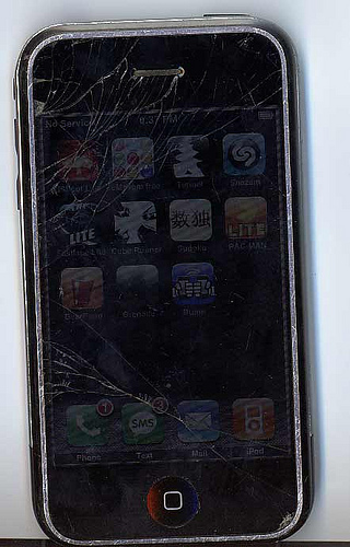

OK so here's my situation -
my digitizer is bad - outer protective screen is good - lcd is good.
the one million dollar question - can you remove the outer screen from the digitizer with out damaging the outer glass? -
then i have to remove the digitizer from the lcd?
ugh.. i found the digitizer piece on ebay for 10 bucks - called a repair tech i know and he said it is impossible and a scam -
what do you all think ? has anybody seen a thread that voices that it is actually possible? thanks!! this thread has been really helpful.

ok yall are trying the wrong thing . with the goo gone . you need a hair dryer to remove the glass from the digitizer. try that it is a lot easier than all that messy glue remover . good luck it should be easier
This is a great thread. I didn't read the entirety of every single post, but the most important part of this process (besides being extremely patient and careful) is making sure the gaps that are left around the touch screen are COMPLETELY SEALED. Personally, I use KWIK SEAL PLUS Kitchen and Bath Adhesive Caulk.
After your new touch screen has been glued back to the black framing around the LCD, your going to need to apply caulk around the small hairline cracks around the phones edge. It can be tricky completing this process without having glue you can feel around where the metal bezel touches the touchscreen. I would definitely advise leaving more on than trying to make it look perfect. If the cracks aren't filled with some sort of sealant, dust WILL accumulate under the touchscreen over time, making your iphone just look like hell when its not lit up.
This has been my experience. If anyone has perfected this method I'd greatly appreciate your method.
From personal experience, with trying to remove the LCD and not breaking the digitizer in the process, it is easier to buy the LCD and the digitizer together take apart the phone, remove the LCD and digitizer and replace both of them. It took me an hour to replace the LCD and digitizer while it took me over an hour to remove the LCD and then cracking the digitizer.
It is much easier than messing with the LCD and trying to remove that. I hope this helps out someone. You can get the LCD with the Digitizer on ebay for less than $20 and most of the time it comes with the screw driver and the sticky parts to put the phone back together. Here is a site that shows you how to take apart the phone and put it back together: www.directfix.com.
