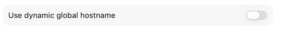

Is this option enabled or disabled under General -> Sharing -> Local hostname?

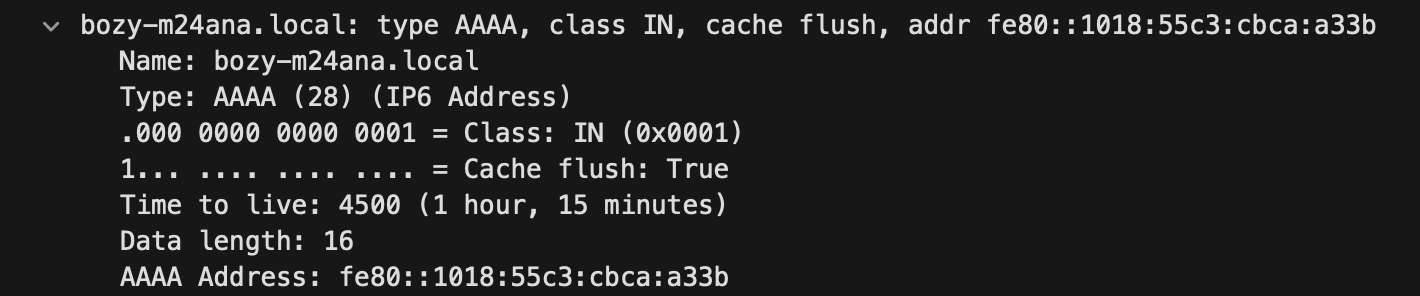

In my world, my OPNsense router's DHCP server gives my computer the domain's name (e.g. xyz.com). My computer then combines that name with its own local name (sven) to get a fully qualified name of the computer within the domain (sven.xyz.com). That combination is not used for mDNS/Bonjour. Only the name "sven" is used for Bonjour. My router doesn't know the name "sven".
It's hard to experiment much with this since System Settings seems to have acquired a bug that makes it hard to change my computer's name. But I did manage an experiment where I typed some random name into System Settings - "bozy m(24)". I used the space and parenthesis intentionally to see what happens. I then rebooted.
In the terminal.
% hostname
bozy-m24ana.xyz.com
% scutil --get LocalHostName
bozy-m24ana
% scutil --get ComputerName
bozy m(24)ana

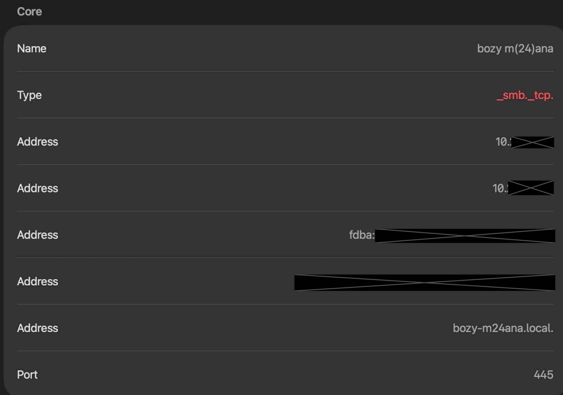

More interesting is how Bonjour uses this name. At no point is ".xyz.com" mentioned in any of the bonjour network traffic or various bonjour tools I have (e.g. the Flame app). It advertises various services under the full name with the space and parenthesis. But, in all cases the service is listed as being available at bozy-m24ana.local. Here's a screenshot from Wireshark showing my computer responding to a Bonjour query.
And a Flame screenshot looking at the smb Bonjour service my computer is offering:
Bonjour makes use of the friendly name (with spaces and parenthesis) in service advertisements. But in all cases, the address given to access the service is a bozy-m24ana.local.
