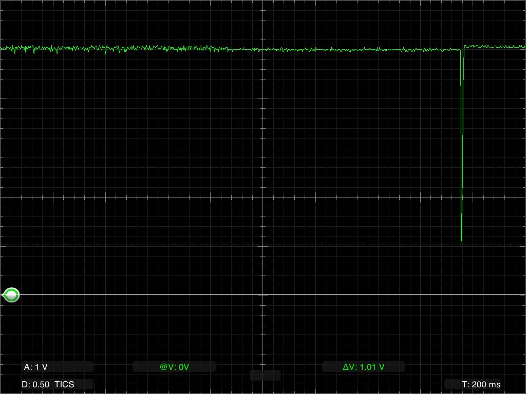

I tested Samsung 830 series 512GB SSD with Seagate TB desktop and Seagate portable TB adapter. With Seagate portable TB adapter you get always disconnects when the cable, adapter etc gets hot.
I did some measurements with scope on the 5VDC supply line of the SSD, it show a voltage drop from 5VDC down to 1VDC, exactly when the SSD disconnects and the error messages are shown.

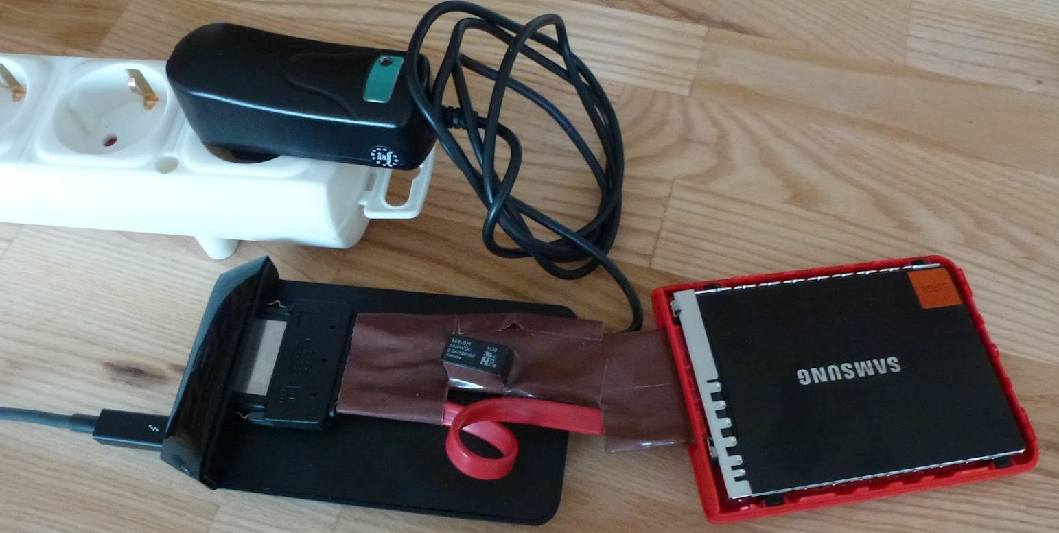

I have 2 solutions to overcome this issue, one is not to recommend, the other looks like this
As this is a rather complicated subject and the explanation is a couple of pages long, I have all detailed info with pictures on my blog.

I was able to make the connection much more stable using a fan and a lacie lbd with a better psu.
setup is mac mini- lacie t-bolt little big disk- seagate t-bolt all on top of a laptop cooler fan.
