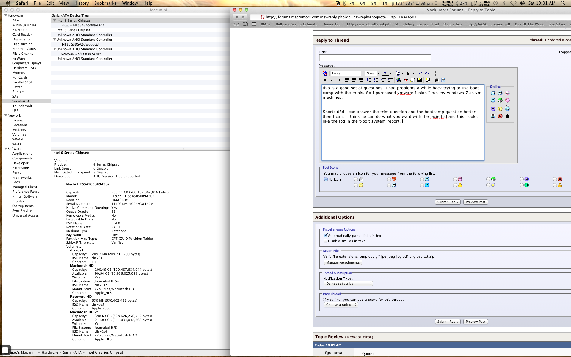

this is a good set of questions. I had problems a while back trying to use boot camp with the minis. So I purchased vmware fusion I run my windows 7 as vm machines.
Shortcut3d can answer the trim question and the bootcamp question better then I can. I think he can do what you want with the lacie lbd and this looks like the lbd in the t-bolt system report.
if you look at the thumbnail you can see the intel(int the lacie) the samsung (in the seagate)
I know that shortcut3d talked about loading drivers for the AHCI CONTROLLER this allowed him to do more features.

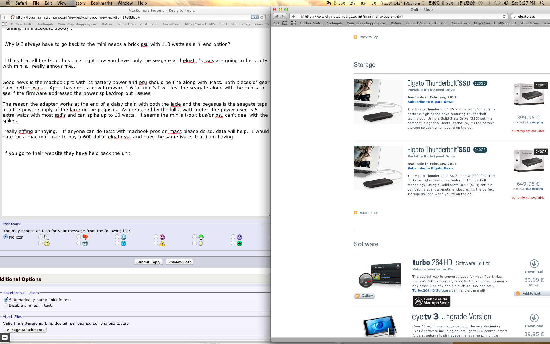

The jury is still out for the seagate.. I get random drop outs my feeling is the mac mini t-bolt jack is not that well regulated so wattage surges occur in the adapter.
If I use mini lacie seagate never drop out.
if I use mini pegasus seagate never drop out.
if I use mini seagate I get random dropouts..
a lot with the samsung 830.
the samsung 810 the samsung 800 are good no dropouts
the crucial m4 128gb had a few drop outs.
the crucial m4 64gb had no drop outs.
I am afraid to test the 600gb intel as it is 1000 ssd and i do not have a warranty on it.
also the seagate does not fire up any 3.5 inch hdds I attached. but it did drive a 320gb hitachi and a 500gb hitachi hdd with 0 drop outs.
The mac mini has a low grade psu.. I think iMacs will not have this problem but I don't have any iMacs on hand to test this theroy.

Why is it I always have to go back to the mini needs a brick psu with 110 watts as a hi end option?
I think that with all the t-bolt bus powered units right now, you have only the seagate and elgato 's ssds, are going to be spotty with mini's. really annoys me...
Good news is the macbook pro with its battery power and psu should be fine along with iMacs. Both pieces of gear have better psu's.. Apple has done a new firmware 1.6 for mini's I will test the seagate alone with the mini's to see if the firmware addressed the power spike/drop out issues.
The reason the adapter works at the end of a daisy chain with both the lacie and the pegasus is the seagate taps into the power supply of the lacie or the pegasus. As measured by the kill a watt meter. the power used is 5 extra watts with most ssd's and can spike up to 10 watts. it seems the mini's t-bolt bus/or psu can't deal with the spikes.
really eff'ing annoying. If anyone can do tests with macbook pros or imacs please do so. data will help. I would hate for a mac mini user to buy a 650 dollar elgato ssd and have the same issue. that i am having.
if you go to their website they have held back the unit. see thumbnail
my thoughts are they have had the same problem as the seagate. I am thinking that this t-bolt is not what i want as of today.
