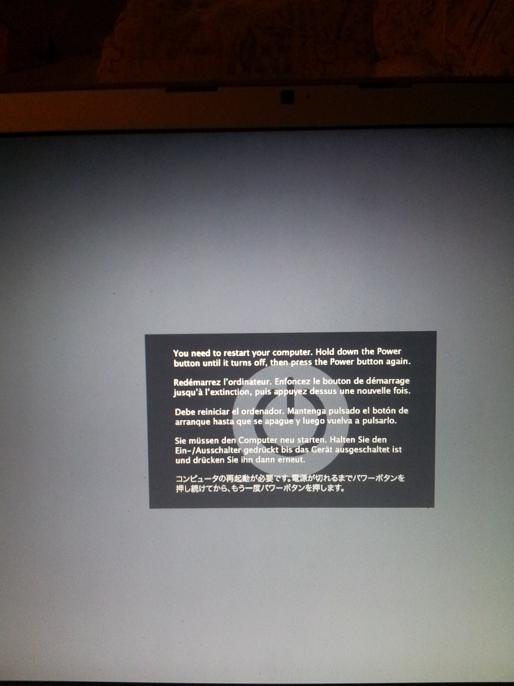

I did the reflow but didn't work. I now see the "keep finger on the on/off button" message like you can see on the attached photo. Did I have to also put thermal paste on the CPU too? When I took out the logic board the CPU didn't have any paste on so I bother didn't putting any.
Thermal paste must always be on the CPU. It does not take much to burn the CPU out without it.
