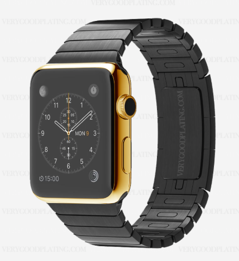

I successfully goldplated the applewatch!
You can gold plate the stainless steel link bracket too?
it is possible but not straight to the stainless steel - it wont stay on it. a common method is to do Woods nickel "preparation" at first. then inserting the object to the gold bath to plating it.

Does the coating wear off easily? Especially considering the Milanese mesh rubbing
Yes. Gold plate is very thin and temporary. Body oils dull that shiny finish pretty quickly, too. For something like a watch/band that you're wearing all day, every day, it's going to look pretty tacky pretty fast. Just sit back and wait a month or so before you jump on this bandwagon and see how many satisfied customers are still around.

Does plating the watch add any discernible thickness? I'd potentially be interested, but I think it's important to know this.
No, not at all. The layers of gold are measures in microns. You couldn't possibly notice.
