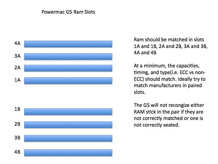

Rather than type it up, I decided to just throw together a diagram of the proper RAM installation in the G5.
The RAM slot designations are my own, and not anything official from Apple.
Thanks for the chart, I was actually a bit confused myself about where the RAM goes last time I had my G5 apart.
