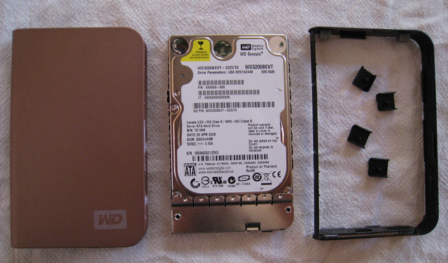

Buy a WD Passport Elite or Essential 320gb hard drive. They are around $100-$120 on eBay, at Best Buy, etc... The drives in Passport are the WD Scorpio WD3200BEVT.
Format the WD drive, GUID and and Mac Extended (journalized) settings. Clone your hard drive using Super Duper to the WD drive. Super Duper makes an exact copy of your hard drive.
Test that the computer can boot to the WD drive.
Remove the drive from the enclosure and replace it with old hard drive. Put the old hard drive in the enclosure and you now have a backup drive.
Power up the computer and you are good to go.

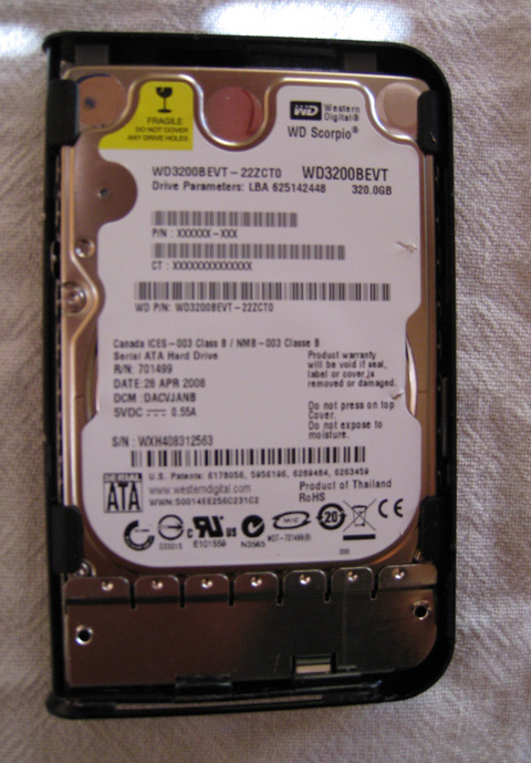

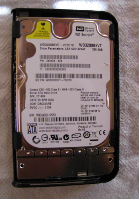

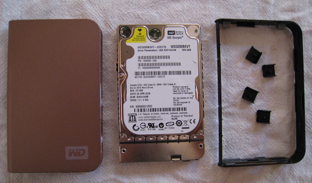

The WD 320gb is the same drive if you buy it with an enclosure or without one. The both have the same 8mb cache. This was confirmed when I took the drive out of the computer, and also when I called WD . All of there 320gb 5400 drives are one in the same. WD3200BEVT.
Thanks for that - it must have been the "smaller" Passport drives (160GB?) that have a small or no cache.

I bought the wd passport yesterday. After prying open the thing and nearly cutting my fingers trying to be gentle I find out it's not the scorpio. What the hell? My model number is WD3200BMVS so is this not the same what should I do??? Sucks!!!
I can't seem to find any info on this model number and don't know if it's the same as the scorpio. I do see that the manufacture date is July while that picture earlier was April. So you think it's comparable? Install it or return it?

Google seems to think it has a 8MB cache so specs seem the same as the BEVT model.

I couldn't find that model doing a search either. What model Passport was this in? Both of mine are the Passport Elite, and they are Scorpio.
As long as it is a 2.5", SATA drive, it will work.

I bought the passport essential not the elite. Is that why but I thought that guy said it's in both.
Yeah I'm sure it will work but wanted the scorpio since the reviews on it are so good you know. Pretty bummed and fingers numb haha.
Yeah I have it out. It's the same exact as the pic about but the model number is WD3200BMVS
The only 2.5" 320gb drive they make is the Scorpio. So I doubt it would be anything other than that. The guy I talked to at WD told me that ALL Passports have a Scorpio drive in them
