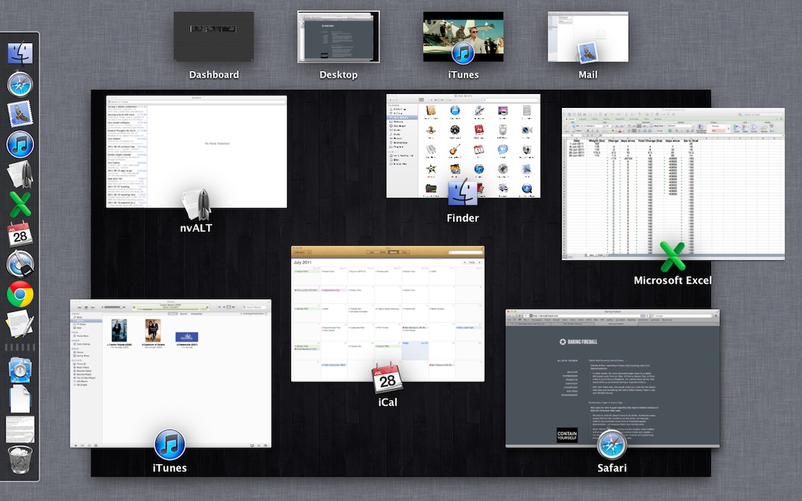

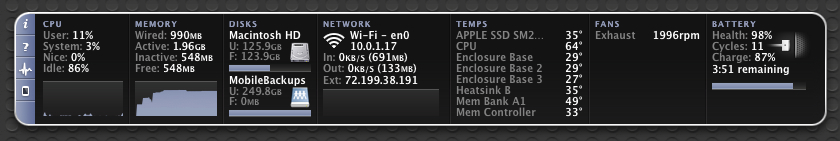

I've attached two screenshots. One is of mission control with these apps running: nvALT, Mail, Casino Royale HD, Excel, Safari with 3 tabs, iCal, and a Finder window. The other is the iStats with those apps running.
If you're wondering, I have the 2011 13" MBA Core i7 with Samsung SSD and display. Hope this helps.
64C is impressive with those app's running, my i7 I'm sure ran hotter doing similar tasks, maybe it was defective?
