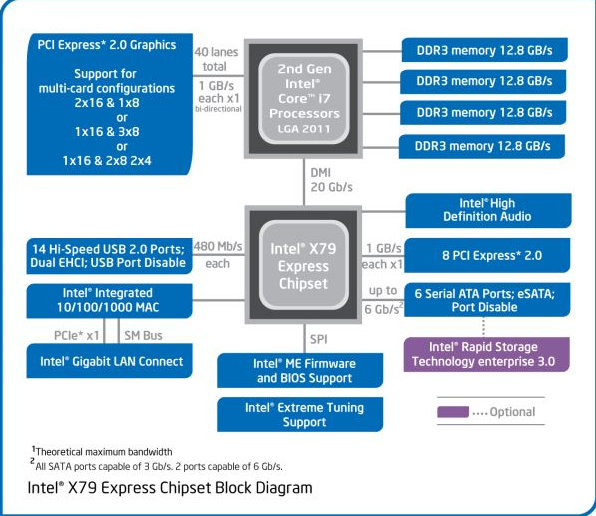

Doesn't the Xeon support 3 extra PCI-E lanes 40 vs 37??

All socket 2011 support 40 lanes..

The 2011 sockets support 40 lanes but they also support 2 QPI links also. However, some like the 1600 series don't have the 2 QPI links enabled. It is more than just what the socket supports. It is what Intel has switched on in the product.
