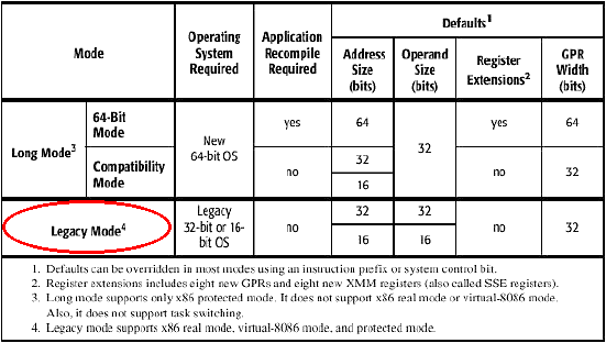

I have provided a hard evidence link, by deduced reasoning emphasised this evidence and still you don't get it? I even wanted to point out to you the K7 and K8 cores, but since you do it yourself I am absolutely baffled that you keep persisting that the K8 is a derivative of the K7. THE K8 IS A FREAKING NEW DESIGN! You better admit I am right. That would be less an embaressment than how you portrait yourself now. I at least know when I am wrong (The playstation example).

Of which your own sentence is a wonderfull example. You incorrectly identify my baseline material, so your conclusion is wrong. My baseline material is not the EXAMPLE of 64bit-x86 (which is even correct), but my baseline material lies at the heart of logic and is:
If an entity is a derivative of another entity does not mean that those entities provide the same behaviour.
Or in this context:
That Cell is based on PPC architecture does not mean that it can run PPC code.
Except you're wrong now, the K8 design is based off of the K7 design, heavily modified, sure, but not an entirely new design.
