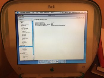

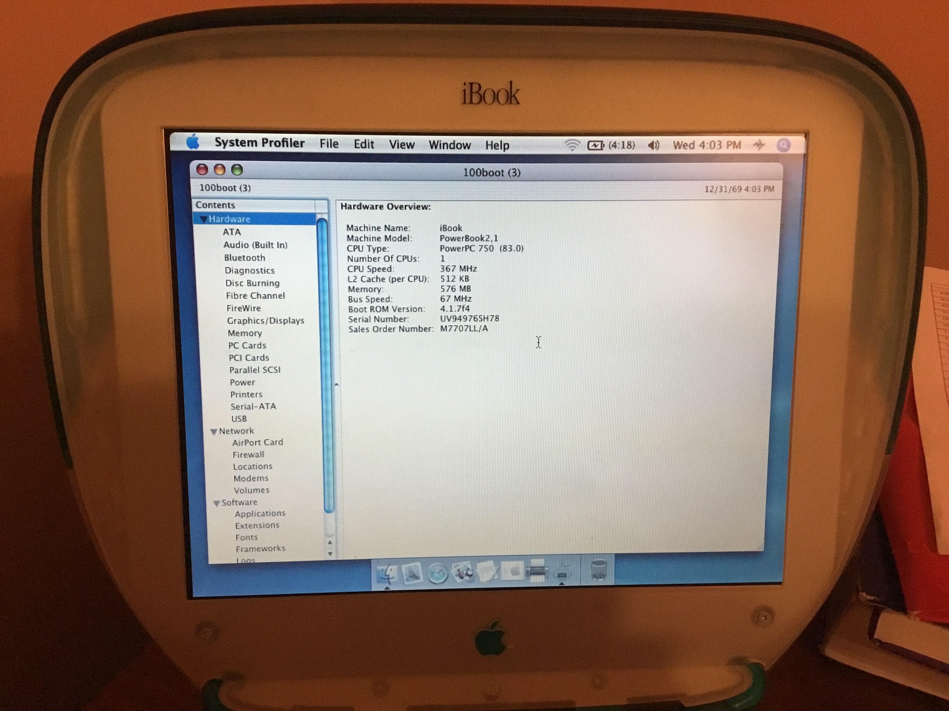

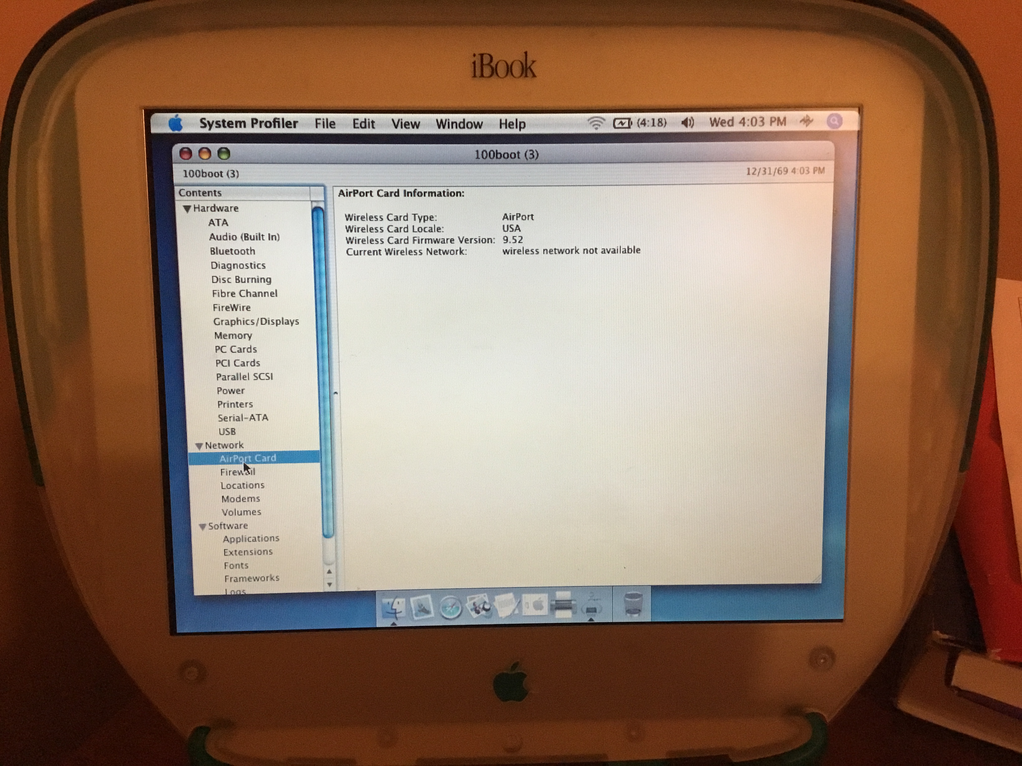

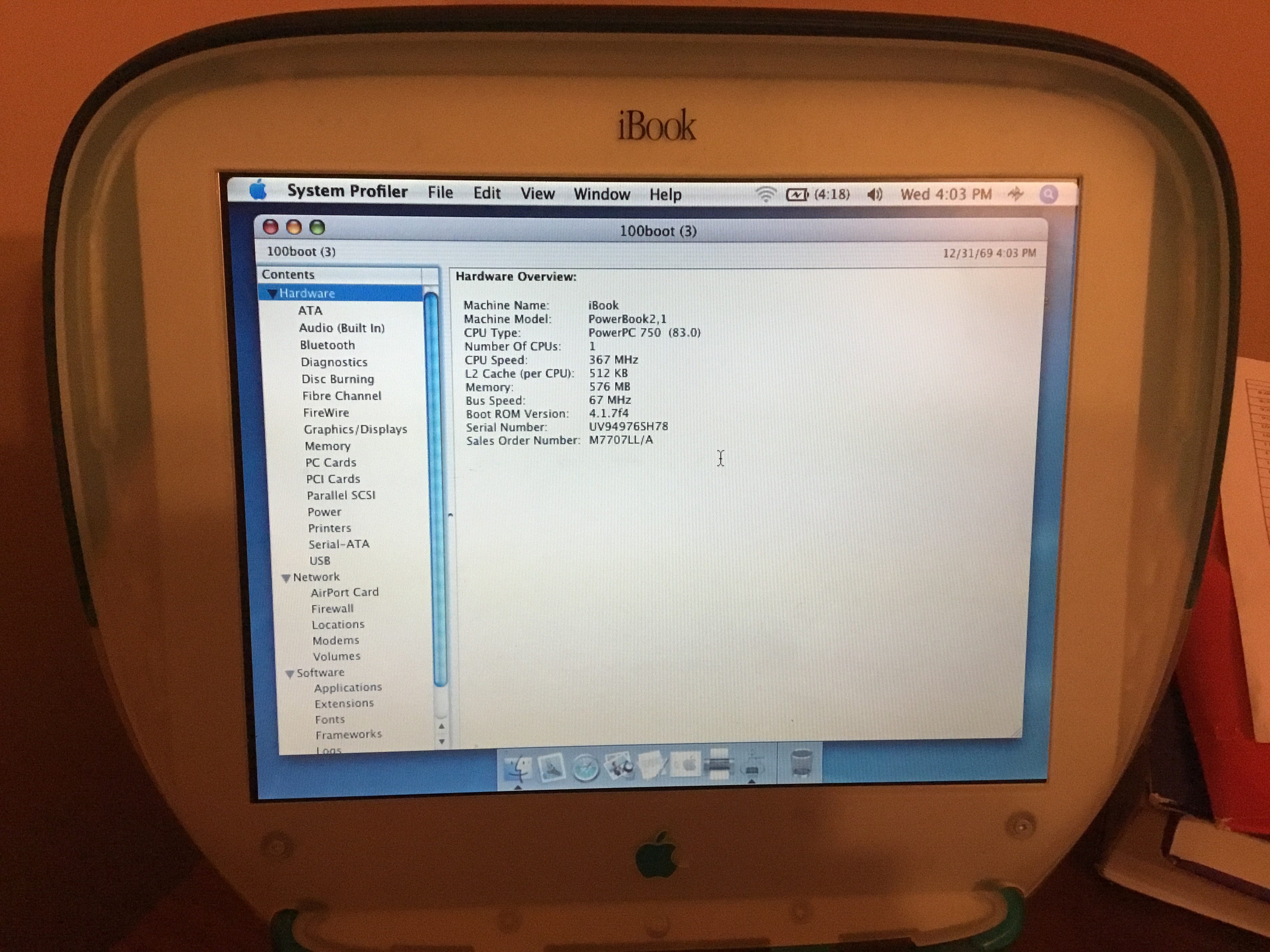

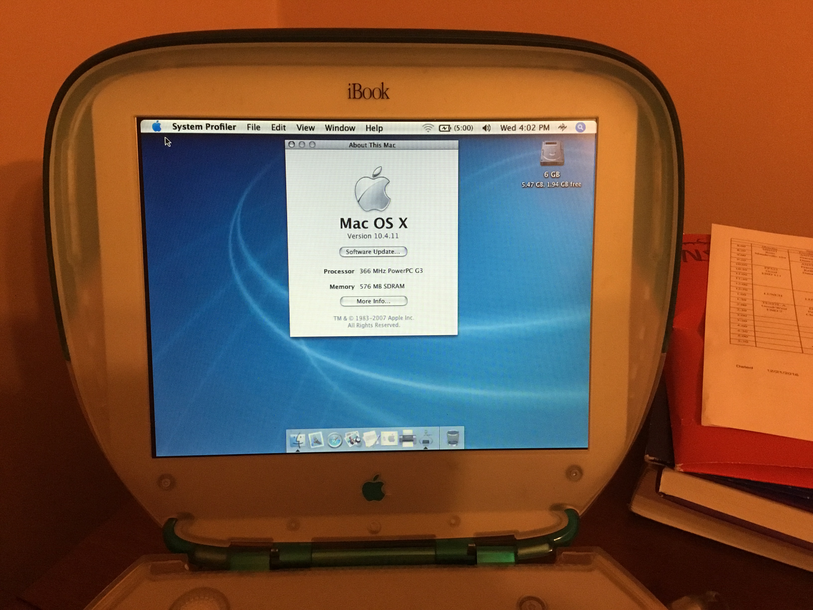

Hey Everyone,
I'm sure you all think I'm crazy, but I have a question. I purchased this old iBook clamshell about a year ago on eBay, jus to screw around with. I attached the specs here in pictures. Is there ANY way to get this a functional laptop of just going go the internet and fooling around with for fun? It currently does not connect to my wifi at my house. Anyone know?
The wifi is an Airport card - the old type which is 802.11b
It will refuse to connect to a WPA or WPA2-protected wireless network, which is not supported on that Airport card.
You would be successful if you change the protection to WEP (but I wouldn't recommend doing that)
You COULD turn off protection, and that would work with the old Airport card (but I wouldn't recommend that, either 😀 )
If you must try to connect wirelessly with the Airport card, you could setup a network that uses the MAC address of the card, to selectively allow individual cards to connect - ignoring other cards.
Or, use a supported USB wifi adapter - but the USB 1.1 would restrict your speed, too.
Best effort for an internet connection on your clamshell would be ethernet.

I hear you. But I do not know what any of that means actually LOL. What I mean is, is there a way to put a modern Wi-Fi card in? Or is it not really worth doing that because the browser so old, etc.?

Not easily at all. In addition, as you mentioned, the browser situation on Tiger is pretty bleak at this point, especially on a low-end G3. BTW, this question would be better posed to the PowerPC forum.

Mac OS X 10.3.9 with the AirPort 4.2 update (and Tiger and above of course) will connect to WPA-protected networks. The old AirPort cards can be a bit hit-and-miss with modern routers, try setting up a network that is WPA (not WPA2), b/g 54mbps only (not n), and 2.4 GHz only (not 5 Ghz) - my clamshells work with those settings but routers do vary.
Great, that you've maxed-out RAM. An mSATA-upgrade would be awesome but tricky.
Your iBook should be able to run Tiger. Then you'll have the option to run webkit4Tiger or even TenFourFox, which is not as fast.
There's a tiny Edimax-WLAN-USB-stick and drivers/software for Tiger to get access to the latest WLAN-encryption, but speed is limited to USB1. https://forums.macrumors.com/threads/granites-ibook-g3-clamshells.1747559/page-8#post-22145536
