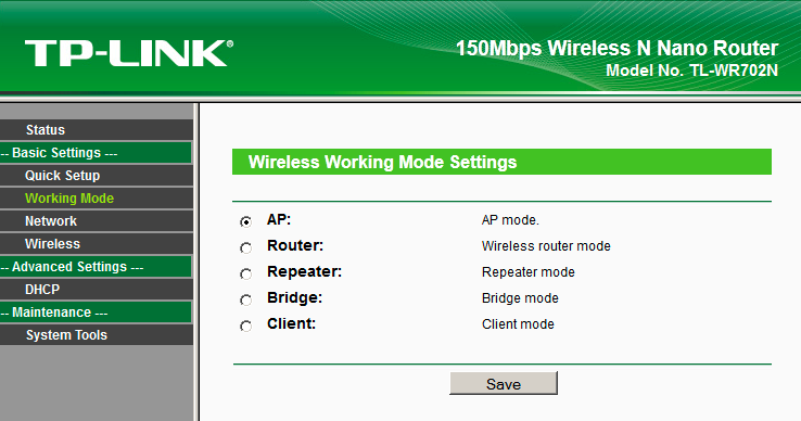

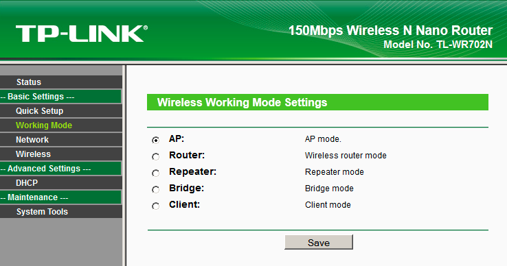

On the web surface one can change the working mode. You may want to set it as repeater or client. As client it serves as only a receiver, as repeater it serves as receiver and boosts your wifi at the same time, although i found the latter to be unstable and sometimes not working. It boosted an empty signal 😀 the menubar showed full signal, the network helper program said 'everythings alright' but I had no internet.
Use it as client and be happy 🙂

EDIT: forgot to mention: setting it up as a client is very easy, select your wifi, enter password, connect, restart and violà

From your Imac or Clamshell Plug the ethernet Cable into the Lan port on the Tp-Link and the ethernet port on one of the devices then go to a web browser and type in 192.168.0.254. You should be presented with a login window the username and password are both admin. Then Follow previous post to set up. Remember you will need to know your other router's SSID and Password.
***you Could also type in http://tplinkwifi.net instead of 192.168.0.254 but it can be more hit or miss then typing in the ip address of the router***
