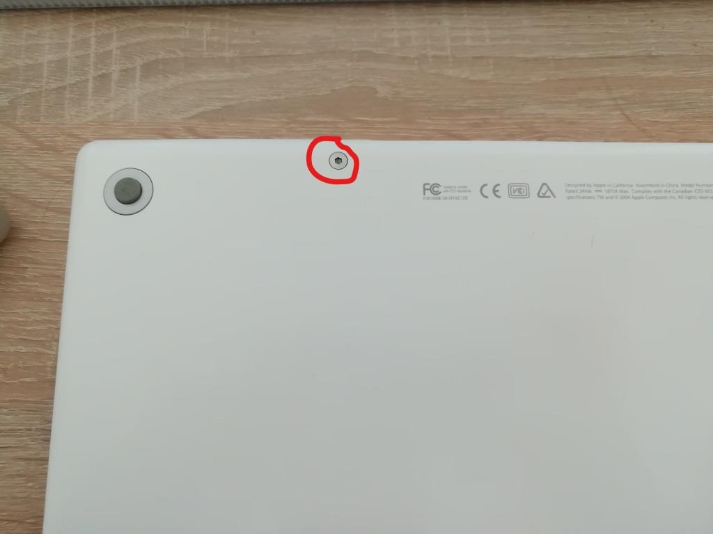

Could you send a picture of the iBooks bottom and mark the screw, which is causing the problem?
I've opened several iBooks yet but didn't encounter such a problem. But you are right, it's a hassle to open them ...

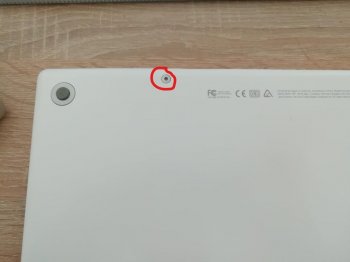

This is the bad one

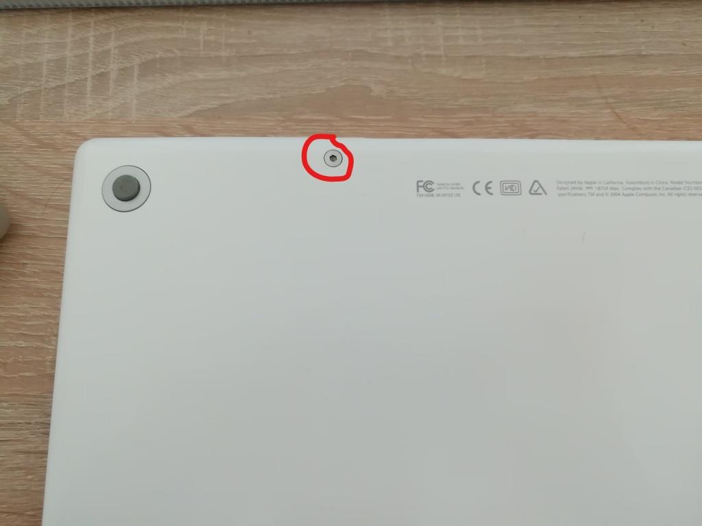

This is the bad one

You should be able to open the iBook.
Follow the steps on iFixit.
That screw sit a the location close to the display, where the bottom has to be released as the final step.
Obviously the screws thread is damaged and it should come out of its counterpart as soon as you lift the bottom.
If you are lucky, the corresponding nut is still ok - otherwise you may leave out that screw, when reassembling the iBook.
You may try a strong magnet on that screw before or maybe solder another screw on to to it that can be used as a handle to tear the screw out of its hole...
