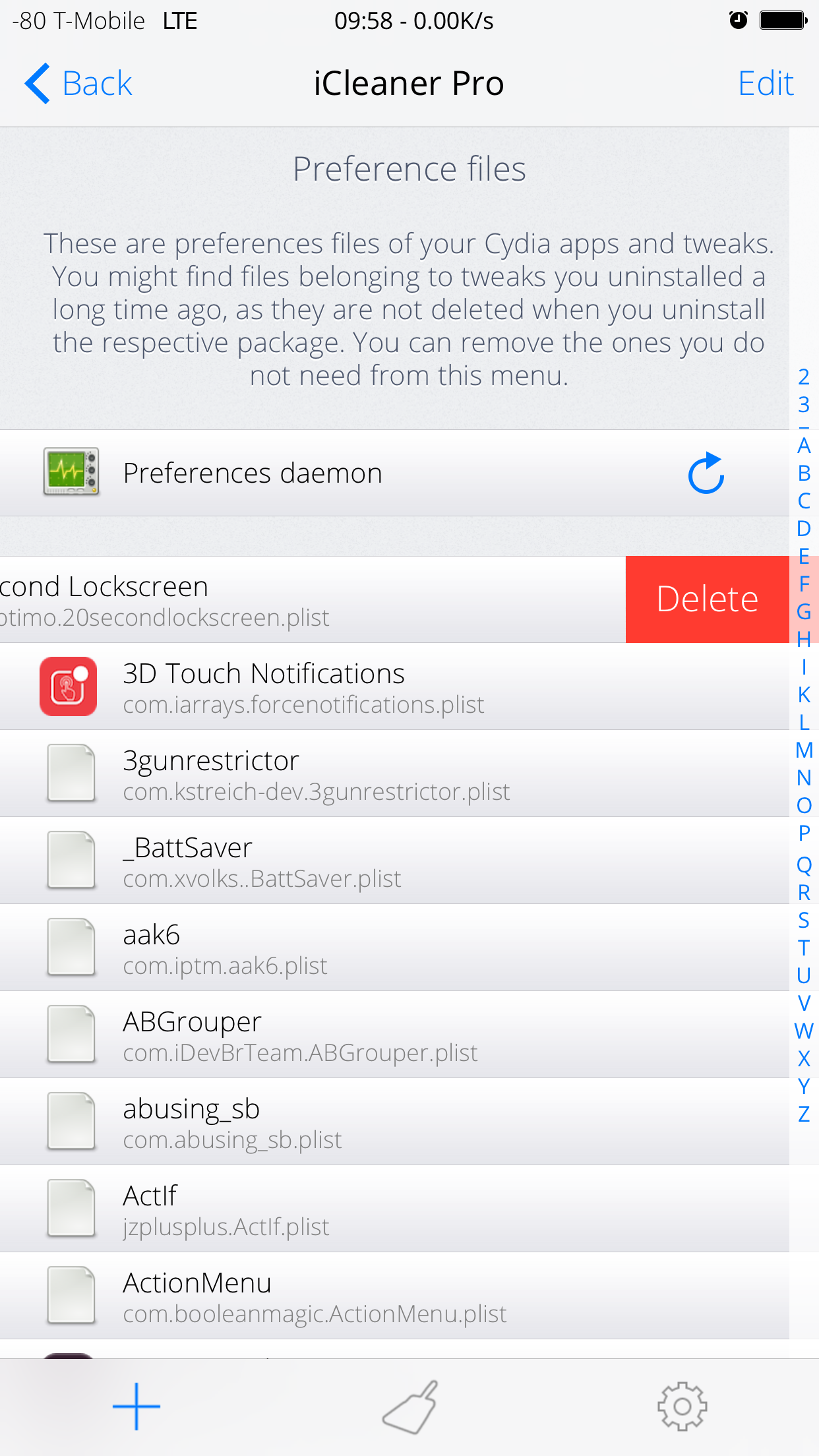

I have to disagree.
iCleaner Pro's ability to disable tweaks and delete preference files has saved my jailbreak more than once.
Cleaning cache files seems to be what it's become known for - and people overuse that function. It's supposed to be an occasional thing when you are having some issues, not a periodic maintence program.
Without iCleaner Pro there would have been several times I would have had to uninstall MANY tweaks just to find the ONE that was causing issues. Not a reality I wish to think about as I have about 200 tweaks installed.

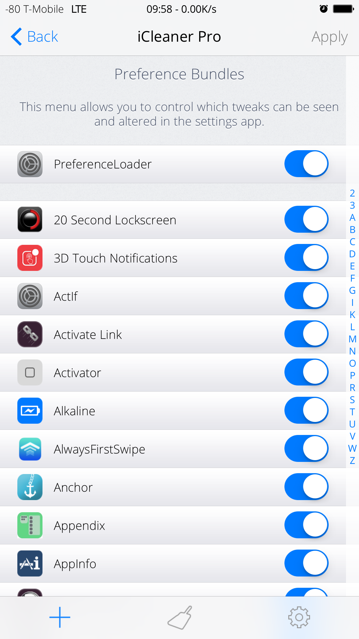

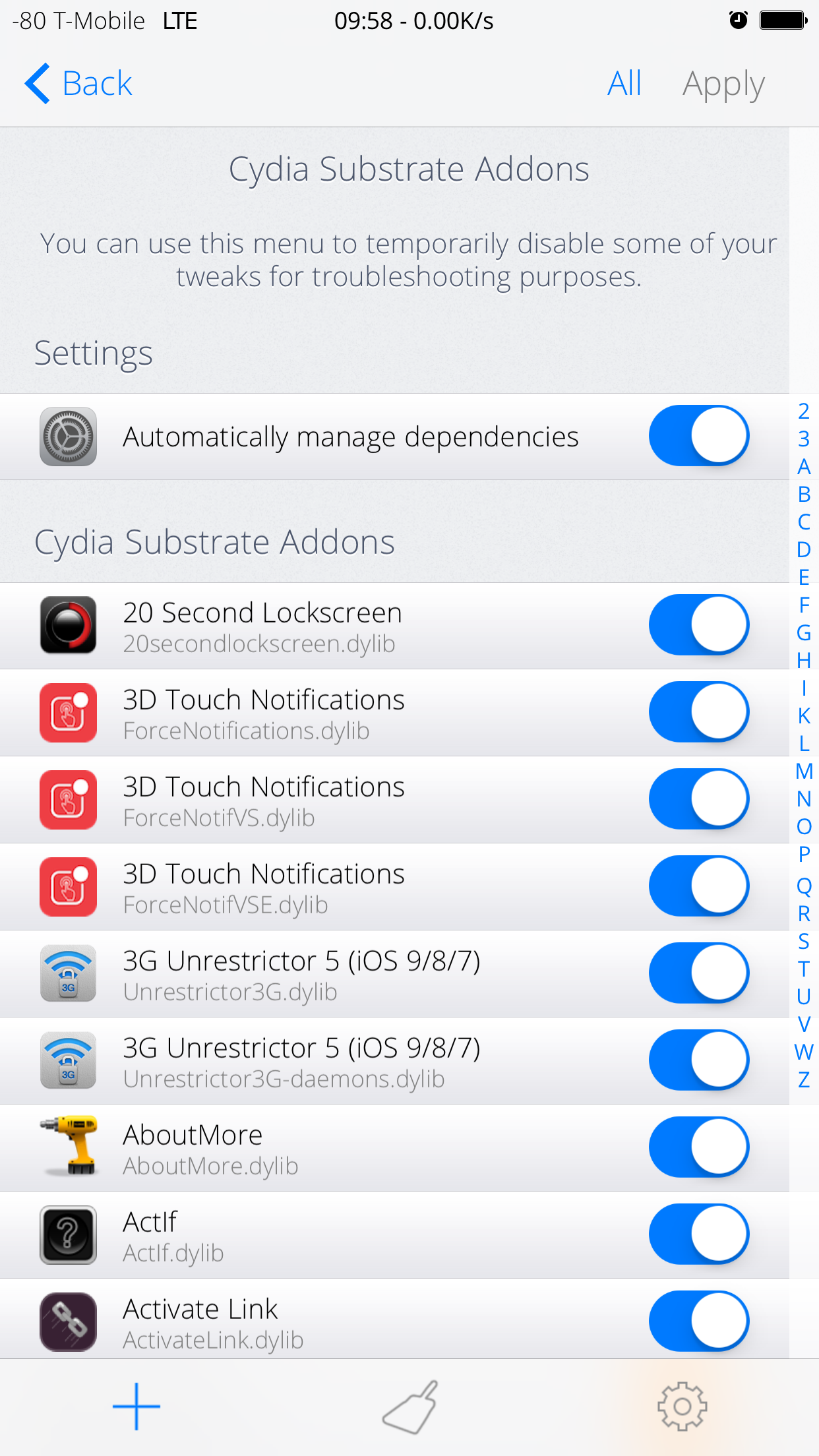

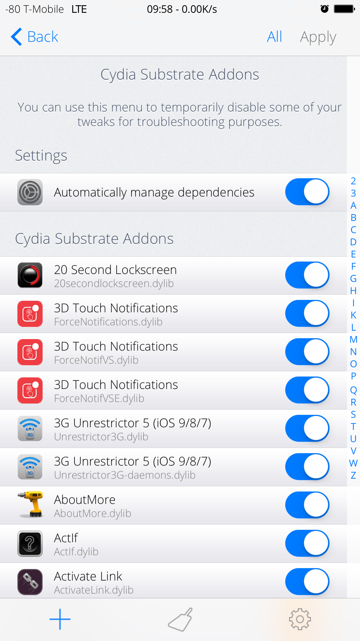

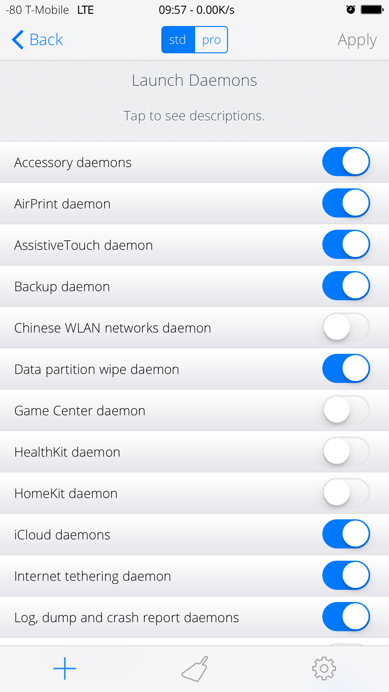

You can disable tweaks with it?...I didn't know that. But it still doesn't change my mind.
If you have had benefits from it, more power to you...I won't touch it again.

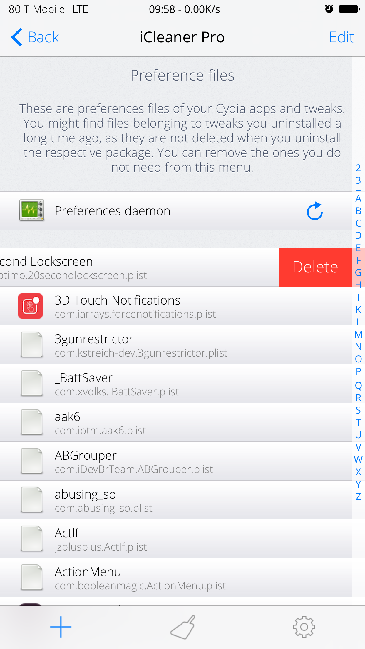

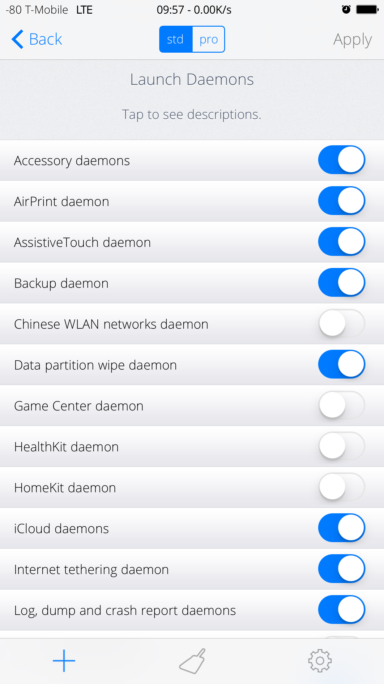

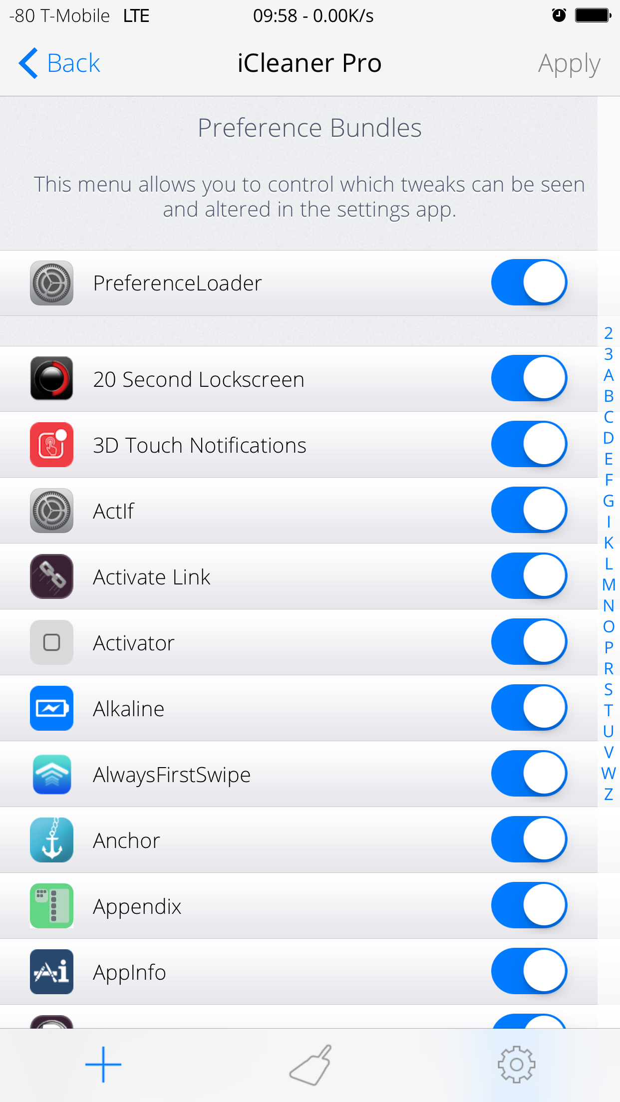

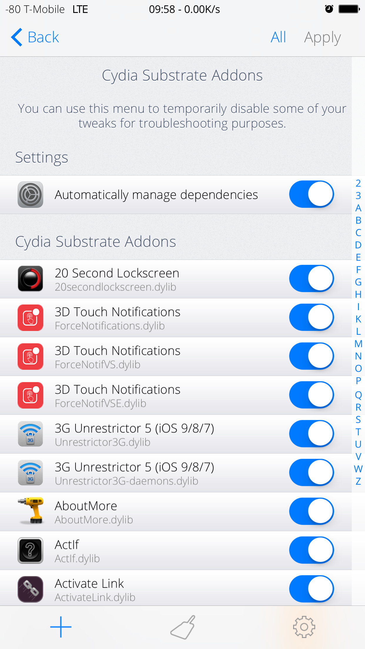

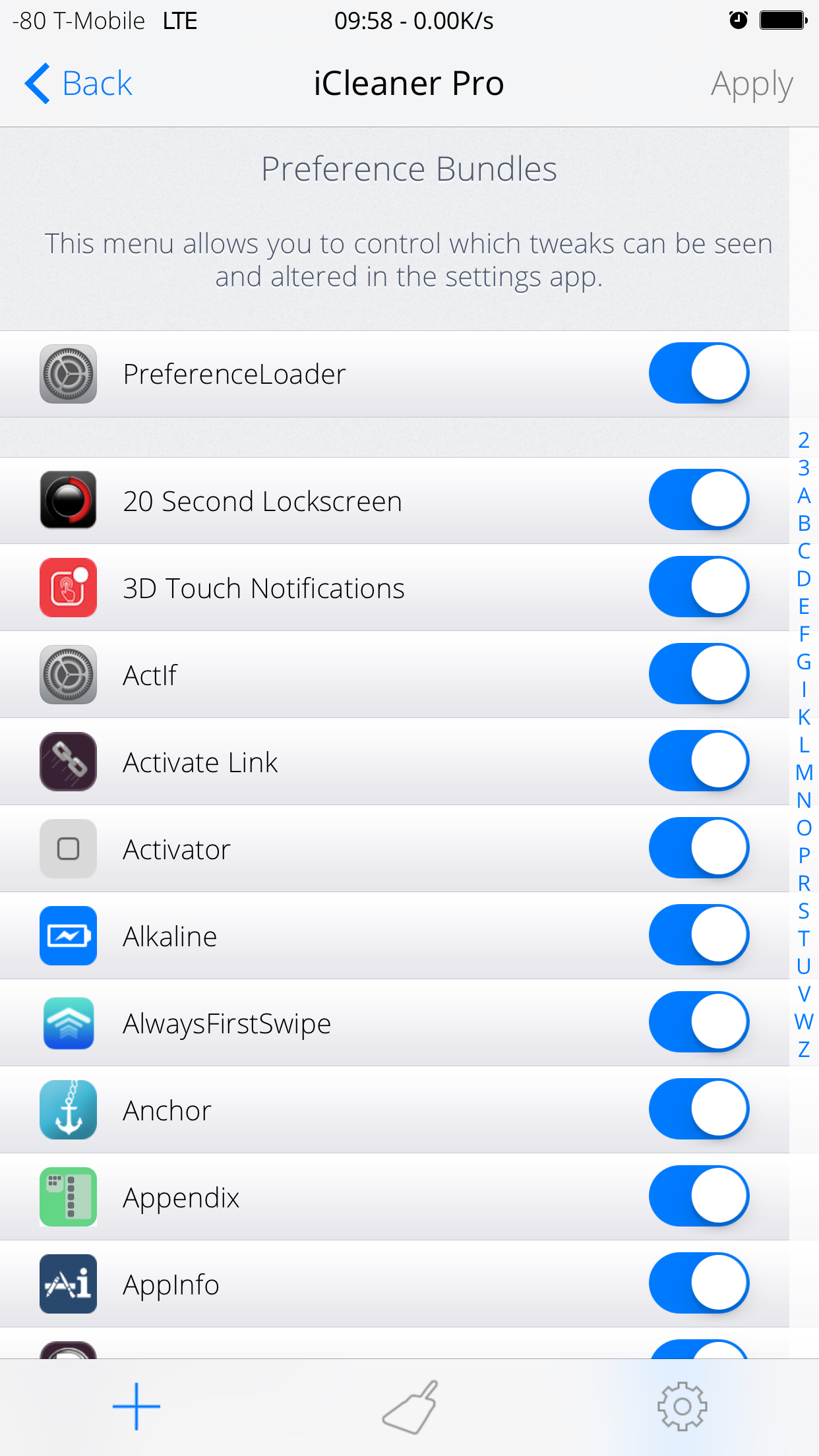

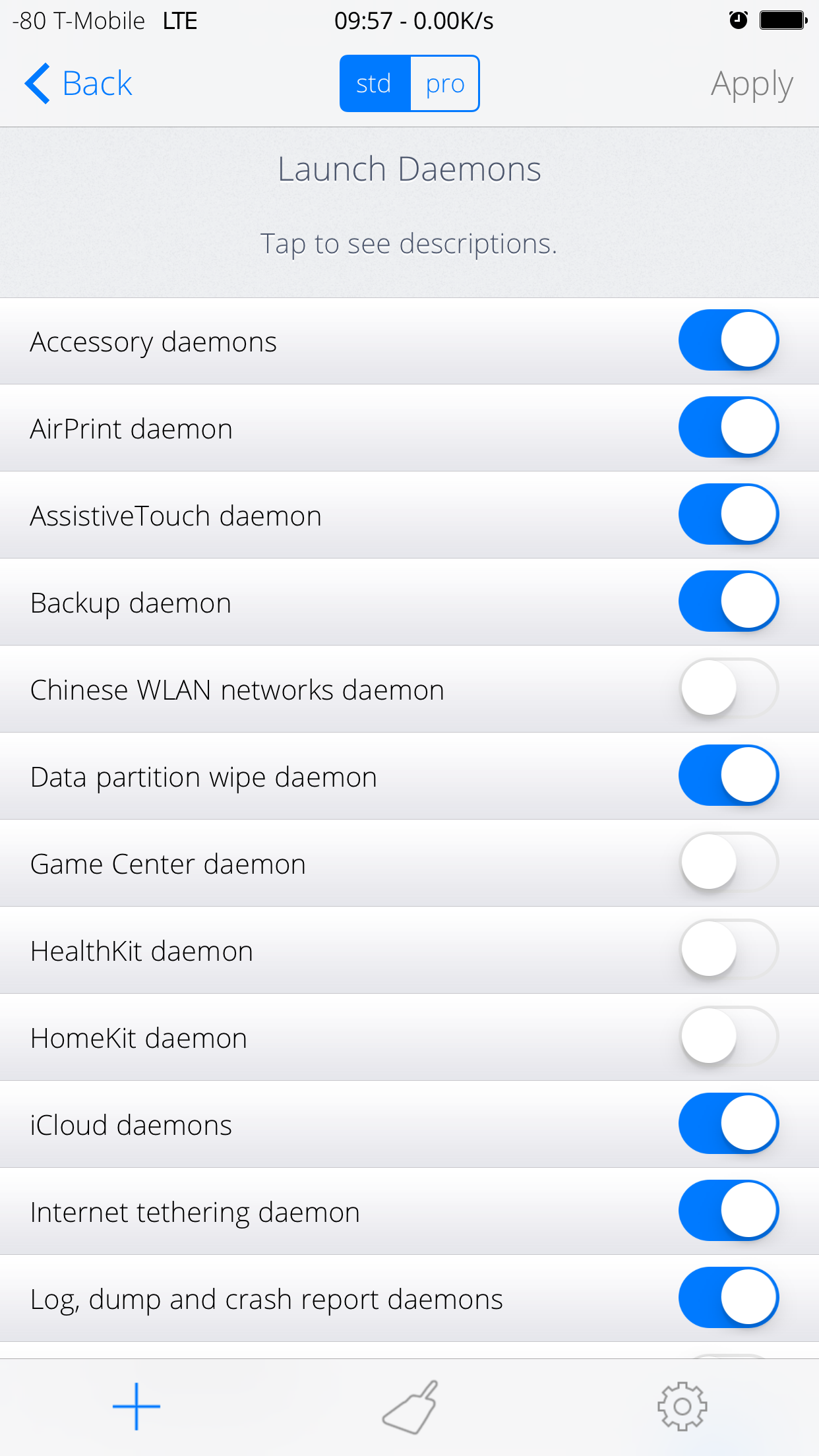

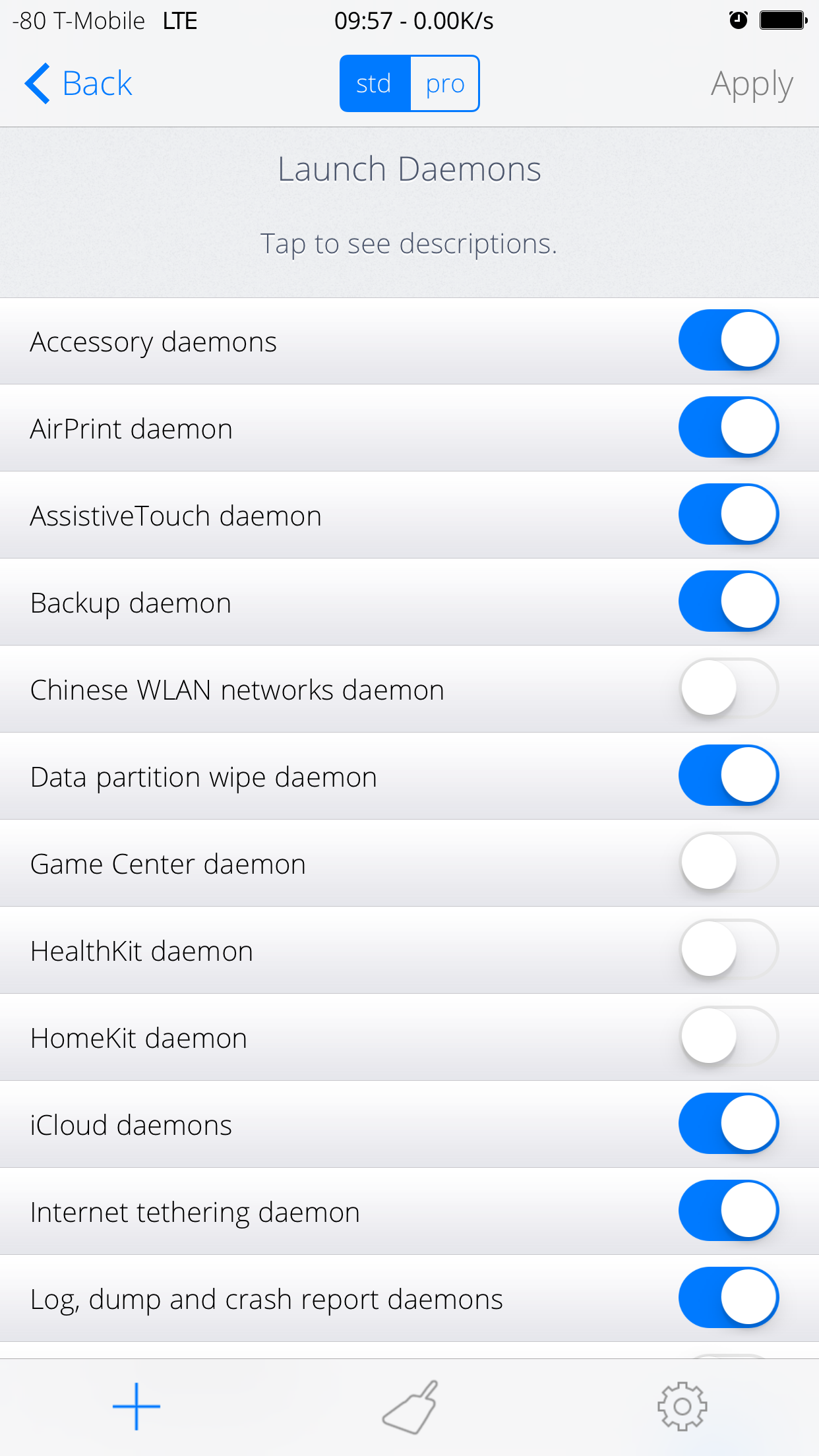

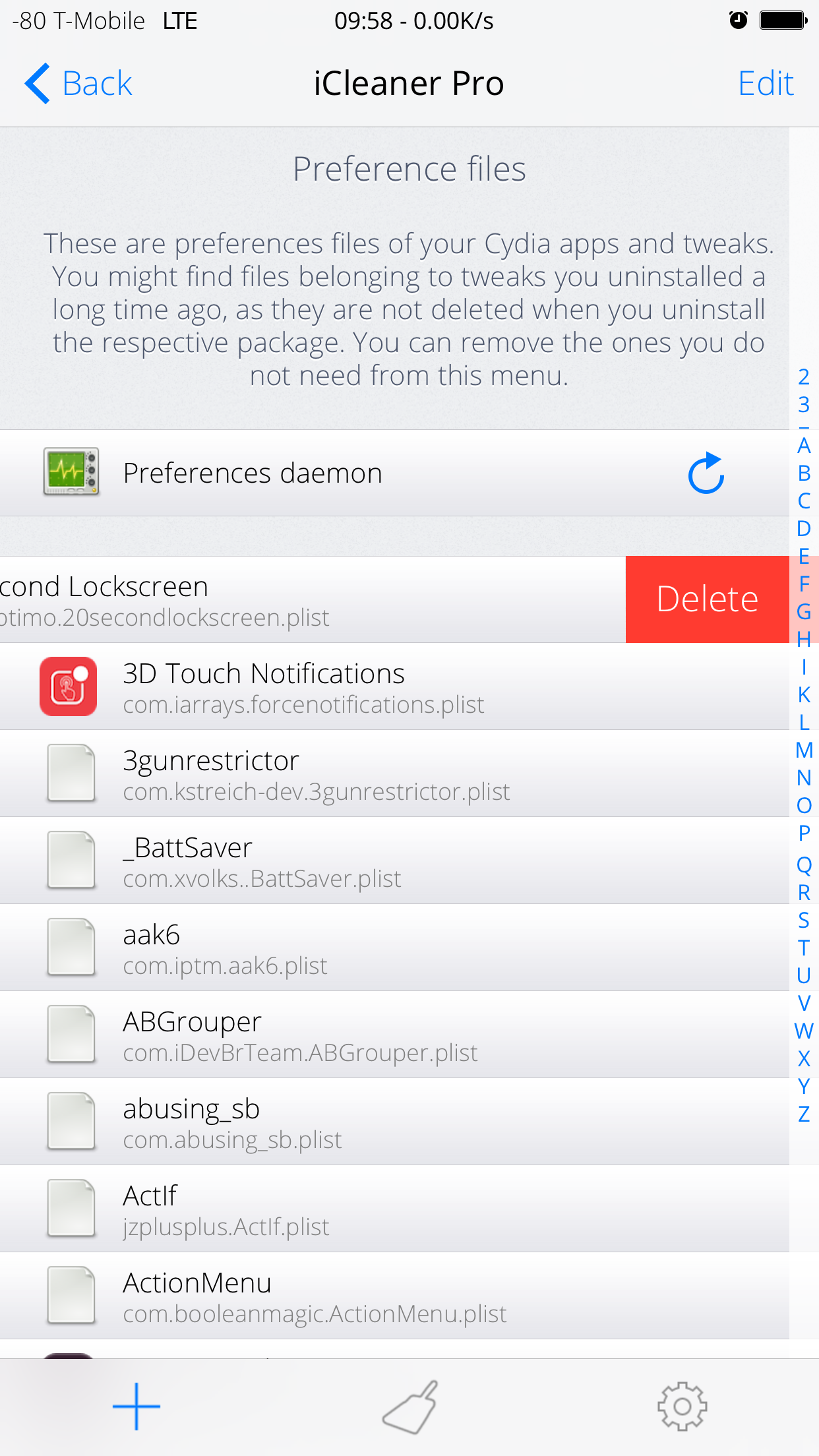

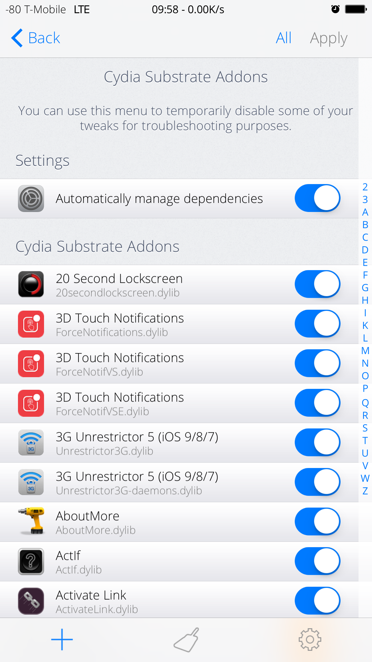

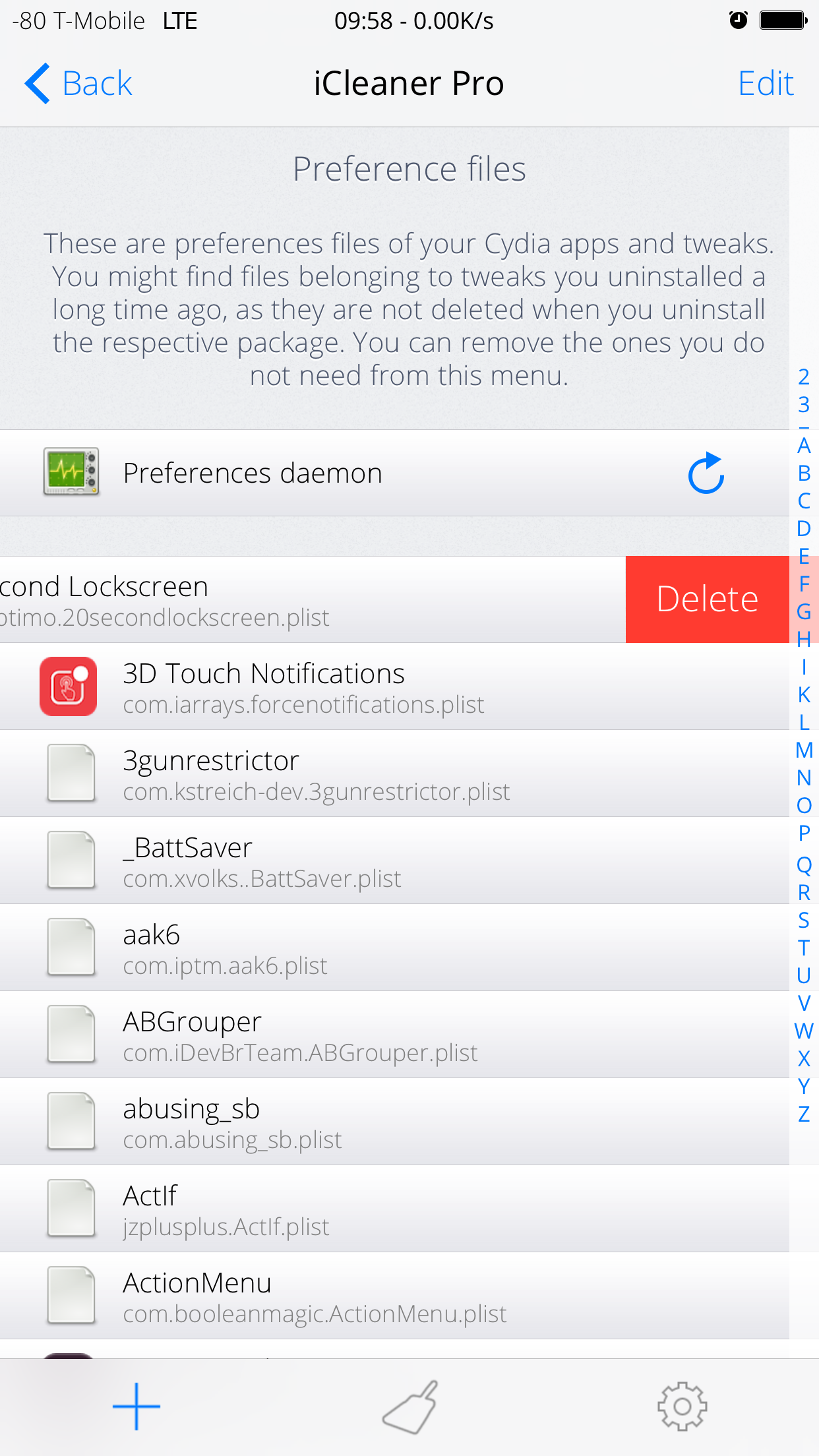

Yes. You can also disable launch daemons and preference bundles.
2016-11-05 09.57.55.png 2016-11-05 09.58.18.png 2016-11-05 09.58.25.png 2016-11-05 09.58.35.png
I understand your refusal to use it. I'm not trying to convince anyone that it's a panacea to all problems. Just defending a bad rap it's gotten.
That said, many people don't realize that there is iCleaner and iCleaner Pro. I use iCleaner Pro. It's the extra abilities that I mention that the Pro version offers.
View attachment 670445 View attachment 670446 View attachment 670447 View attachment 670448
