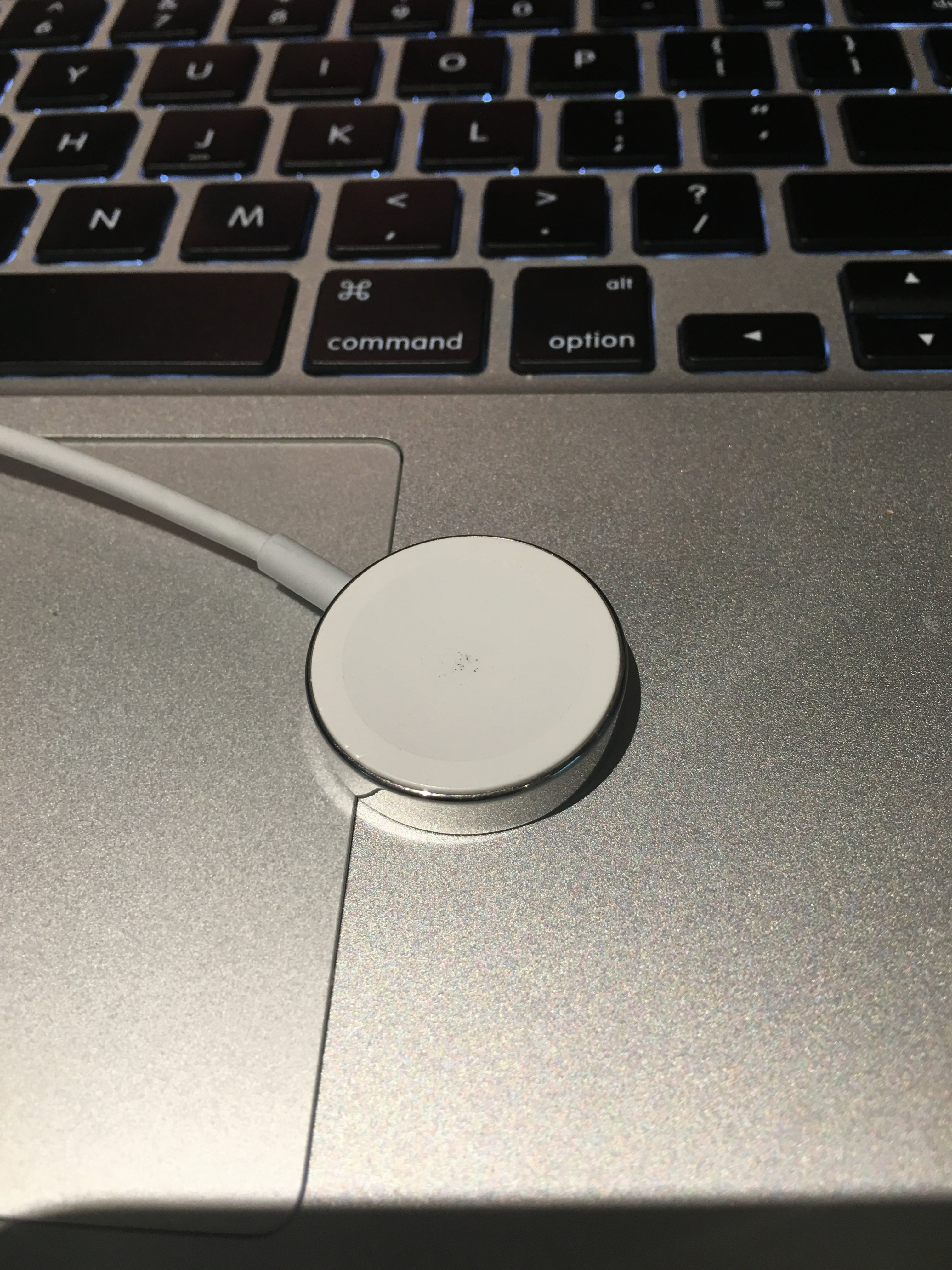

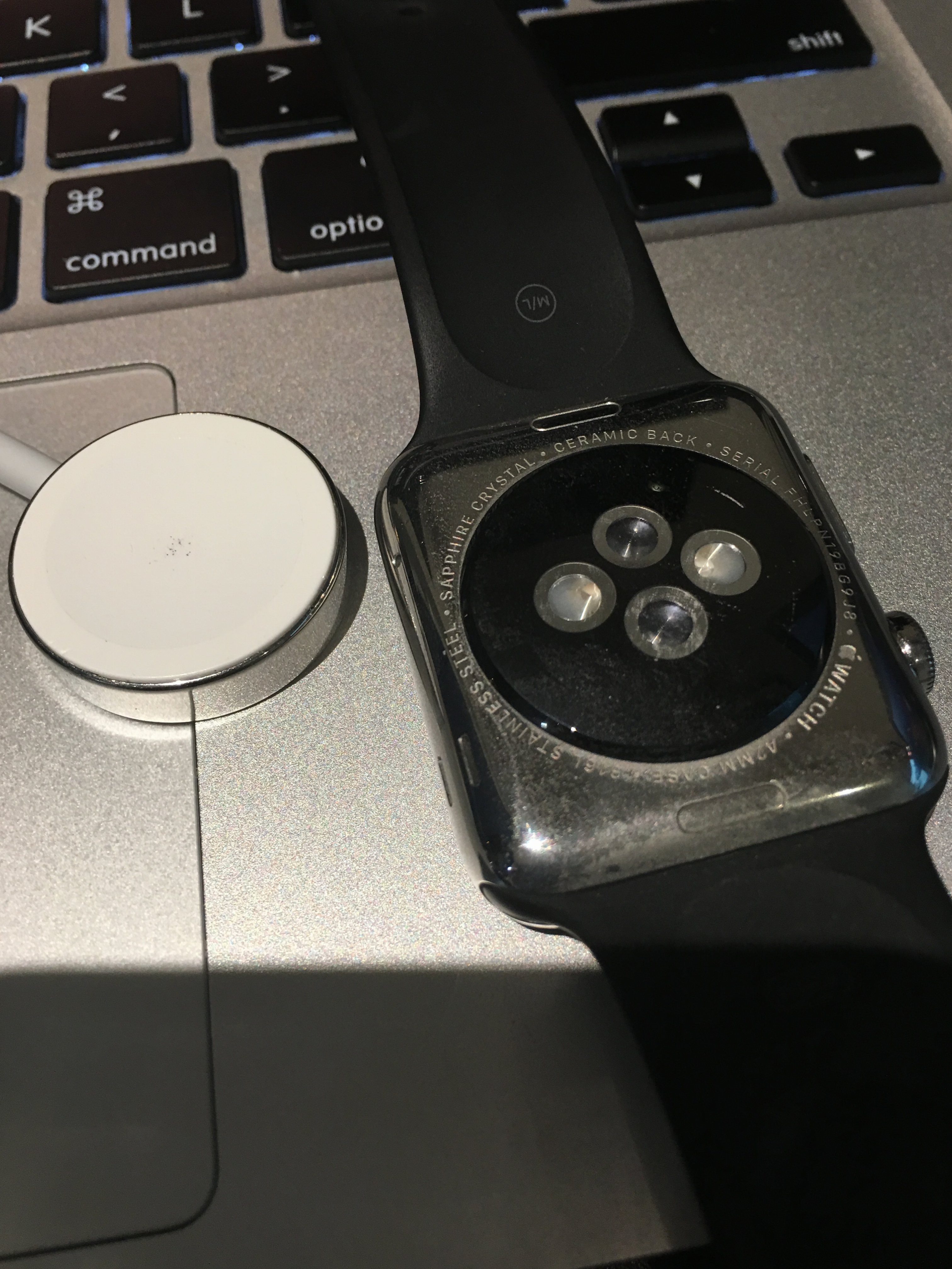

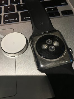

Ah ha! I was wondering if having it plugged into my mbp had something to do with it does your charger and watch look like this?

I do wonder if the loss of coating actually is allowing heat to transfer during the charging process. Could explain why the sting was in a very narrow part of the watch and why it wasn't overall hot.
Any evidence that the white coating plays a roll in preventing heat conduction?

my camera doesn't work at the moment but my charging puck has turned to a sort of nasty beige color and there are cracks in it.
When I saw the pic of your charging puck I thought it looked dirty so I went to take a close look at mine. I clean my watch every time I put it on the charging puck. To my surprise, my charging puck looks scratched and has the small beginnings of a pitted appearance that makes it look a little grungy, too. I tried wiping it clean with a flannel cloth but that look is here to stay. I'm not so concerned with scratching, that's to be expected. But I don't know what the tiny pinprick pits are. They are darker in color. It's still faint so I don't know if I could get a decent picture at this point.
I'll have to keep an eye on it, I guess. I was surprised because I do put a clean watch gently onto the puck. It does get really warm sometimes. Other times it stays very cool. I don't know enough about this subject to conjecture on why that is.
Just checked--husband's charging puck is scratched and a tiny bit grungy, but not pitted.
Sounds like something from the watch shorted out on your wrist. Maybe some arching. That explains the auditory sound and the short burn sensation.
Also that also would correspond with the pitted chargers...
