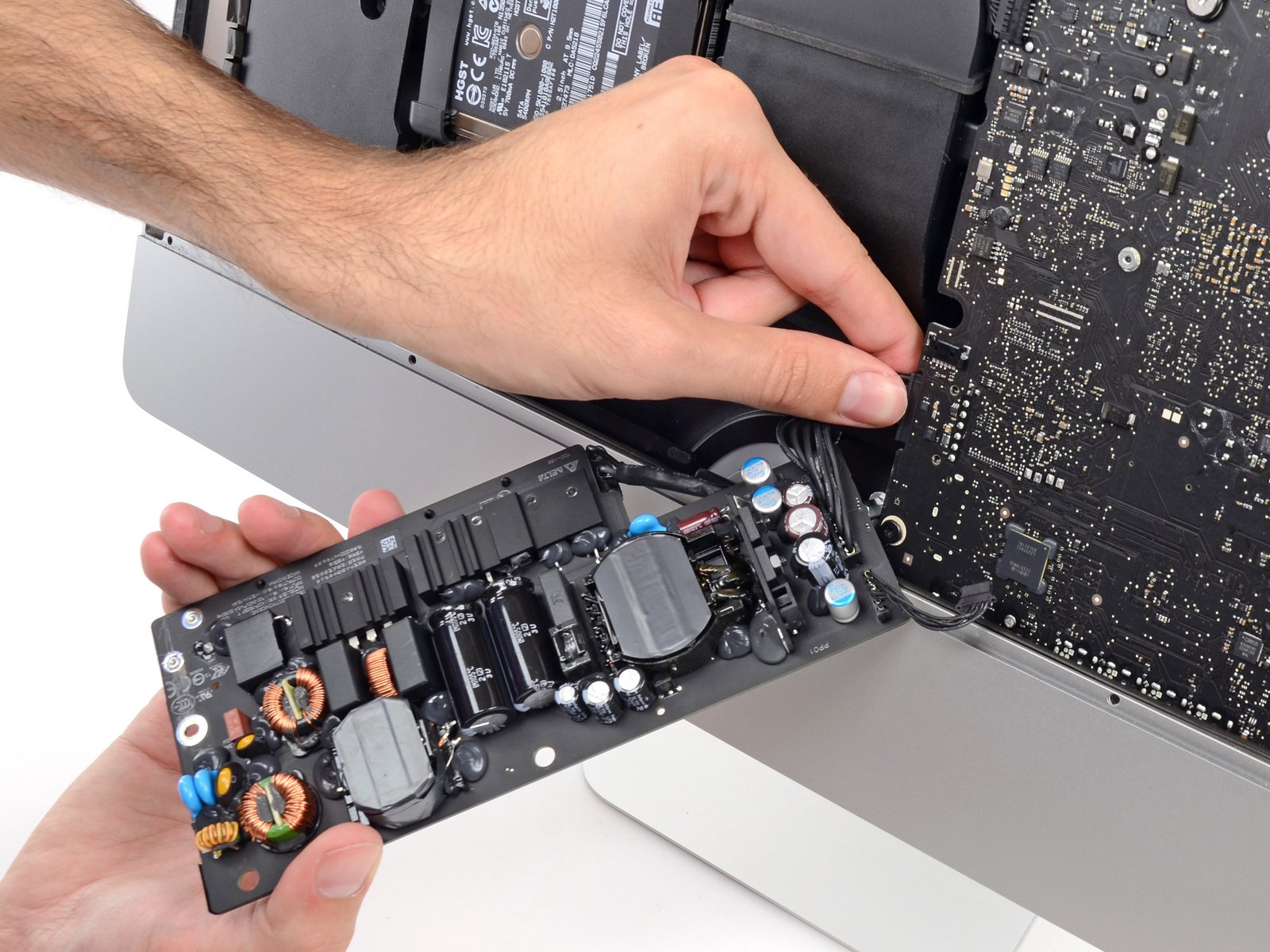

Can someone explain why having an internal power supply such a feat of engineering? And why did it require a 50% thicker chasis? My much more power-hungry 27" Intel iMac already has an internal power supply -- is it such a feat they were able to do for a monitor here?
What they said is a little exaggerated. It's not impressive that it's internal; it's impressive how thin it is for a power supply. PSUs in general are fairly "tall" even in say the 2017 iMac line because of their components. The nice curvy lines of the old iMac design sort of "hid" how thick it gets in certain parts. This display is on average much thinner which is partly enabled by the fact that the PSU board has cutouts in it for the biggest components on that board. That's not common (just look at the screen cap from the video side by side with the above link).
Now if you ask yourself, "why does the M1 iMac have an external PSU yet they designed this thing to have an internal PSU?"...I really don't have any idea. I would tend to agree that it doesn't seem like the initial intention behind this design was to be "just" a standalone display.
Power supplies tend to have some of the biggest components on a board such as inductors and capacitors. Getting it spread out this thin over a large area is not as easy as building your box to put on the outside. The iMac had a lower chin to fit everything in there. Also it wasn’t designed to power a macbook pro like this display.
