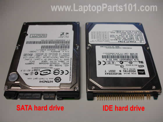

How old? Is it P-ATA (IDE) or S-ATA?
And to all the others that might follow this thread, does the interface have any relevance on the booting abilities?
it is P-ATA. I plug both 2 usb to laptop from external HDD.
