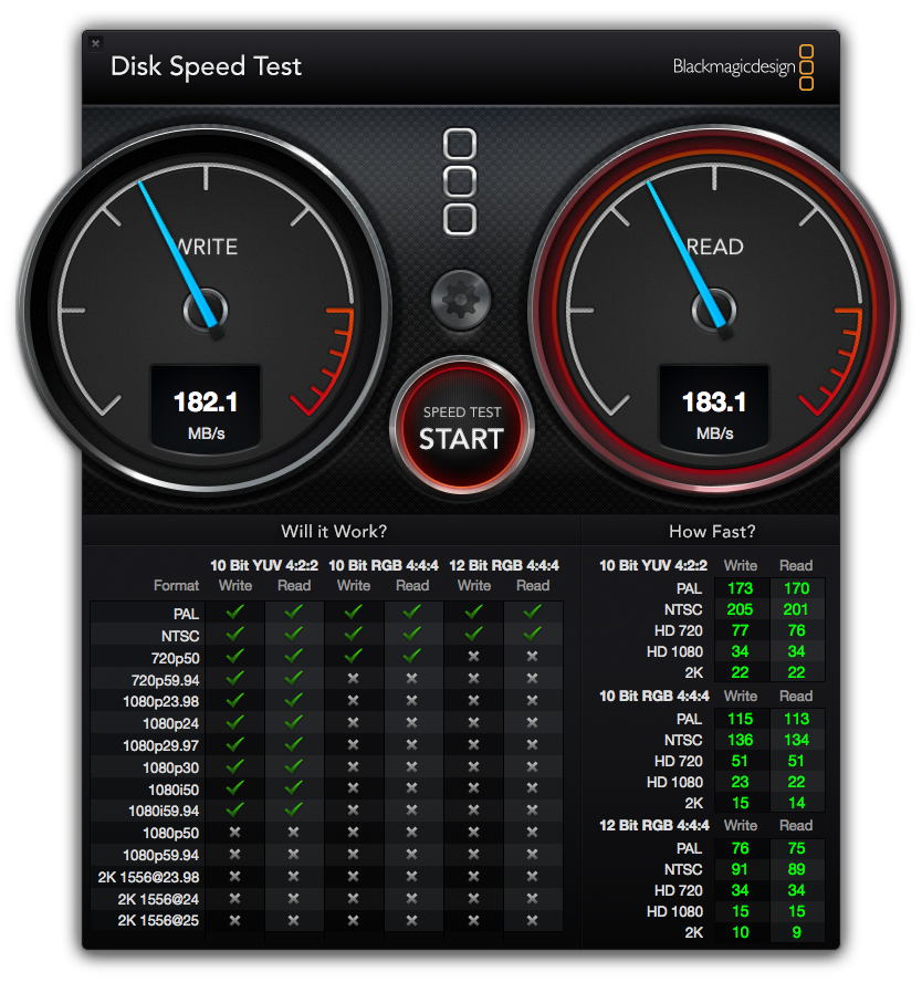

Re-ran some tests. Just grabbed a screen of my 1TB Seagate inside my 2012 iMac. I saw a few peaks at 190MB/s per second, but I never got above this as a result. My 3TB still benches about 10MB/s faster. Not sure why. And I've repeated these tests on several 2012 iMacs with the 1TB Seagate.
Also, bear in mind my results below were not the first run. BlackMagic runs over and over. The run below was maybe the third or fourth cycle. My first run is at around 165MB/s.

See? Not that much difference when they use the same platter density/design.
