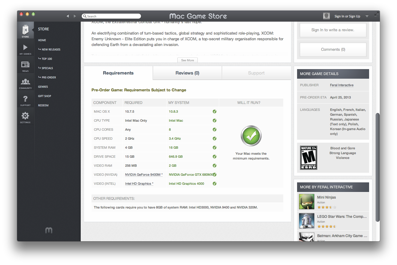

What? The Intel i7 3770 used in the top end 2012 iMac has the integrated HD4000 on chip. Although the HD4000 is not used as a GPU, the the output from the from the nVidia GPU is routed through the HD4000 to produce the Thunderbolt video component. The same routing applies to the i5, although it contains the HD2500.
A little further proof that HD4000 is onboard, though no way to access it that I know of:
Is that proof, a Mac Games store, it just says it will work on 680 and HD4000, nothing to see here, unless I am blind.

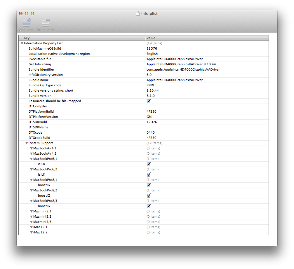

I found something very interesting, a plist file in:
/System/Library/Extensions/AppleIntelHD4000GraphicsVADriver.bundle/Contents/Info.plist
Look at the screenshot under System Support, 2012 iMac's are not there, iMac 2013 Model Identifiers are 13.1 for 21.5" and 13.2 for the 27"😎
Edit: BoostIG is Boost Integrated Graphics!
Might be possible to enable IGP by Editing a few .plist files.
Nice find, 13,1 and 13,2 are Late 2012 iMac identifiers. Unfortunately editing the files will not work as this is a limitation set before the OS is loaded, again, otherwise we would see the 4000 on the linux/windows side....
I feel the only true way to test this is by unplugging the GTX675/680 and letting it boot.
It does not work on an iMac, do you know of one that does?
What about a safe boot, probably not, it will most likely load Apple's own limited drivers.
