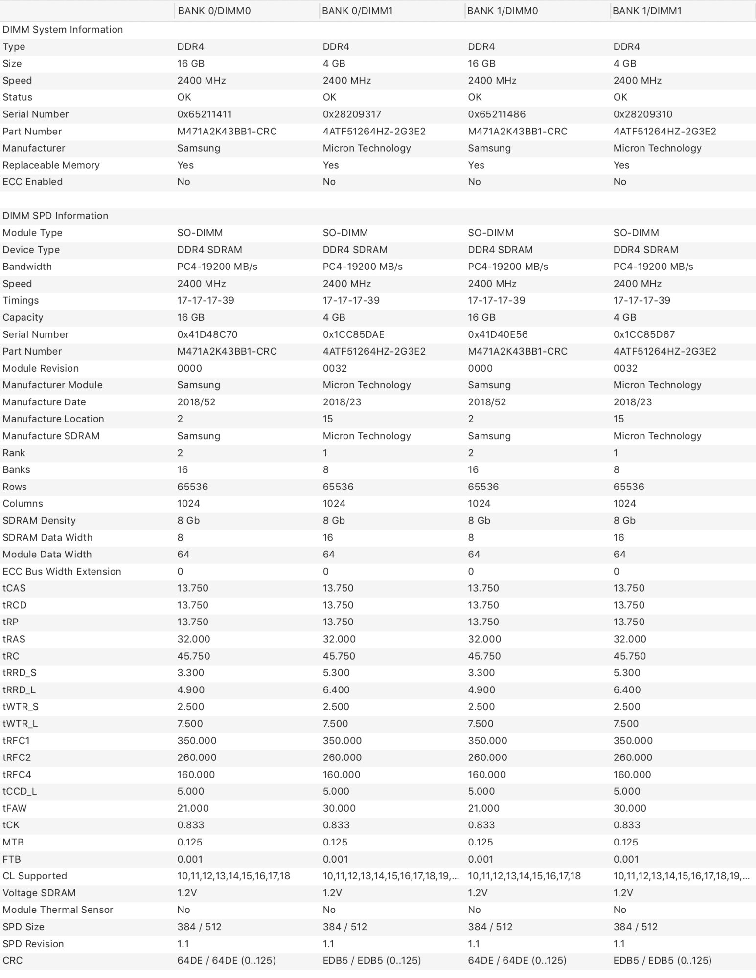

So, I bought two used, 16GB RAM chips for only £48.
Specification is Samsung PC4-19200 PC4 2400T 16GB DDR4 2RX8 2400MHz 260pin.
Info taken from eBay listings page:
Manufacturer SAMSUNG
Part Number M471A2K43BB1-CRC
Capacity 2X16GB
Version 2Rx8 PC4 2400T
Configuration Single 16GB Stick
Format DDR4
Speed PC4 2400T
Bus Clock 2400MHz
Memory Timings CL11
Form Factor 260 pin SODIMM
Pin/Connector Material Gold
Error Correction None (Non ECC)
Buffering None (Unbuffered)
Voltage 1.2v
Memory Range Laptop / Notebook SODIMM
They weren’t specifically designated as Mac-specific.
Hope this helps.
Edited to add to the above post, the 16GB Samsung RAM chips work fine in my 2017 iMac. Attached is a Tech Tool Pro report on these chips, which I hope someone will find useful.
