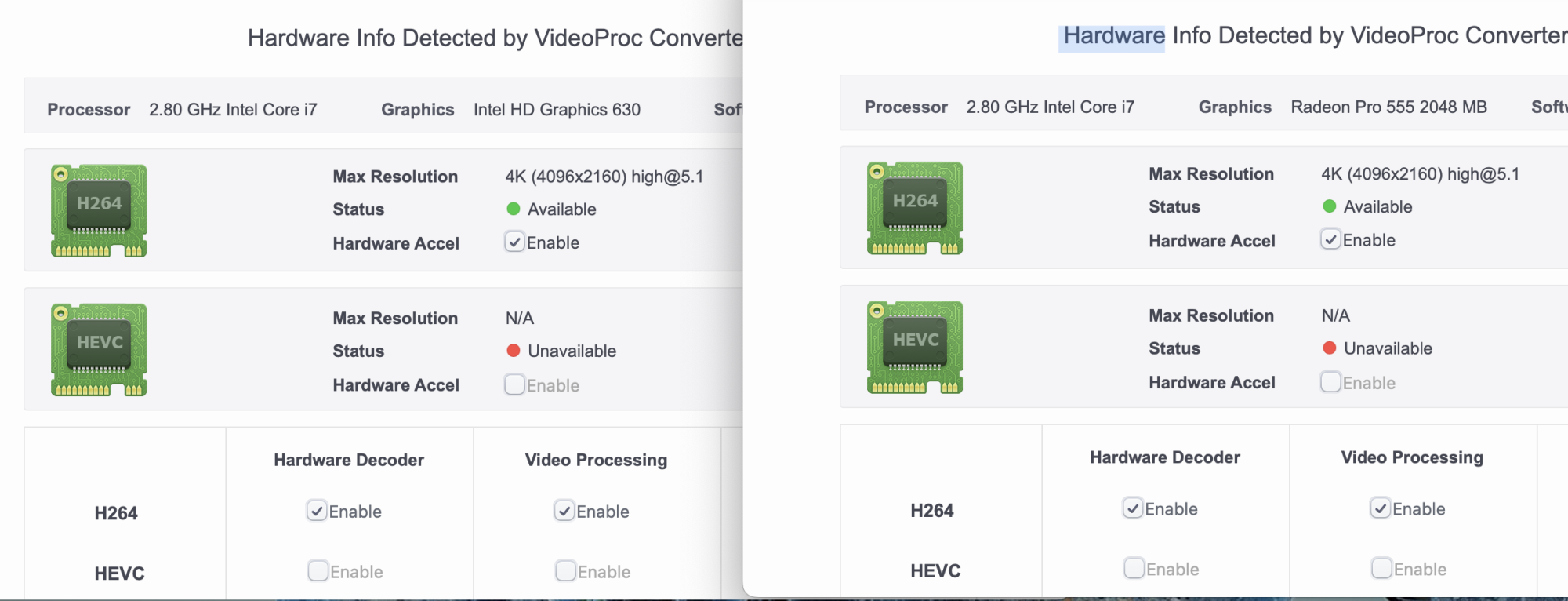

To make it clear what we're talking about.
Old versions of VideoProc show only an integrated video accelerator, new ones show a discrete one.
HD630 can't work in Sequoia. But even if it did, there won't be any H.265 decoders.

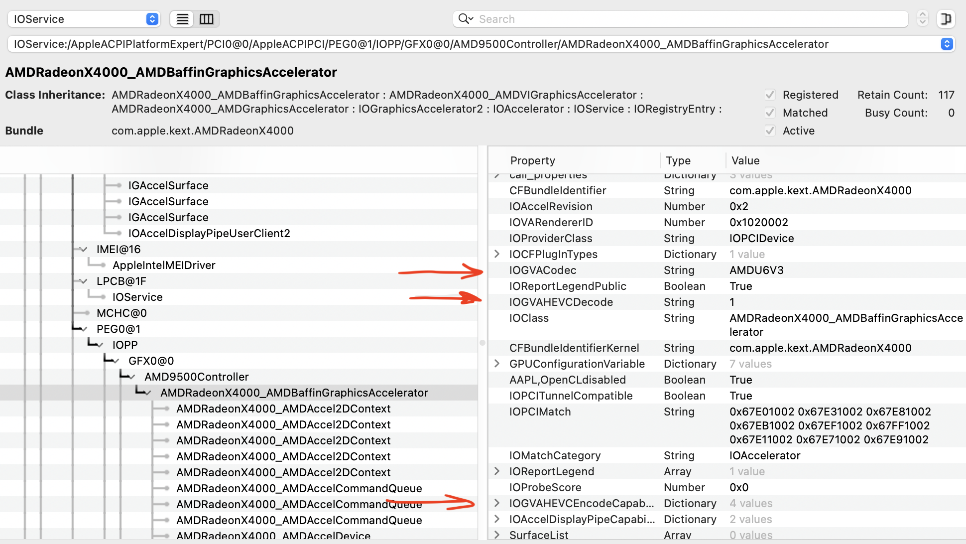

You can force the system to use the decoders of the discrete video accelerator. To do this, there is a set of commands that need to be run in Terminal (for example, defaults write com.apple.AppleGVA gvaForceAMDHEVCDecode -boolean yes - will enable HEVC decoders).
But all these properties have long been removed from MacOS.
They can be returned manually.
But it will be better if you return to using Sonoma or Ventura.
