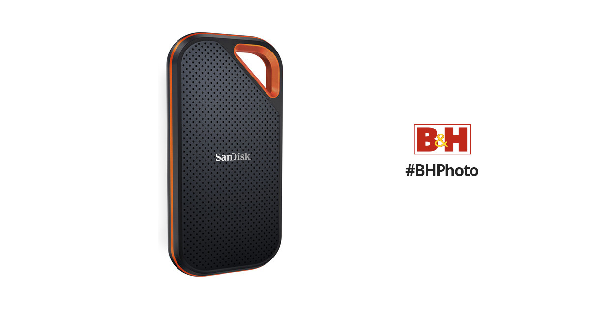

For my M1 Macbook Air, I opted for the new Sandisk Extreme SSD V2. It connects at 10 GB/s link speed and maxes out around ~780MB/s sequential speed tests. I went with this option instead of DIY enclosure/SSD because a) 5 Year warranty from Sandisk b) The enclosure is sleek and the SN550 SSD controller is customized for external usage, and c) most external enclosures can be tricky to pair with the correct drive (Realtek ones seem to be stable)
If your requirement is for higher speeds, then it is best to purchase a Thunderbolt drive or enclosure.

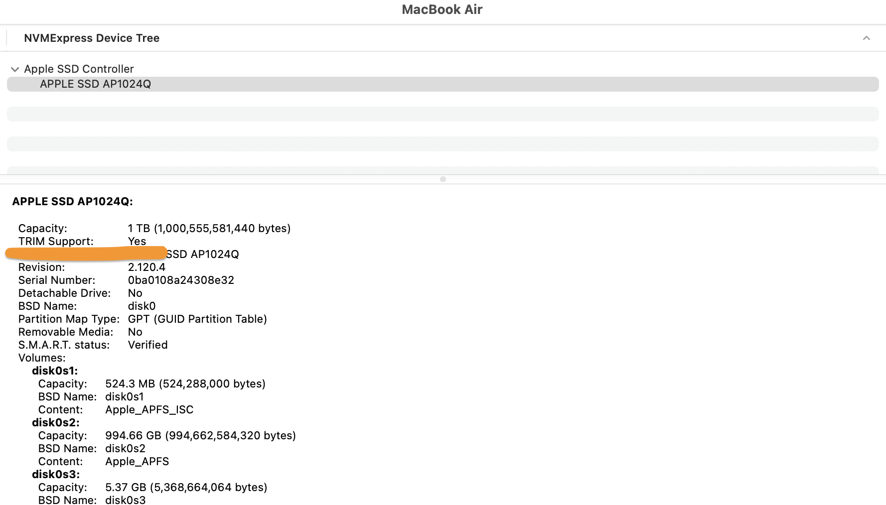

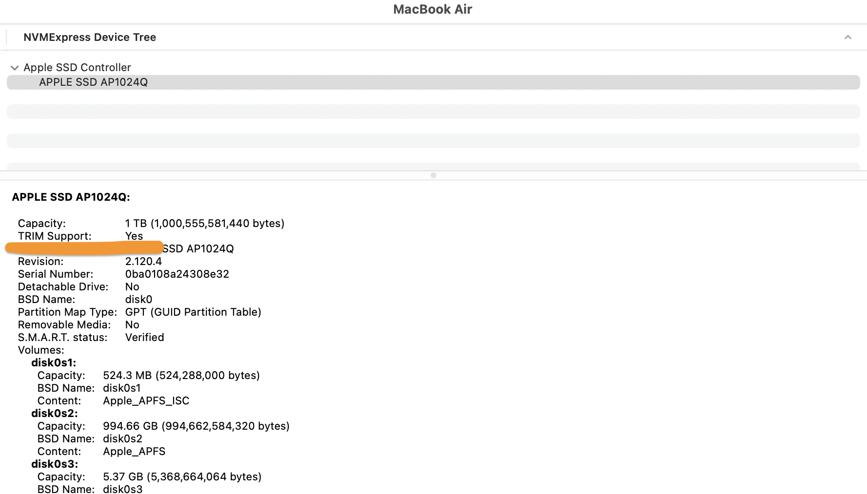

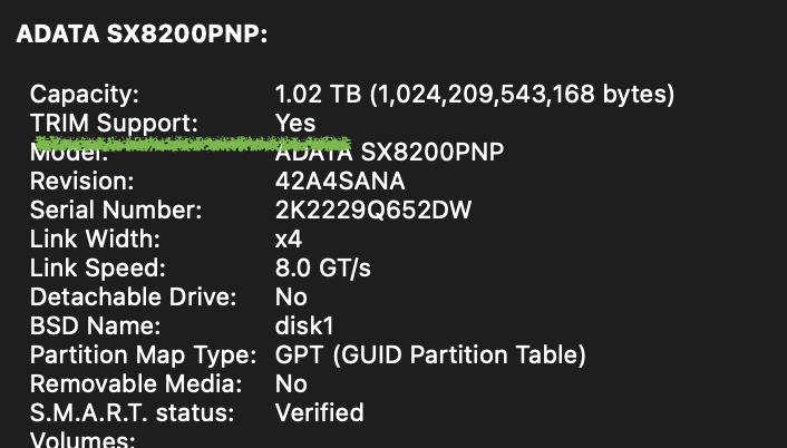

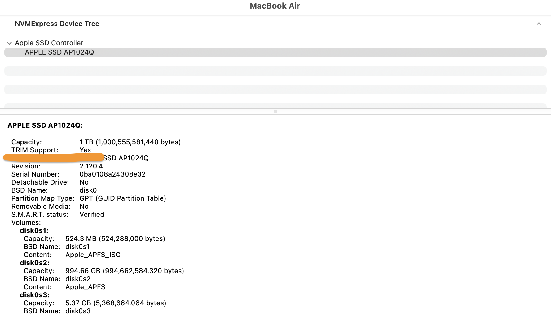

I don't see any mention of "TRIM" on either the internal SSD or a TB3/NVMe SSD
It looks like the internal M1 SSD controller supports TRIM. From the macOS Big Sur System Information on my M1 MBA:

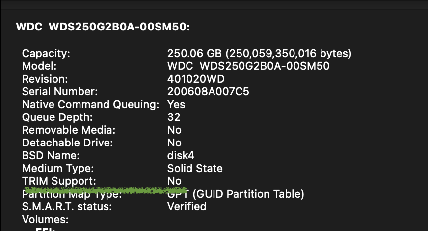

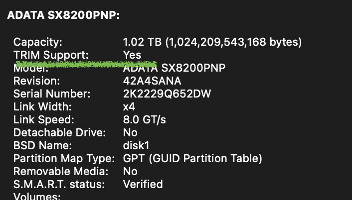

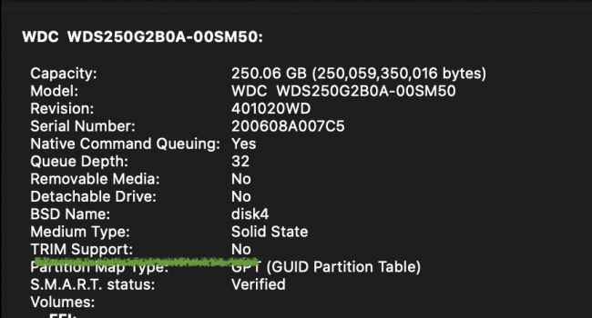

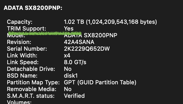

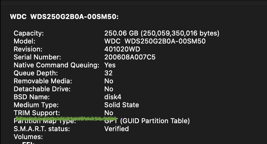

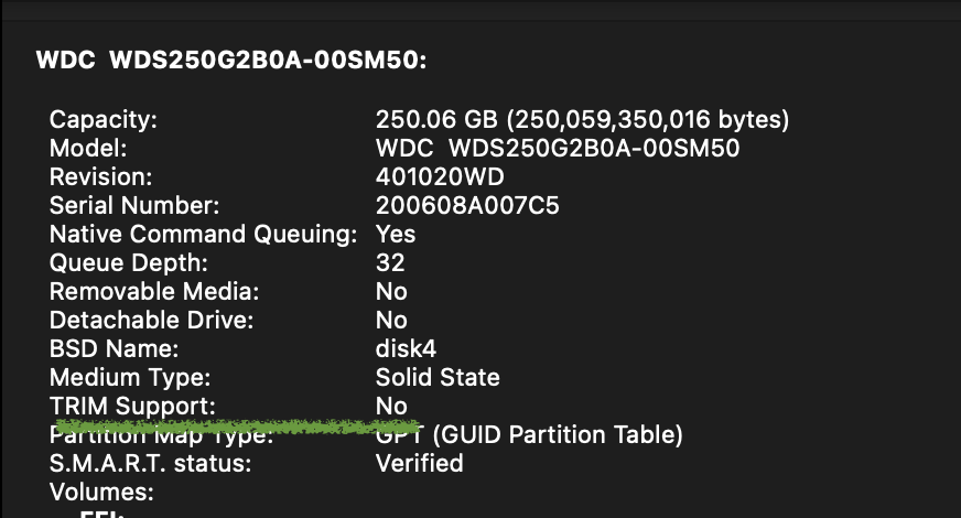

Well I am an idiot. Or blind. Or both. I looked again at the Sys Info window and they do in fact both show it (internal, and TB3 connected M2). I blame the inconsistent ordering:
View attachment 1780481View attachment 1780480
ok, so the internal one has not TRIM enabled and the external thunderbolt one has TRIM enabled.
Did you touch the internal one settings or it has TRIM disabled by default? a little bit weird
No sorry the two nvme (internal mini and external tb3 m2) both have it enabled
the disabled one is a 2.5” SATA ssd in a tb3 SATA multibay enclosure. I’m not sure why it’s not enabled, it’s in a software raid so that may contribute to it.
