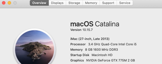

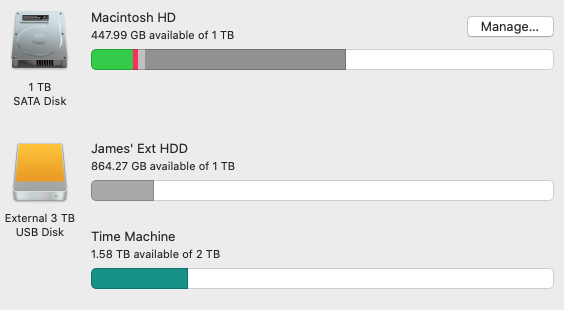

Now, I know this will have been covered many times before, so please excuse me for asking.
I have an old iMac 27 inch Late 2013 that has been a good workhorse for years.
However, it appears to be very slow compared to how it was when new and compared with newer models. No surprise there!
How can I cost effectively upgrade its performance?
I understand that the HDD can be changed for a SSD and also upgrade the memory.
I am fairly Tech savvy when it comes to taking things apart and putting back together, so that bit doesn't phase me.
All I think I need is a 'shopping list' of components and tools for getting the screen off etc.
Is there a link on the forum that has this for my particular model. Screenshots below of what I currently have.
Any help, very much appreciated.
Thanks in advance
James

You may not want to read this but your iMac is inching towards 10 years old and without patchers cannot be upgraded further than 2019 macOS Catalina 10.15.x when 2020 macOS Monterey 12.2.x is now the norm.
How much do you realistically want to spend? It can’t run the latest macOS. I’d say let it live out a second life as a media server and put that money towards a new model.
Since it lasted so long. You certainly don’t need to buy a high end model. A Mac Mini paired with a decent 4K monitor would run circles around it.

Just do a SSD. This alone would be a night and day difference. It will feel like a totally different computer. You can use the activity monitor app to see if you would benefit from more RAM, but I think the SSD would probably be enough based off of what you posted.
You could skip opening up the Mac and just buy an external SSD. You could do a SATA SSD, and USB enclosure or USB/SATA adapter cable. Not as fast as swapping the HDD for a SSD, but still a night and day performance difference on Catalina.
You can get a 1TB SATA SSD, and an enclosure or adapter cable for less than $100.
Best part about this is that if you decide you like it, you can always install it internally later on.

Your 27” late 2013 iMac will run Big Sur using Open Core Legacy Patcher. Mine does, very well. Be sure to pull that HDD and install an SSD, prices for 1Tb are reasonable. Personal preference is Samsung or Crucial. Installing the SSD on the main bus is faster than using an external USB3 enclosure. If you are comfortable opening the 27”, go that route. Just read up on the procedure and take your time. One last suggestion, if you are running less than 16gb of RAM, upgrade. I’m running 24gb. You don’t want to bottleneck the system with minimum memory.

The biggest downside of using USB versus internal SATA besides the slightly lower speed is that there is no TRIM support for USB drives on MacOS. This could lead to slower speeds later on and shorter lifespan for the SSD. Not a big deal if this was just to get your by for a few years til your next Mac or until you got around to installing it internally.
There are other external options for your iMac that are faster, but probably not worth the investment. Any TB drive will have TRIM support. A TB3 SSD would be much faster than the USB SSD, but a lot more expensive. Although, you could alway use it on your next Mac.
