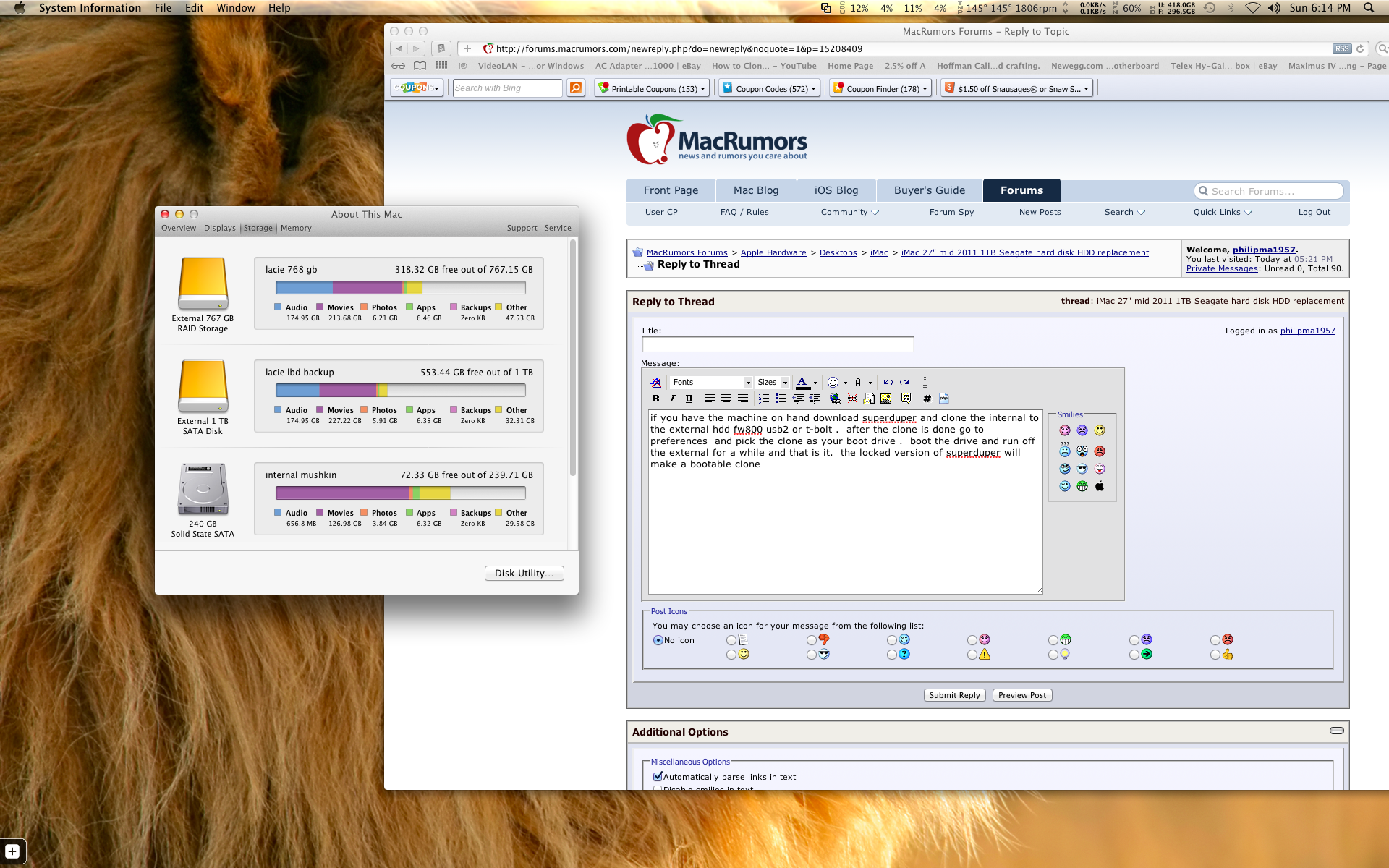

  22. philipma1957 macrumors 603
    philipma1957
    Joined:
    Apr 13, 2010
    Location:
    Howell, New Jersey
    #22
    if you have the machine on hand download superduper and clone the internal to the external hdd fw800 usb2 or t-bolt . after the clone is done go to preferences and pick the clone as your boot drive . boot the drive and run off the external for a while and that is it. the locked version of superduper will make a bootable clone.
    the 1tb drive is a clone of the 767 raid0. both are osx both boot.
