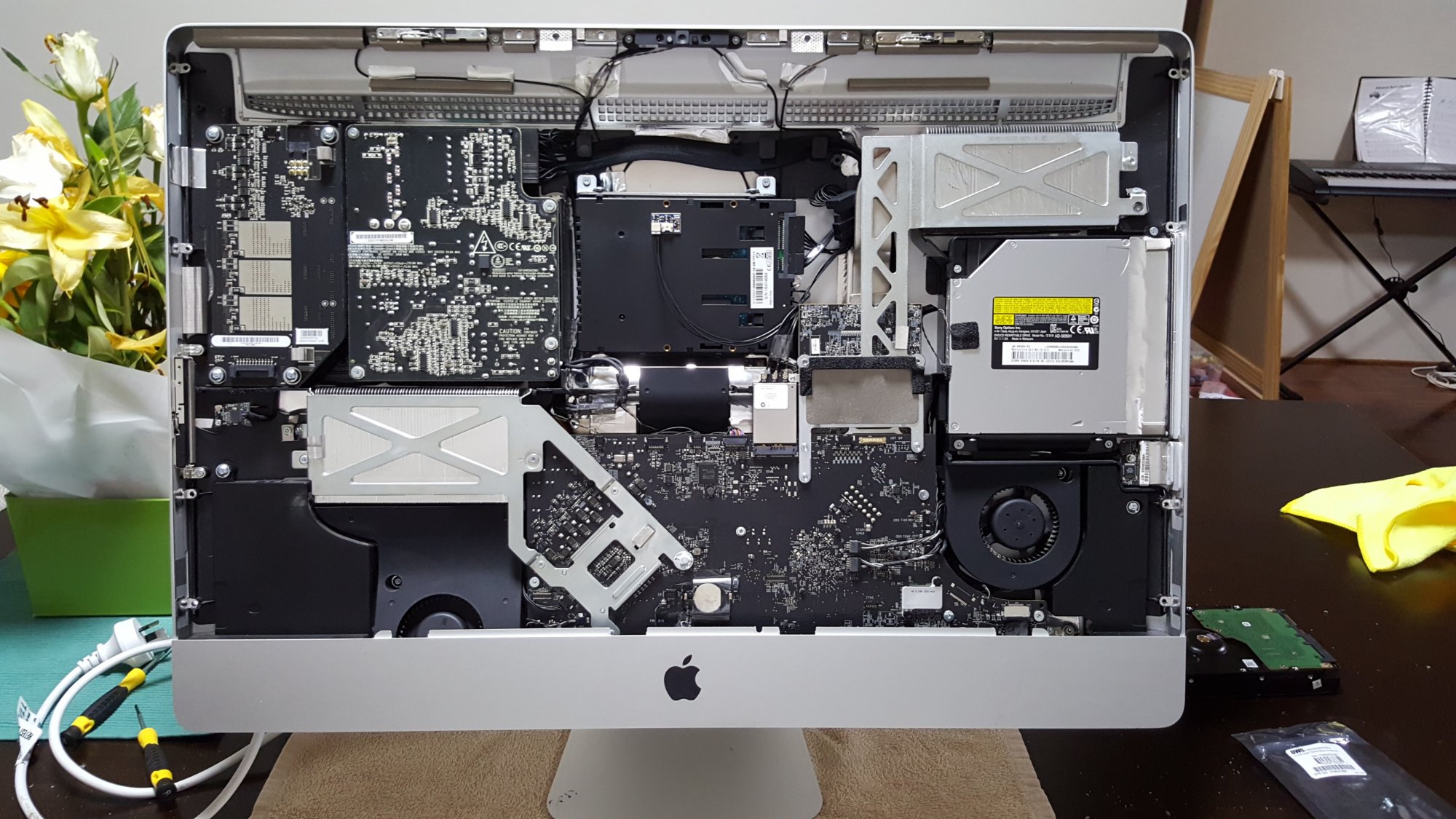

By the way, would you be able to confirm if I don't need to pull out the logic board to remove the GPU in this model? Thanks
(This was before I replaced the SATA drive with SDD)
Reactions: 0607557
You have to get the complete logic board out. Please pull the memory modules out, first. Since there is no cable plug in double use you can disassemble and reassemble without marking each and every cable. Just take a picture before.

Installed K1100m with heatsink grease and silicon pads (instead of k5) for the ram chips.
Booted Xandrons linux image from sd, ssh'd in and ran the nvflash_linux util.
Rebooted into MacOS & copied the OpenCore files into my EFI partition.
Reinstalled the lcd & closed up the iMac.
