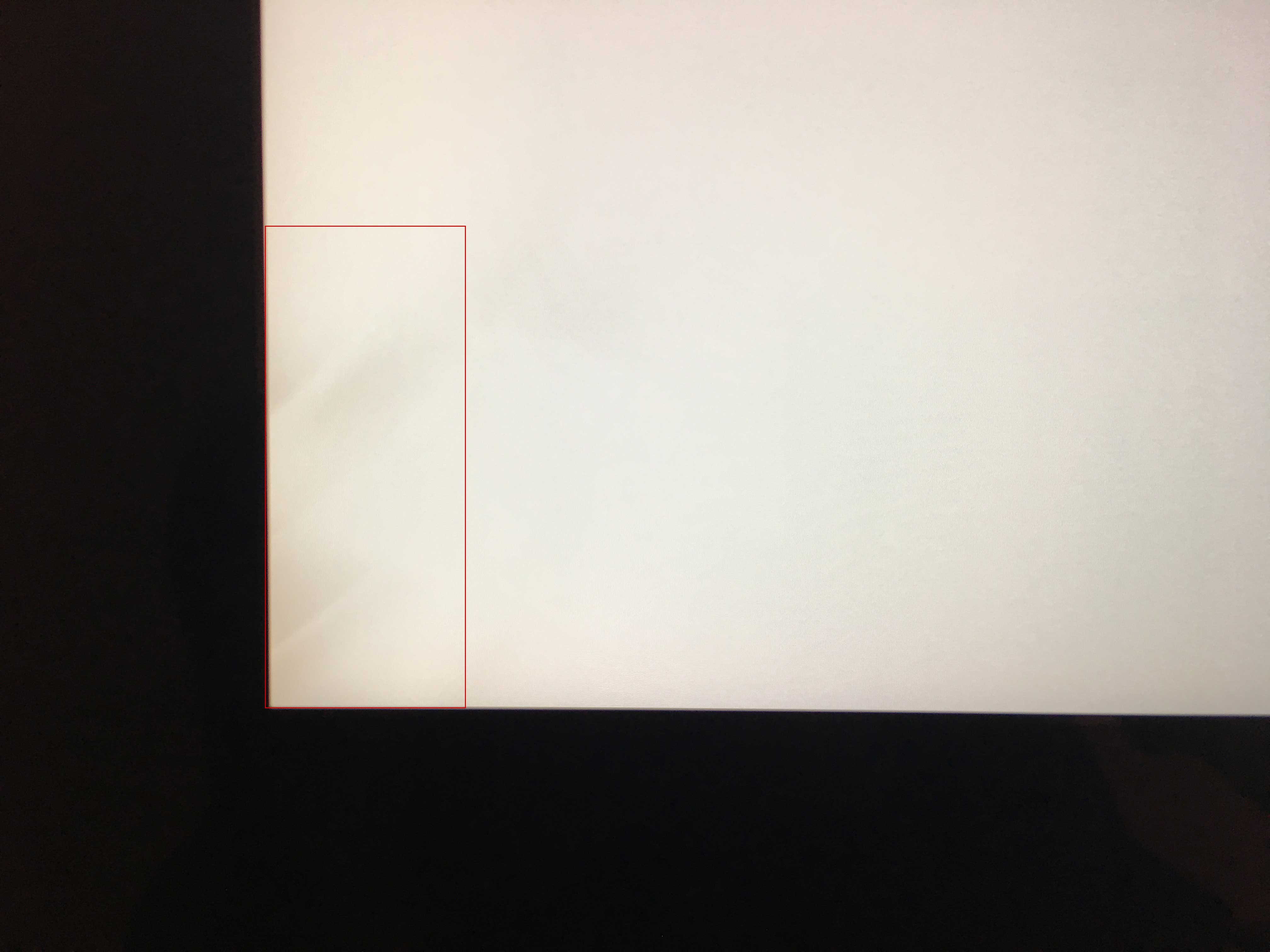

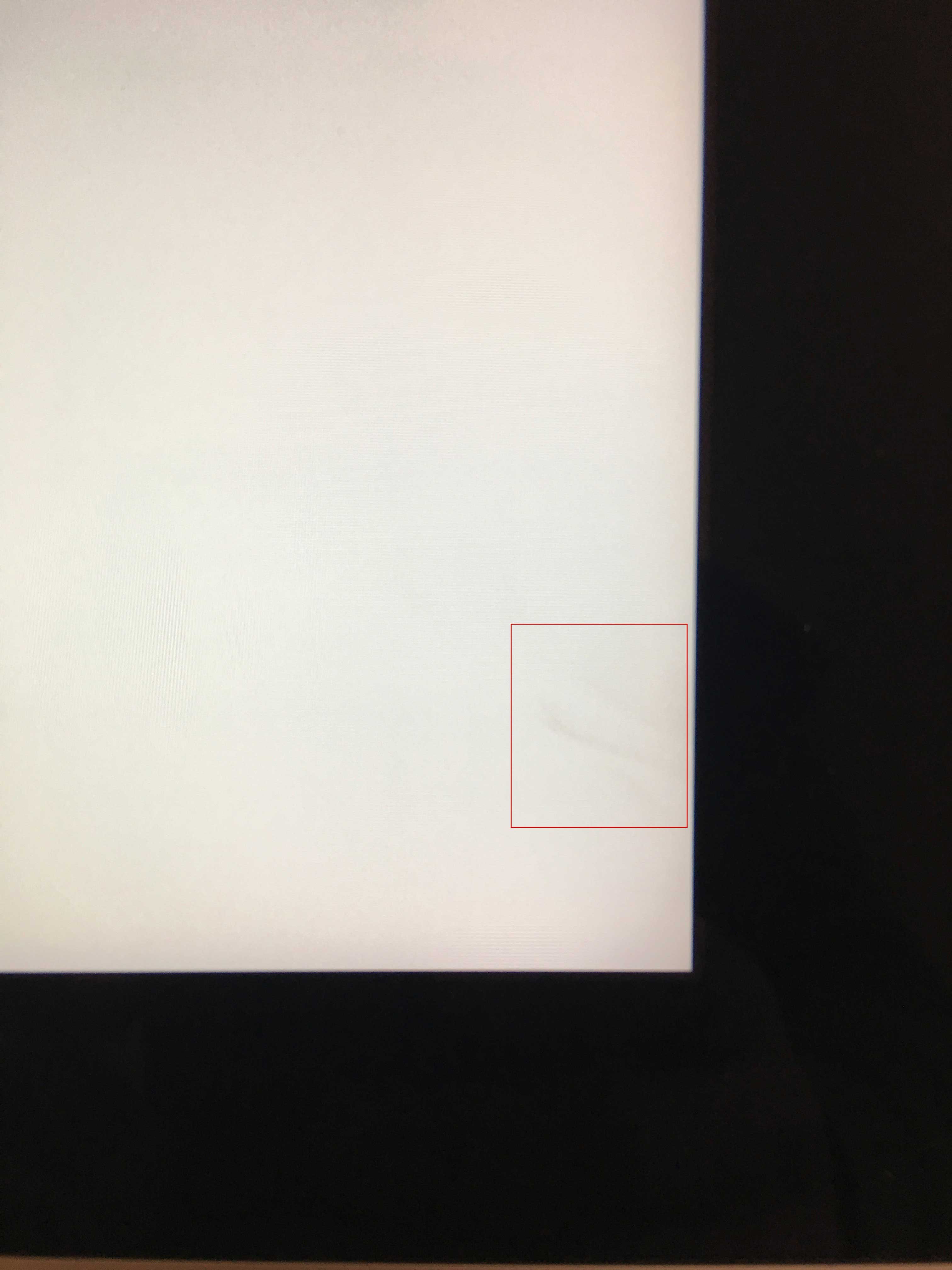

I just noticed something that looks like stains/clouding/darker zones in the lower corner areas on my 7 month old iMac 27" (late 2015). What is going on, can anyone advise?
I guess it is repair time, I contacted Apple Authorized service, and they said they will have to replace the screen assembly. Bad thing is it needs to stay in about 15 days.

Same thing with mine. Bought a late 2013 27", had these dirty dusts inside the screen and after the replacement, it came back again. It is actually between the LCD and the white filament. It is repairable on older iMacs (magnetic), the later models need to have its full screen replaced. Thought the geniuses at Apple have fixed this flawed design.
The last two posts are not very comforting. I am wondering how is that even possible, as anywhere I looked it is said that the glass and the LCD panel are fused. If they are fused, aren't they supposed to be sealed properly so that no dust or other particles can get in-between? I looked at the ifixit tear down, and examined the display assembly. I could see black tape around the edges, with some visible gaps - if that is the seal, there is no wonder why dust gets in. Has anyone ever attempted to un-fuse the glass and LCD panel? How are they fused - are they glued together?

Well, OK, but it is unthinkable to manufacture such an expensive 5K screen that allows for dust to settle in-between the LCD and the glass. It is beyond my comprehension.
yes, i had the display changed three times...the dust comes through the chin/ventilation
This is insane... madness.
i think it is dust, dirt, smoke residue, incense residue accumulation... but i could be wrong
Whatever it is, it is just not right. When you manufacture a display assembly where the LCD is "fused" to the glass, NOTHING should be able to come in there.
