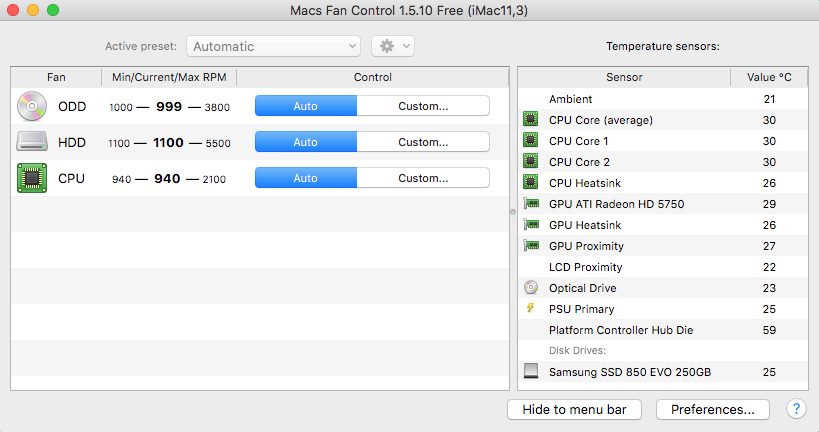

I know that temp cable is only US$8 or so, but save your money, don't waste it on that OWC (or similar) temp sensor.
Just do what many have successfully done, myself included. Very simply shorted out the HD connector with a home-made jumper wire as shown HERE. Find a piece with wire diameter (with ends stripped) that is a good snug fit in the connector female sockets and it should never come loose. I've never had a problem since.
Yes I saw that. I had read though the one difference is that if you use the optical drive temp sensor cable you’ll have a temp reading if you look for it in temp monitoring software, but if you do the short out method you’ll get a ‘null’ reading. I didn’t know if that was truly accurate or not but I figured for CAD$10 and same day shipping, why not?
I was curious to see if the drive temp shows up with that optical drive sensor, so I downloaded Macs Fan Control to check.
Confirmed. It sees the temp reading just fine using the optical drive temp sensor cable. See bottom right of picture:
