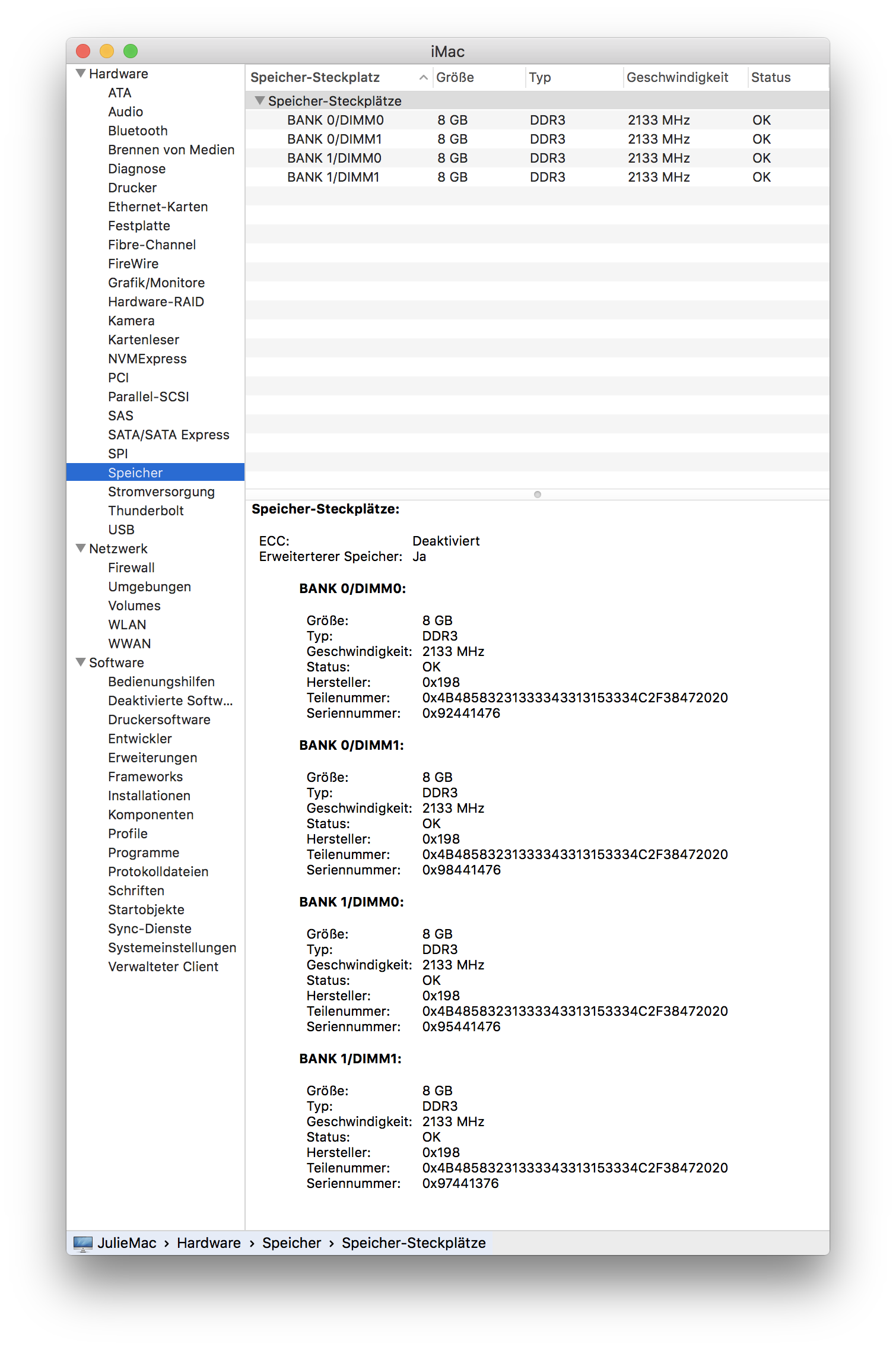

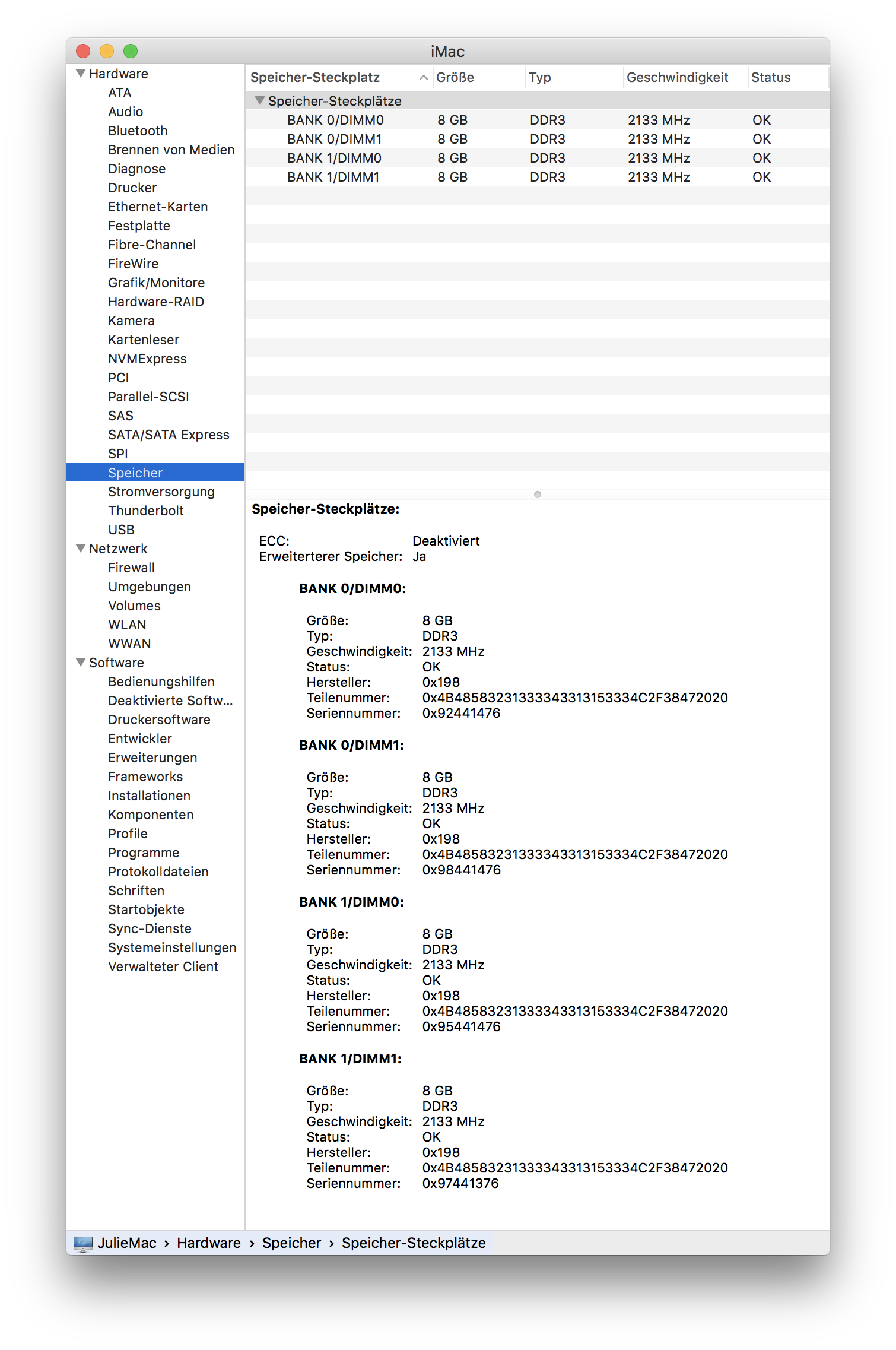

I have the Kingston HyperX Impact 2133 MHz DDR3L with CL11. Might be a little faster if you don't mix them with the stock RAM, then they'll slow down to 1866 MHz and may cause other problems.
http://www.amazon.com/dp/B00NTQ0GOM/
CL9 might be a little better but I have no experience with any. There is a long thread of what RAM is suitable for that iMac.
