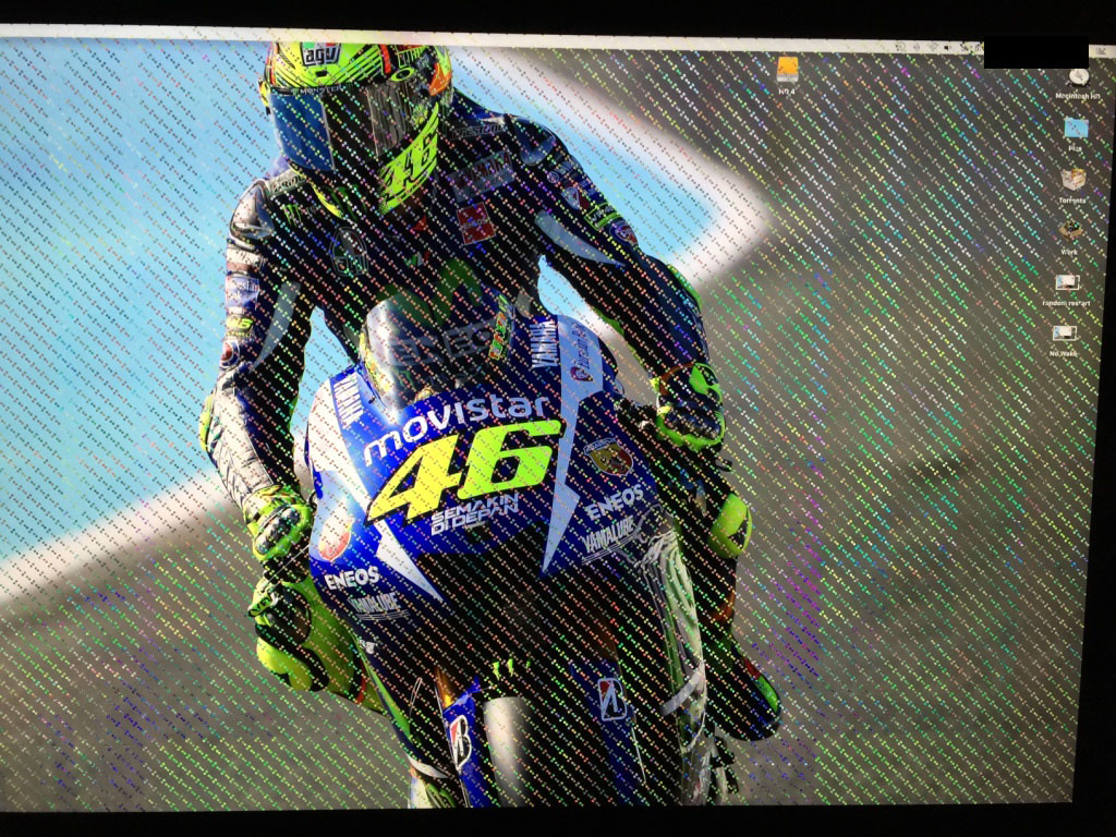

My late 2015 27 5k 3.3 with 512 ssd was having sleep problems since I got it. Then it randomly started to restart on its own. Then graphics problems started. I took it to the apple store and couple times and finally they just returned it.
This is what my screen looked like
