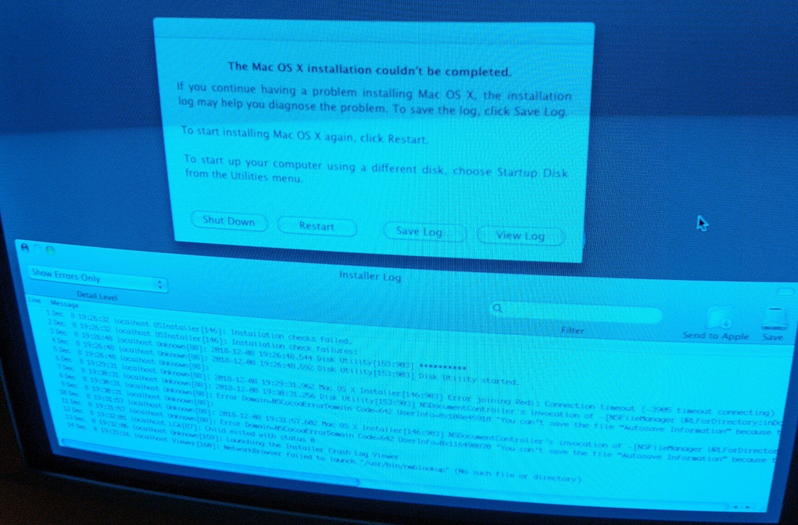

Hi Mike. Do you know where I can find the ISO of 10.5 or 10.4 online? I still haven't resolved the issue.

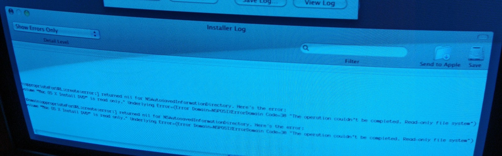

Also here is the error log:
If you were able to boot from an external drive and got that error, this is good. As explained earlier, you must erase reformat the SSD properly before a Mac OS can be installed on it. Then you must install using the commercial installer — if you have the disk image, it can be run from an external drive capable of booting the Mac or the internal SuperDrive using the DVD-DL.
With 10.4, you probably need a restore disk. 10.5, and 10.6 were paid releases. If you can find them on the internet, good for you but I don't have valid links. I have both but my DropBox account is too small—both were released on dual-layer DVDs and are around 6G in size.
If you have a DropBox account with 7G or so free, I can upload a disk image to you. GoogleDrive works also. Send me a PM.
