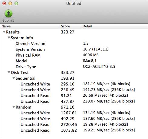

I did this with a 2008 iMac just a couple of weeks ago, using an SSD. It's awesome. XBench speeds attached.
Wrote a small post about some pitfalls and stuff, here on my blog.
Models of SSD and RAM linked from the post too.

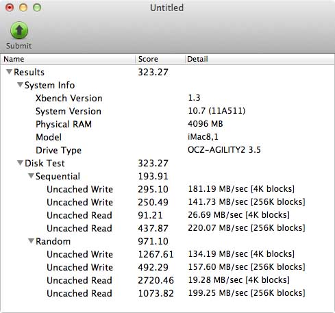

XBench benchmark
Old 320gb Hitachi stock drive
New 1TB Western Digital Caviar Black
Not so fast as an SSD but it was definitely worth it. My iMac feels faster now. iPhoto is much smoother now with loading the thumbnails.
I think the speed difference is well worth the sacrafice of disk size - it totally transformed my machine (as you can see from my benchmark). I use a firewire 800 external HDD for storage and only software on the OCZ.
