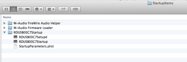

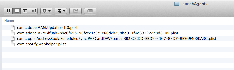

If it's not happening in Safe mode, it may be some app you have launching automatically. You can check the following locations for apps that automatically launch on startup and delete any you don't need/want:
  • System Preferences > Users & Groups > yourusername > Login Items (SL and older: System Preferences > Accounts > yourusername > Login Items)
  • In Finder, click Go > Go to Folder > /Library/LaunchAgents
  • In Finder, click Go > Go to Folder > ~/Library/LaunchAgents
  • In Finder, click Go > Go to Folder > /Library/StartupItems
Thanks for your help guys.
I've found these in the following images (See Attachments)
I don't have Spotify so I don't know why that's there, but the M-Audio stuff is needed.
Also... I have no idea what that RDUSB**** thing is?!
