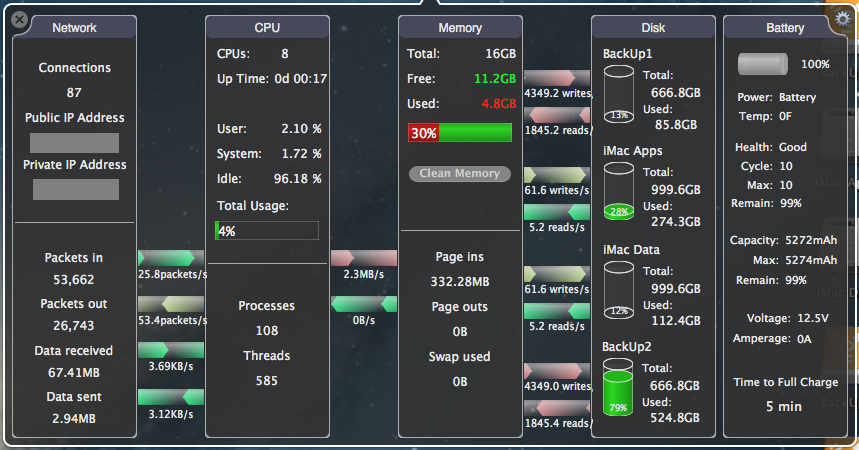

Download iStats, increase the fan speed to max and check if sound disappears.
I did... I can't see anyway of increasing the fan speed though. See attachment of iStats screenshot. That's my system running off external FW Drive and nothing running but OSX Mountain Lion (the firewire drive is an old back up before Mavericks came out) 🙂
Don't know why it has battery stats?? It's an iMac! :O
