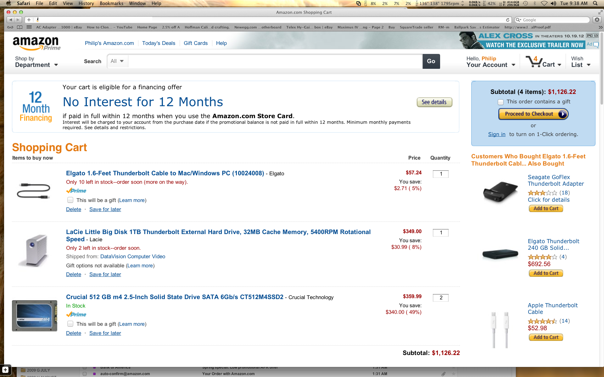

amazon dropped prices on some gear today. here is a screen shot for a 1tb raid0 ssd. setup, now my lacie has 256gb samsungs inside
this seller sold me mine 6 months ago
http://www.ebay.com/itm/Samsung-256..._Disk_Drives&hash=item4163226489#ht_980wt_907
2 of these are 350.
the lacie is 350 on amazon that is 700 the cable is 58 on amazon that is 758 for a 512gb ssd raid0.
I can't stress any more then i have that my 3x 256gb raid0 in 2 lbd's with one spare 256gb ssd has work for months. (yes I back it up with a clone and with TM)
