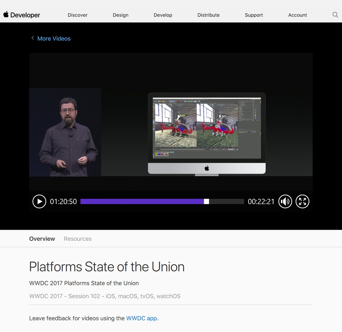

Also, cinema 4d has a GPU rendering engine coming in R19 based on AMD's ProRender, and you'll be thankful for the 8GB of vram for fitting a scene into GPU memory. It was even featured in Apple's State of the Union session at WWDC:
From a C4d tester on twitter: "cinema 4d and prorender running on metal at the apple WWDC. scene by me :)"
