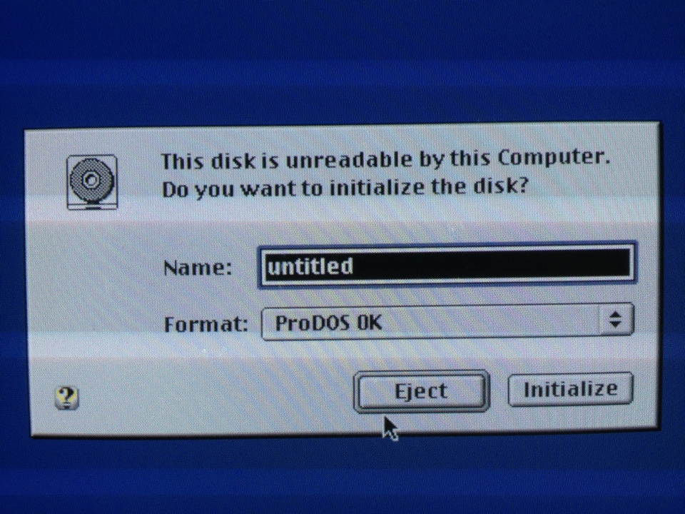

I recently acquired a 1998 Bondi Blue iMac G3, and would like to install Mac OS X Panther. First off, do I need to install Mac OS 9 before you install OS X, and/or are there any firmware updates needed for it?
My second question is: I have the .iso for Mac OS 9 burned to a CD, but when I put it in the CD drive, it says: (see attachment) "This disk is unreadable by this computer. Do you want to initialize the disk?" I also tried to put in an audio CD, and got the same message. Does this mean that the CD drive is broken? Yes, I burned the image to the CD with Disk Utility. I have also tried booting from the disc itself with the C key.
My third question is: If the drive is broken, is it possible to boot from a USB flash drive? Or, if it's not, how can I get the iMac to read the disc?

You do not need Mac OS 9 in order to run OS X.
(Unless you plan on using classic apps or games, then by all means keep OS 9 on it.😉)
The disc drive may or may not be broken.
When you close the tray, does the disc sound like it is spinning, or does it not even try and spit the initialization message?
I know from experience with a PowerBook G3 that the disc drive wouldnt even try and I'd get the same message, but repeatedly opening/closing the tray would sometimes fix it into reading.
As far as booting from a USB flash drive, I don't quite remember if older Macs were capable of doing so, I only remember booting machines from Firewire.

Okay, cool. One less thing to install. 🙂
The CD does sound like it's spinning, and it takes about 15 seconds for the initialize message pops up. I tried repeatedly ejecting and pushing the tray back in, but got the same message. I checked to see if I had all the extensions installed for the CD drive (saw a list on an Apple forum post), and I do. Hmm.
I will try to boot from a USB drive, but I did just read that bootable USB drives started with the slot-loading iMac G3s. 🙁 It won't hurt to try.
I found a replacement CD drive on ebay for $15 so if I don't find a solution I'll probably just buy that.
Thanks for your help!

Okay, so I got the new CD drive, and it works. But, when I click the Restart button in the Install Mac OS X window, it greys out, the window flashes, and it does nothing else. I also tried booting from the disc, but it just shows the 'flashing Finder icon and question mark inside a folder' icon at startup, then boots into OS 8. I installed the latest firmware update, 1.2, and that worked fine. Also, when I eject the disc, it says that there is a problem with the disc and some information may have been lost. Any ideas?
