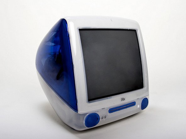

I recently got an iMac G3 (fully working!) For $20 from my friend, though he didn't have a keyboard or mouse for the computer. So I used just a generic keyboard that I had laying around. Everytime the computer booted into Mac OS 9, it would freeze after a while. I put a new HDD in it, and tried to boot to a CD by holding the D key on startup, but it did nothing. And when I had the old HDD in it, which had Mac OS 9.2, and Mac OS X 10.3.9, I would try to hold Win(Command), Alt(Option), O, and F, to enter the boot list, but it wouldn't do anything. Do I need the original keyboard to do these options on Boot?

Another likely guess: You have a (probably) twenty year-old iMac. The optical drive is ALSO twenty years old.
I don't even try to use the optical drive in my G3 these days. Any installs that I do are either from an external SSD through USB, or booting installs are from a Firewire drive.
I believe that it is a heat issue. If I let the computer rest a while, and try to install Mac OS 9, it works just fine. If I let it rest after that, then use the Setup Assistant, it works. Every single problem I've had with the computer has been caused by using it for too long. Is there any way I can decrease how hot it gets? It also constantly makes this very annoying sound, and I'm thinking that there could be a problem with the power supply.
If you can, pick up an old Apple keyboard for 10-15 bucks - it just makes things easier. If the iMac is getting hot, take the thing apart, give it a good clean n’ blowout & repaste the CPU. Since you have it apart, reset the Cuda switch as well.
I too think it makes great sense to swap out the optical drive if you have one as it seems to be squirrelly. IIRC on my revB bondi, I also booted from an external usb superdrive via its 1.1 usb to install OS9 so is an option if you don’t have another pata optical drive.

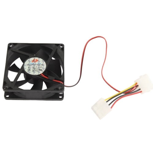

As temps are a concern, another thought I had was to drop a small case fan behind the hard drive to help displace hot air. Something like this:
Actually since the tray loader M4984 iMac cases are a foggy opaque plastic versus the glassy translucent plastics of a slot loader M5521, a nice bright LED fan in there would look hella cool.

Actually since the iMac cases are opaque, a nice bright LED fan in there would look hella cool.
(I really do try to avoid being pedantic, but ...) I assume that you meant "translucent", not "opaque"
But, yeah, an LED fan would be, well, cool. 😎
As always, context is everything.
In context of the imac g3, the colored shell of the tray loader M4984 is a foggy opaque plastic where the slot loader M5521 is a glassy translucent plastic. An LED fan would look great in both but in the opaque shell of tray loader IMO would diffuse the color more evenly giving a superior effect - something I have been meaning to try in my bondi revb.
I updated my previous post with the ever valuable contextual values to help you to understand.
