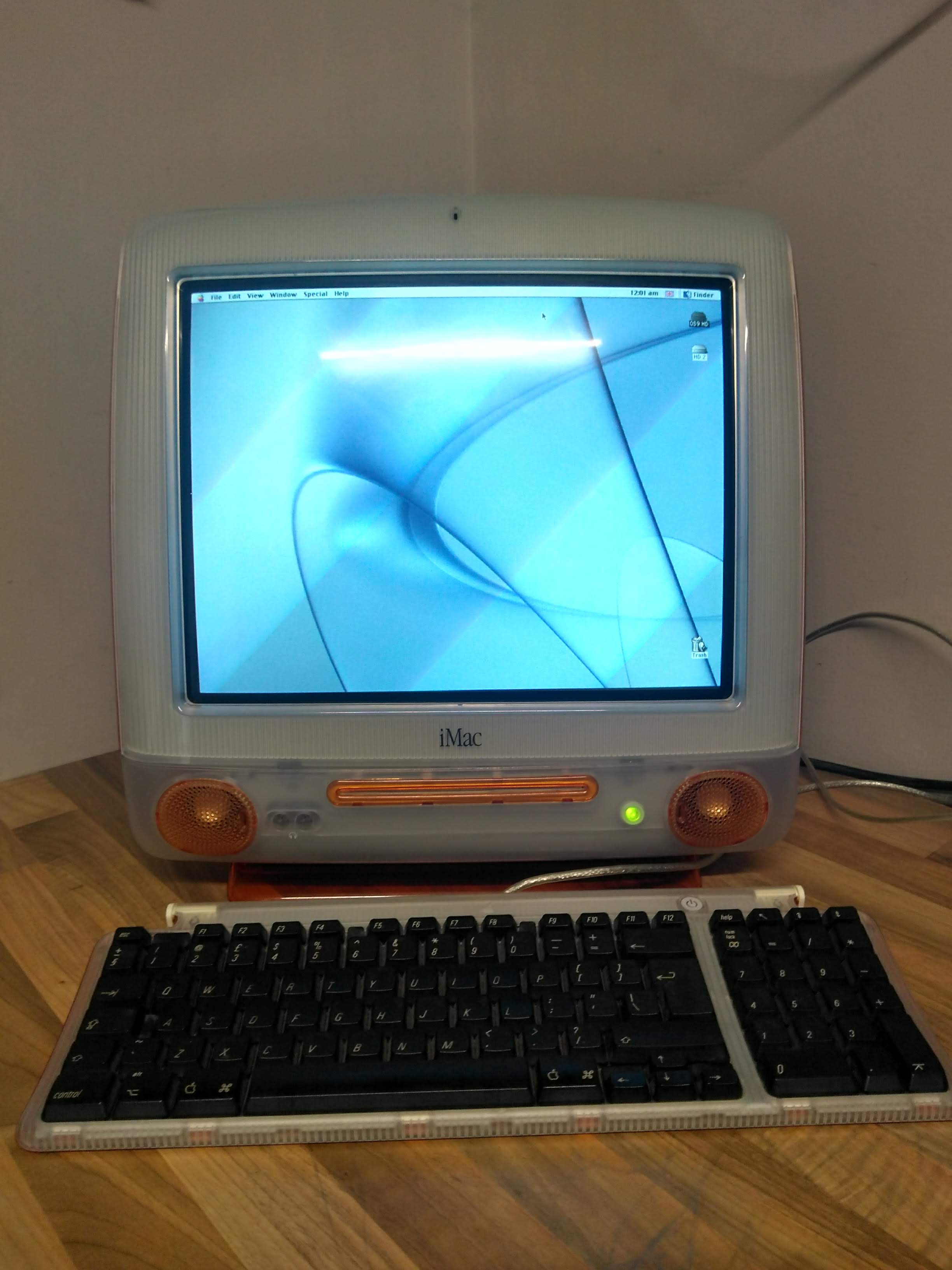

Thanks very much for the offer. However I am in the UK so the shipping would be quite expensive.
For now I have put the entire body from the Graphite machine in the tangerine shell as the tangerine shell was in better condition along with keyboard and mouse.
