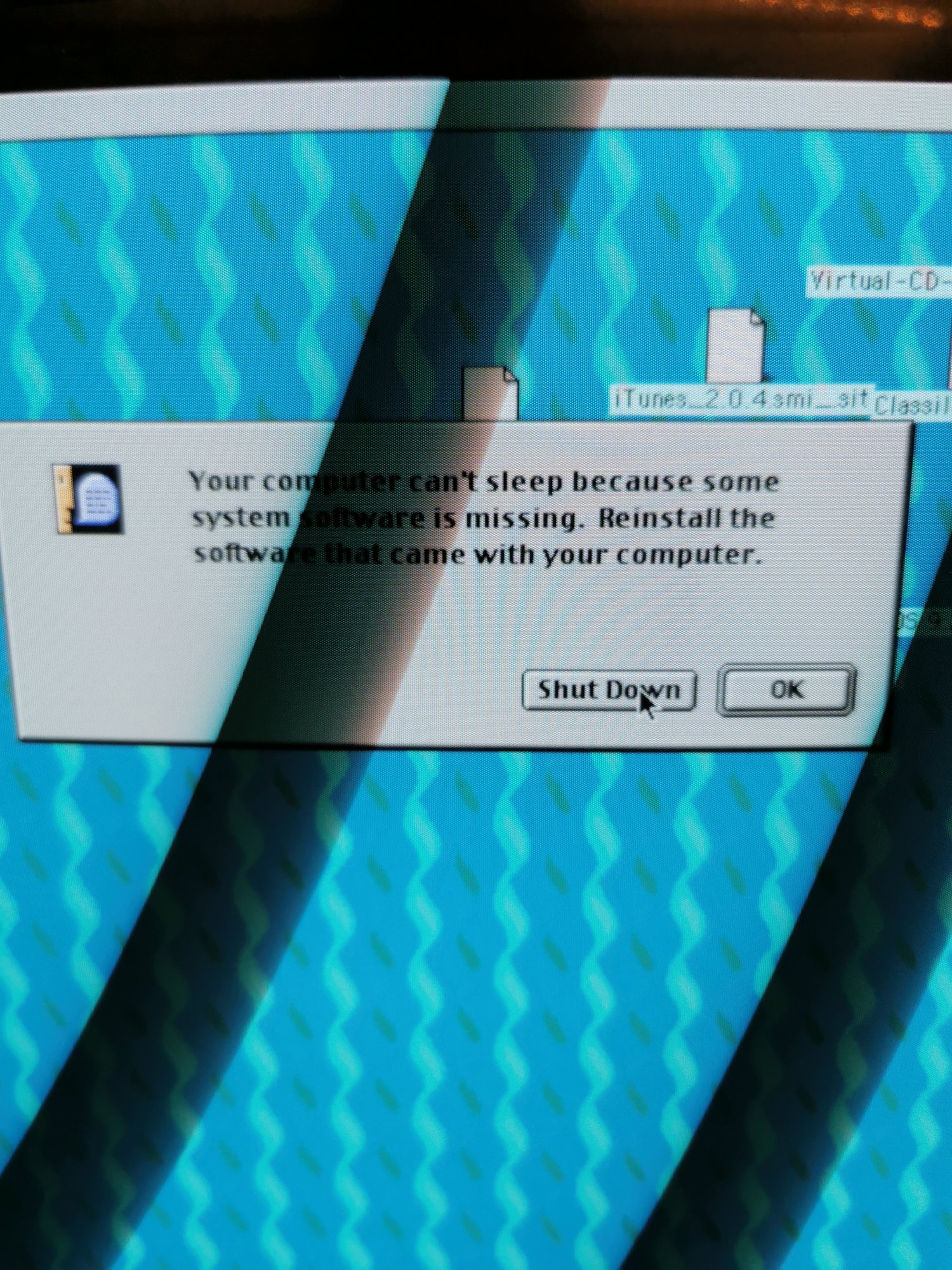

The second issue is that I am unable to sleep in OS 9. I either get an error saying that system software for sleeping is missing, or it only shuts down the hard drive with the display still lit and with a green power button.

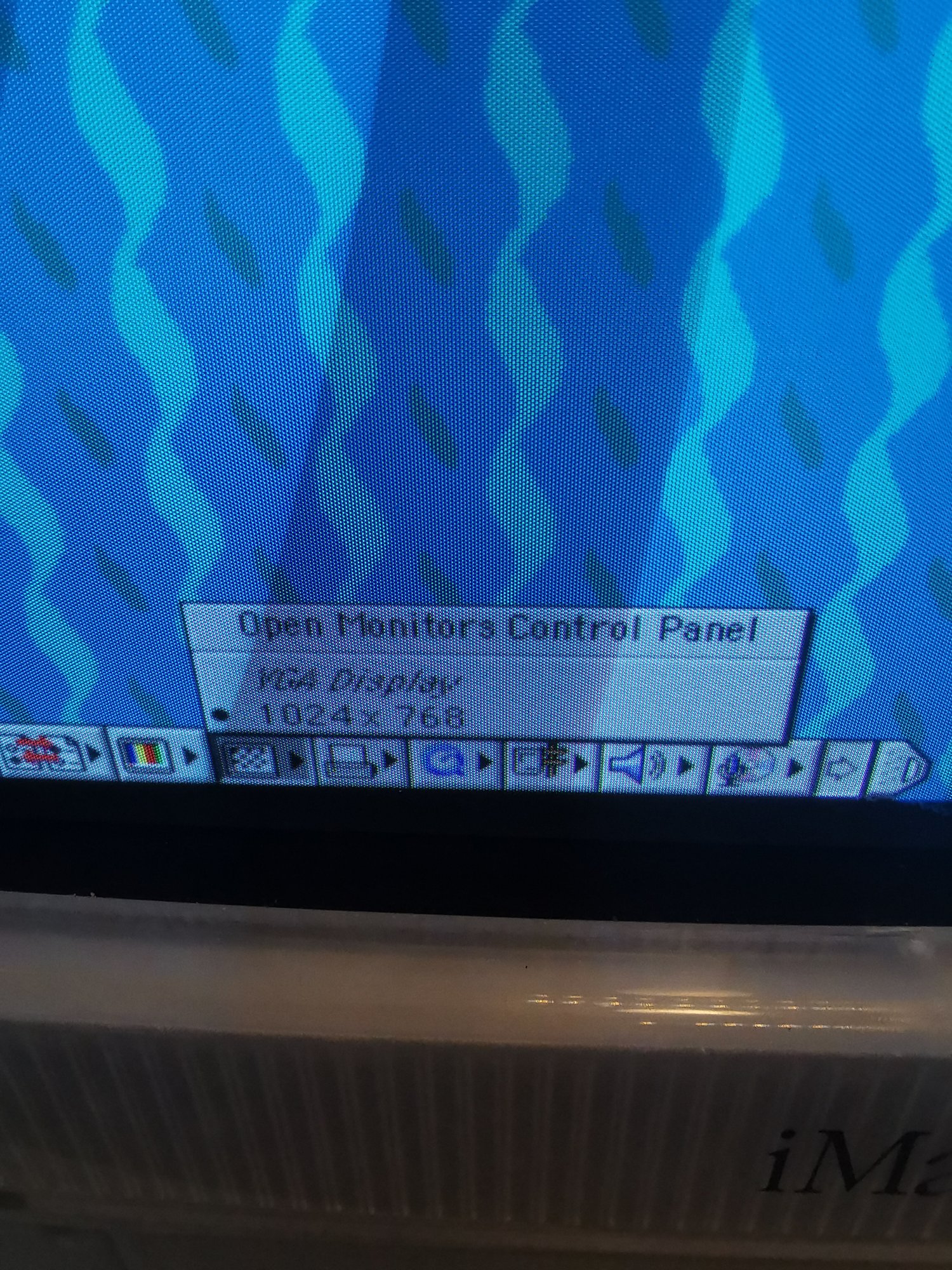

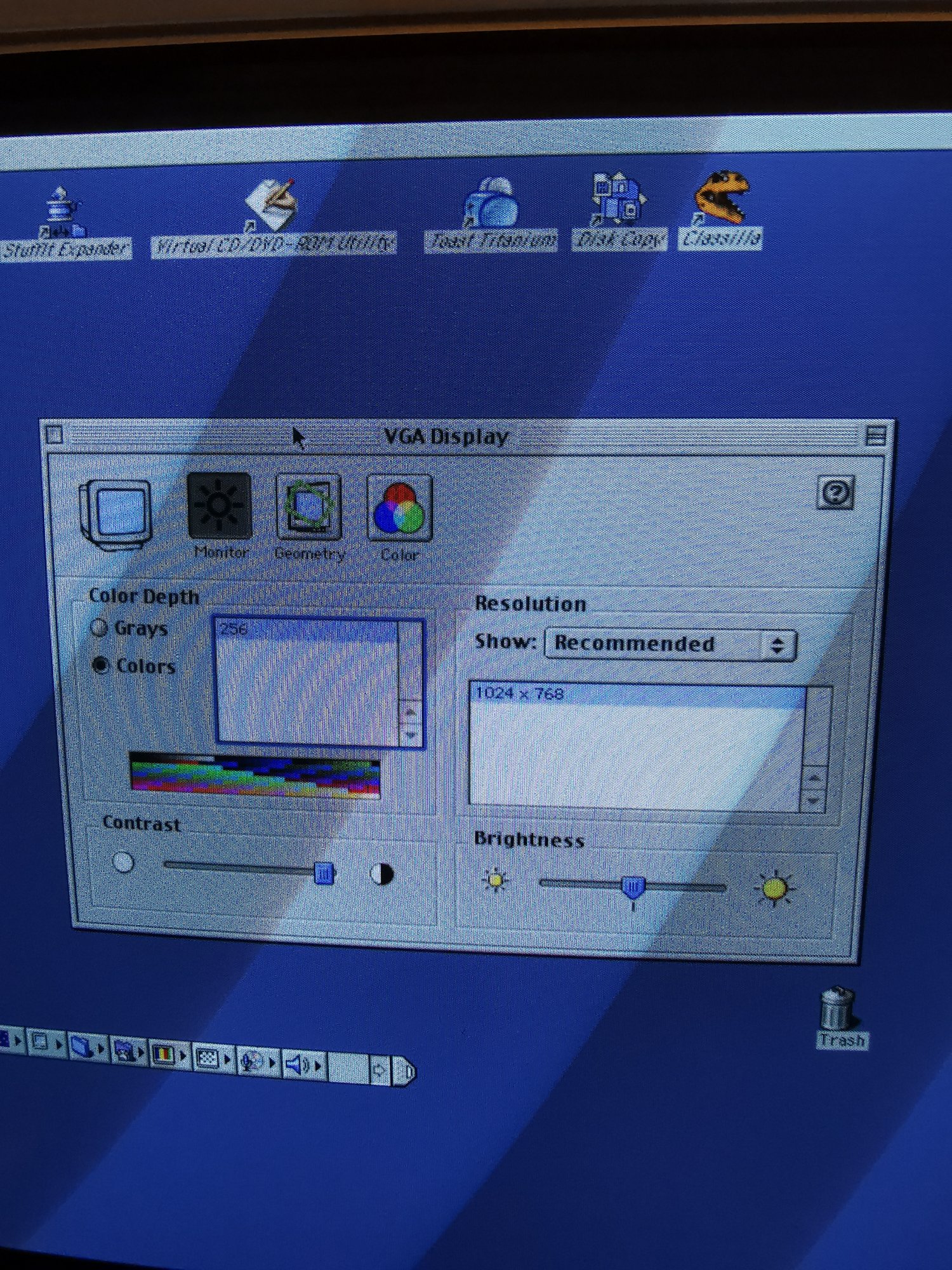

Third issue is that the computer is locked to 1024x768 at 60Hz with 256 colours. There is no other options, and the display is also recognized as a "VGA Display".

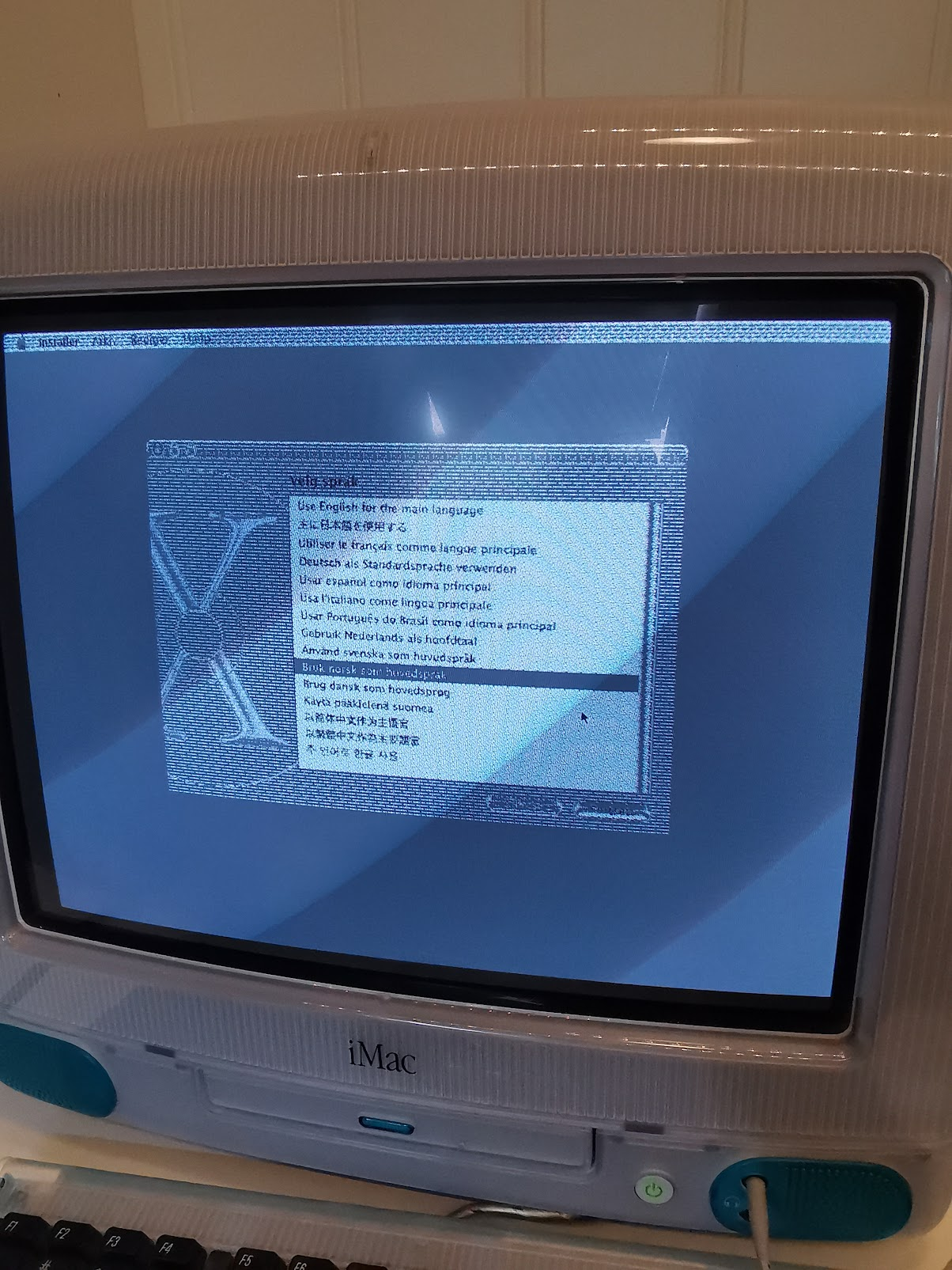

Also, while trying to install OS X Jaguar I encountered this weird graphics glitch.

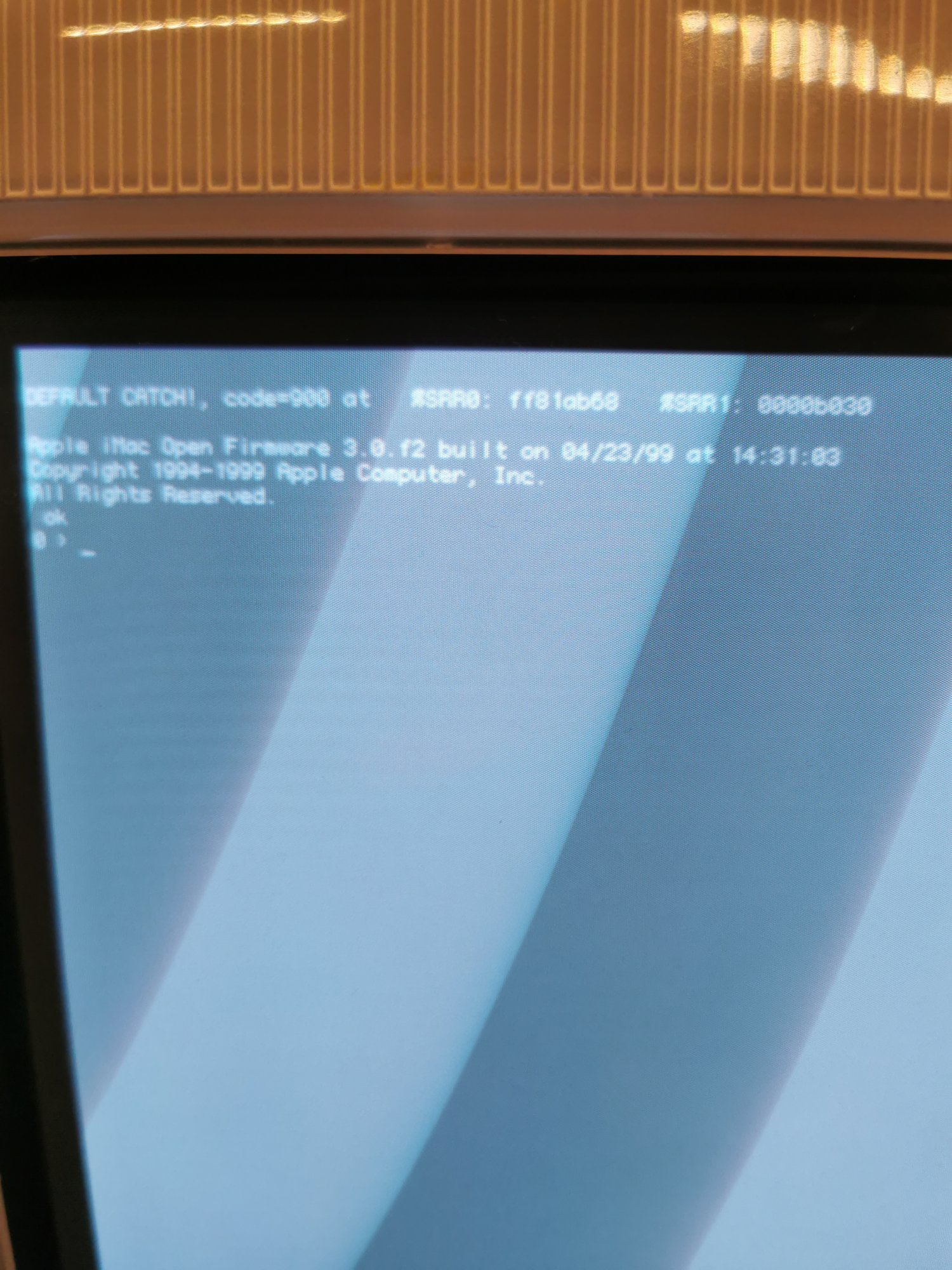

The machine is running the latest tray-loader firmware (3.0f2). I've put in a fresh battery, zapped PRAM multiple times, as well as run the "set-defaults" and "reset-nvram" commands in Open Firmware.

The firmware update is necessary for OS X installation, that could be the Jaguar issue. Also check that you have all of the VRAM installed, if someone went messing around in there and swapped out the cpu they may have grabbed other things too.

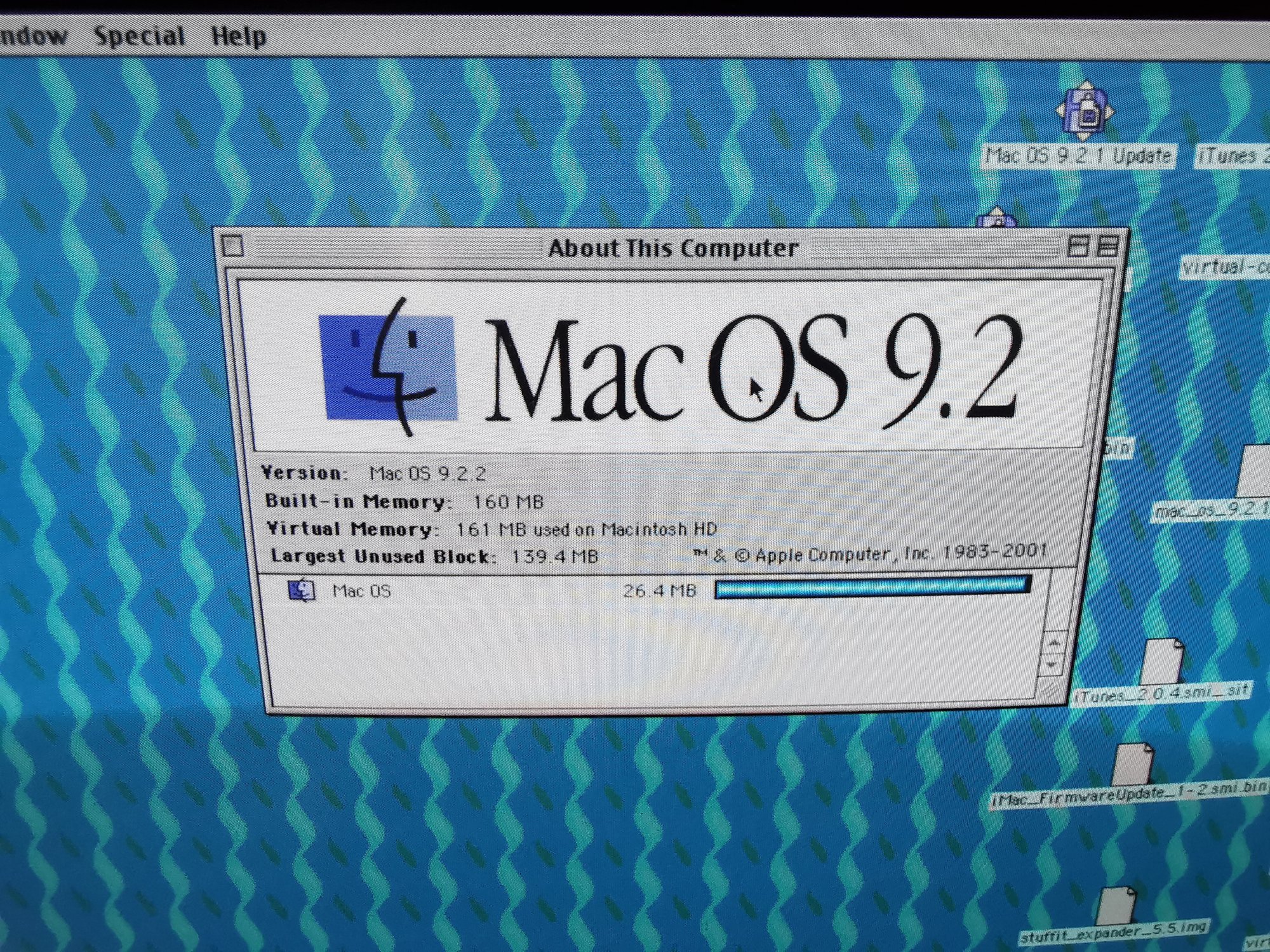

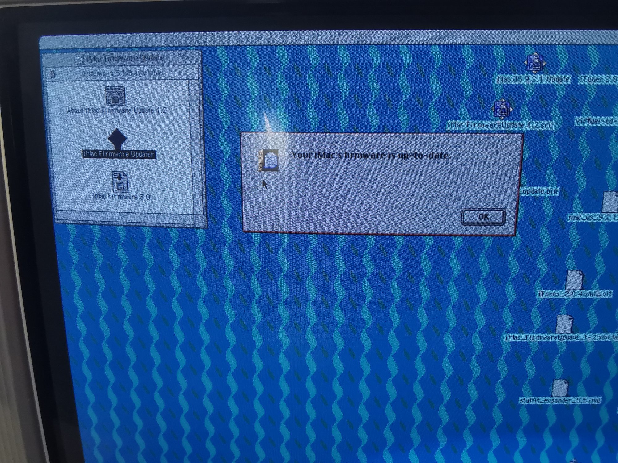

I've now updated all the way to 9.2.2. Tried installing the 3.0/1.2 update again, but it already says that I am up-to-date, which Open Firmware seems to confirm.

My 233MHz reports a bootrom of 1.3f2 in Tiger’s system profiler. Open Firmware reports the same version you said yours is, 3.0f2.
