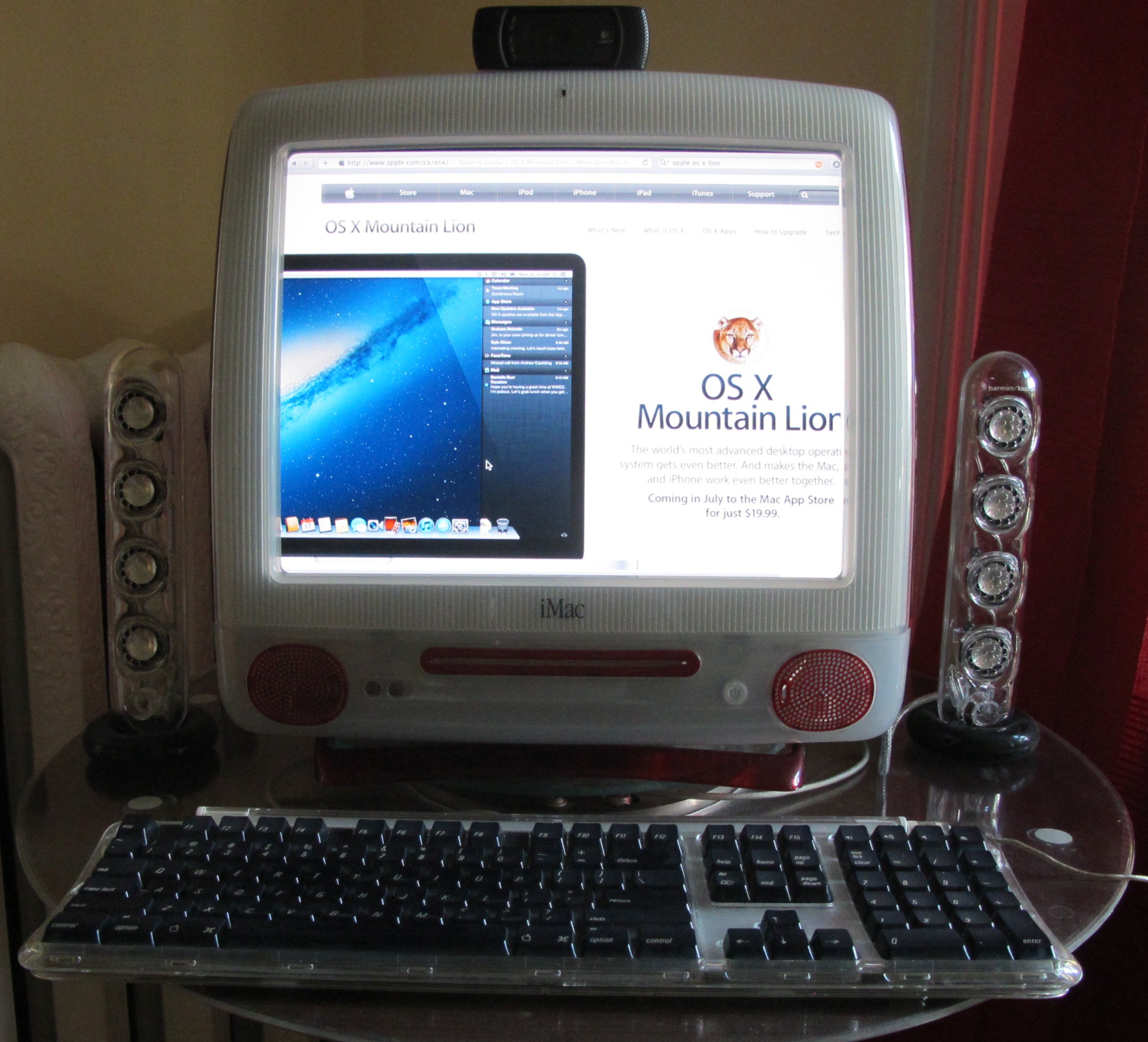

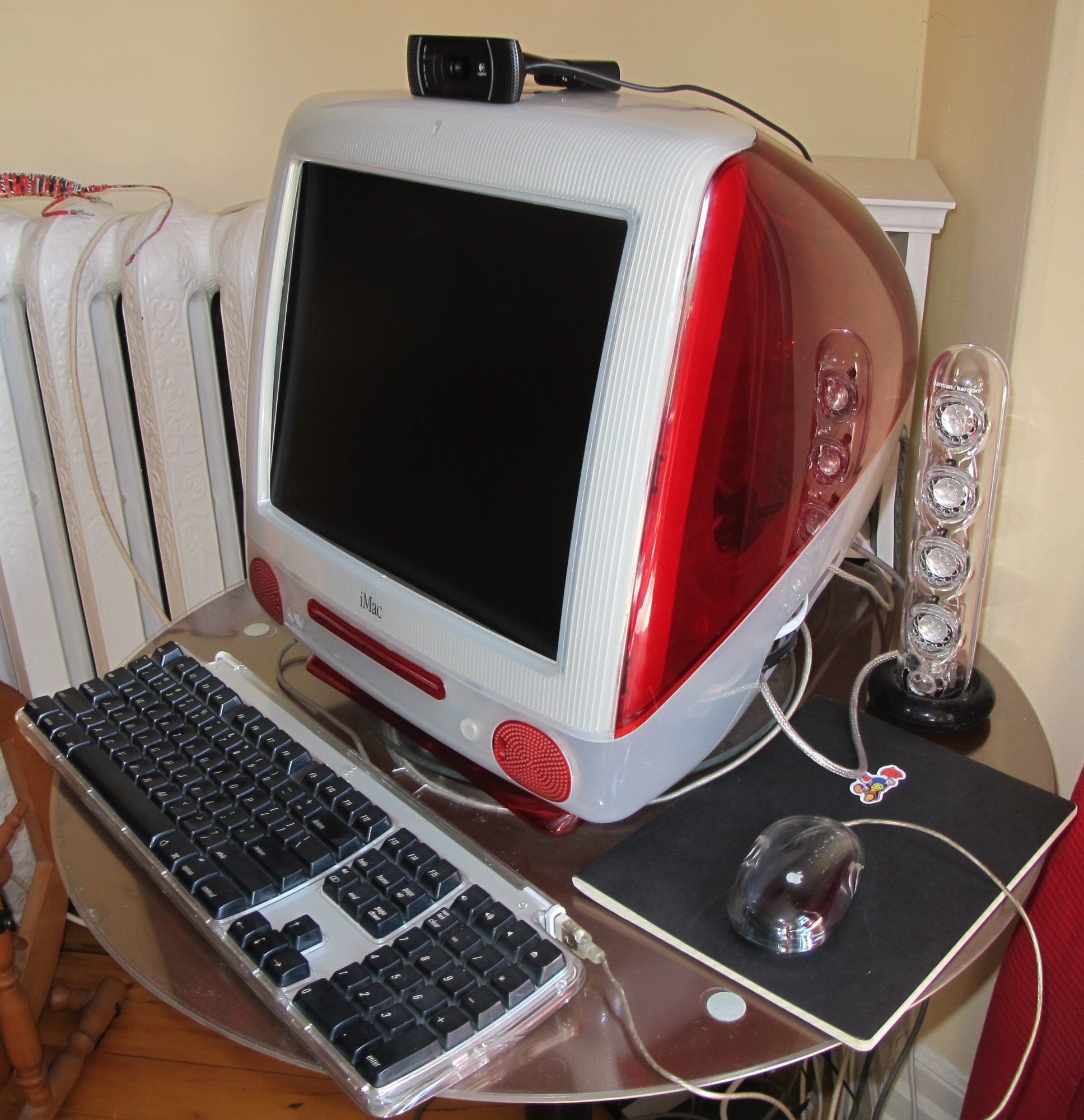

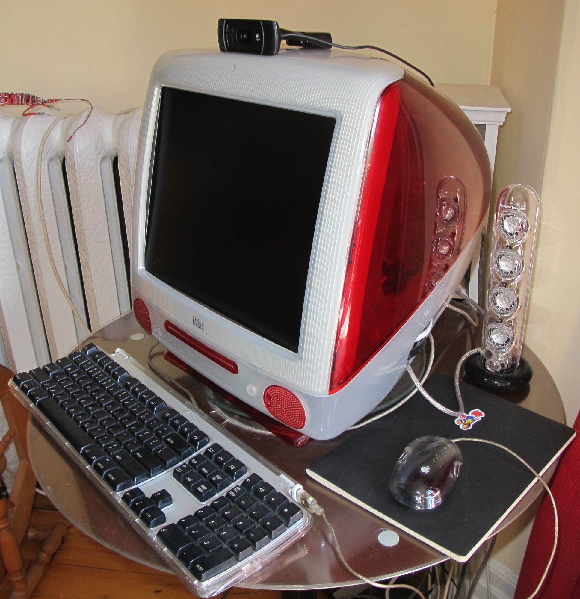

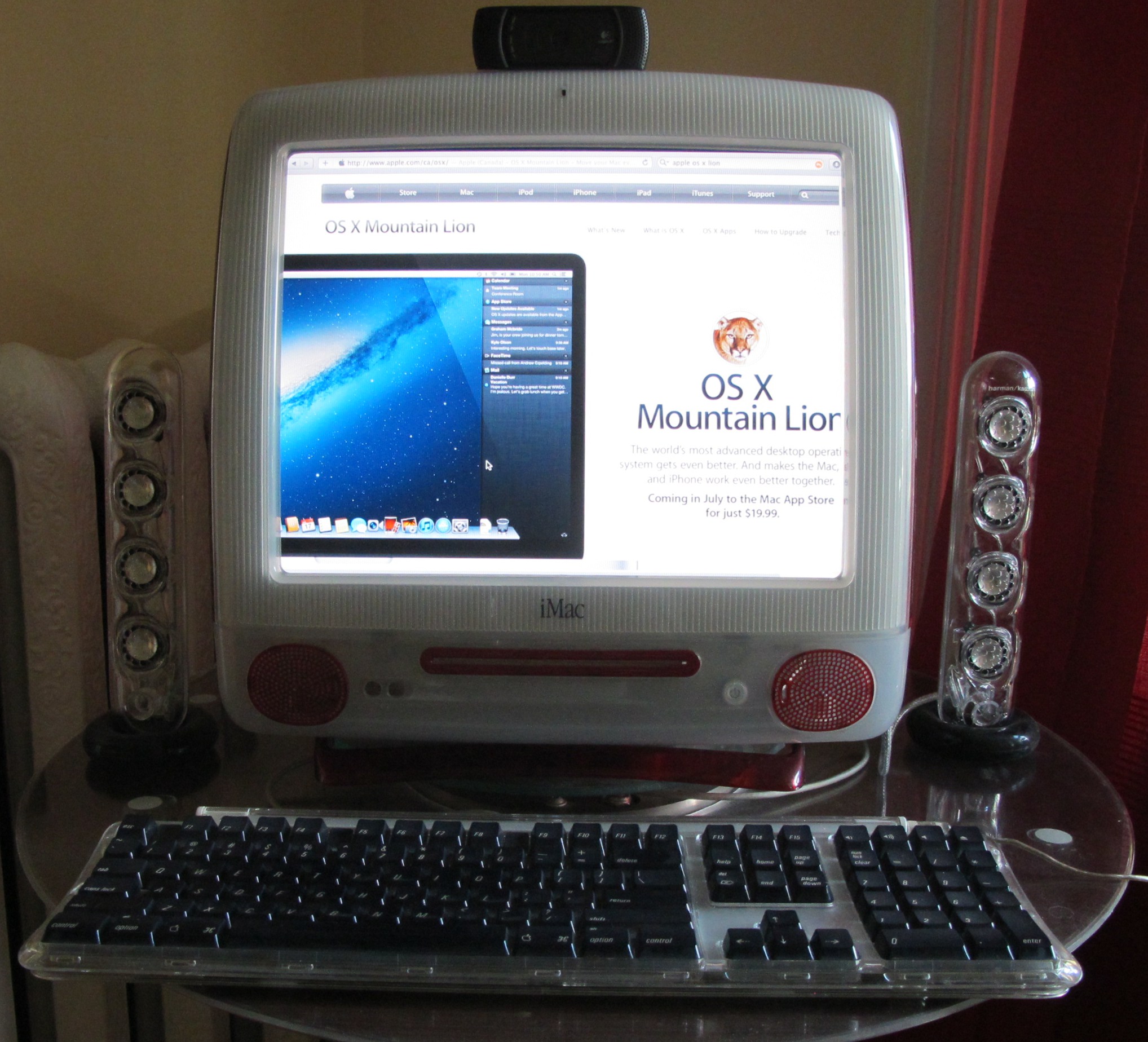

The easy (and expensive) iMac retrofit
Hi all
As a software guy, I can't help being impressed with all the hardware retrofit going on here -not up to that, so took the easy way out, as you will see if you read on...
My incentive was a wife whose favourite colour is red, and who would not give up her old Ruby iMac G3 for aesthetic reasons. Even minimal foresight told me that this could not last, so I had to start considering what to do to prepare for the inevitable demise of her favourite machine.
I got my hands on an old Bondi mac at a garage sale, and gutted it to see what was possible as retrofit. Anybody who takes one of these suckers apart must know how to discharge the CRT safely, and file through the socket to let air into the tube before disposal.
First priority was to get a 14 or 15 inch 4X3 monitor to replace the CRT, since they are disappearing into the third world (or landfill). I managed to snag a Dell monitor with a DVI interface.
The really easy (and expensive) part of the retrofit was to get a new 2011 Mac Mini as the processor. I did this because I'm no good at hardware, and could keep the Mac Mini in one piece for later reuse if the project didn't work out. I chose the 2011 because of the built in power supply, which avoids the problem of accommodating the power brick inside the case.
So, what to do with all that empty space that the CRT used to occupy? I got the notion that the woofer from Harman Kardon Soundsticks II might just squeeze in, and would make for an awesome sound system. It turned out to be a very tight fit, and I had to carve out the case under the handle a bit. The result is that the woofer sits in the case with its feet against the back of the flat screen, i.e. in your face, which becomes obvious when you crank 'er up. I left the tweeter sticks outside the case, as the volume control is a touch control on the right speaker, and I couldn't figure out how I could make that accessible from inside - so although the woofer is out of sight, the sticks are a bit of a giveaway that something is up with the sound system.
I considered adding a DVD drive to line up with the slot, but in these days of iTunes and OS upgrades via the web, it didn't seem necessary.
The day finally came when the Ruby iMac would no longer boot up, and I did the final retrofit. Not too different from the Bondi Mac, more plastic and less steel to cut.
Here is the final product, with original keyboard and mouse. It is still beautiful and red. And the sound is indeed awesome.
Oh, almost forgot. The iMac is sitting on a table made from a 1960's vintage hard disk platter reclaimed from a Control Data 808 Disk, for those old enough to remember what that stuff was like (e.g. hydraulic head activator, none of your wimpy voice coil stuff).
Cheers

that looks beautiful!! :-D well done!
As you probably read, i was thinking about using mac mini hardware, but it wasn't feasible for how i wanted to do it so i decided against it. Its quite time consuming the way ive decided to do it, however i think in the long run it will be worth it :-D
Have you a picture of your bondi? would be nice to see it!
