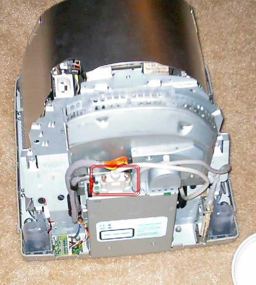

I hate to keep bringing this up, but I think you're problem is the internal monitor. I have an old 15 inch Apple monitor that can connect to the iMac's internal connector ( the one that I pointed out to you in the picture ). If you'll pay for shipping I'll give it to you as I'm certain it will allow the iMac to boot.
Thats very generous of you and I really appreciate it but I dont think I want to replace anything else on this imac, I dont think it will be cheap to replace any of the monitor parts correct?

Oh yeah once I get the monitor how should I go about disconnecting the Monitor from the powersupply? Is that the brown cable thats just two large leads that just taps into the A/C in? Or should I not do that at all?

ok, great. I'm getting the email together now.
No, disconnect this one and plug the external monitor into it.
Thanks, I cant check my email at work but I'll be sure to email you back as soon as I get home.
So I should leave the monitor plugged into the PS? that couldnt cause any problems?
Yeah, just leave it plugged in, all I did was unplug the video cable and plug the external into the internal connector.
