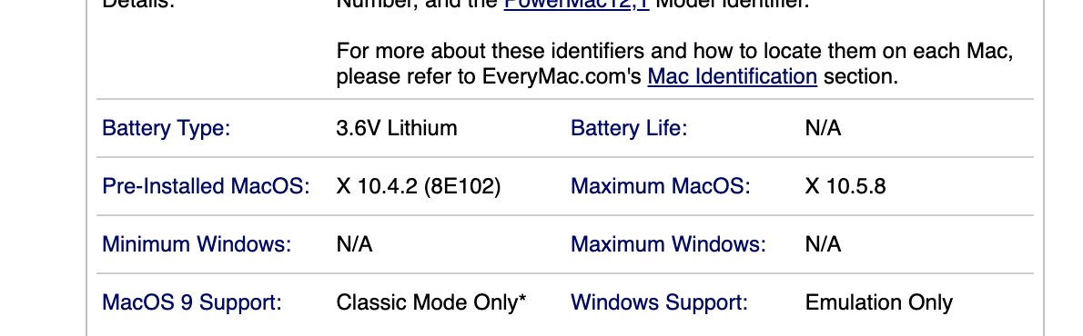

Hi, Thanks for your response. Tbh, I have no idea at all. What do you think what would be correct OSX version for the G5 iSight ? The specs say X 10.4.2 (8E102)
Is it possible for you to share a photo of the disc? That would instantly confirm whether you have the right one for your iMac.
You can use Tiger or Leopard and the PPC versions can be downloaded from here in case you do not have the correct discs. The final version of Tiger is 10.4.11 and that is achieved after installing all of the updates once you've set up 10.4 on your computer.

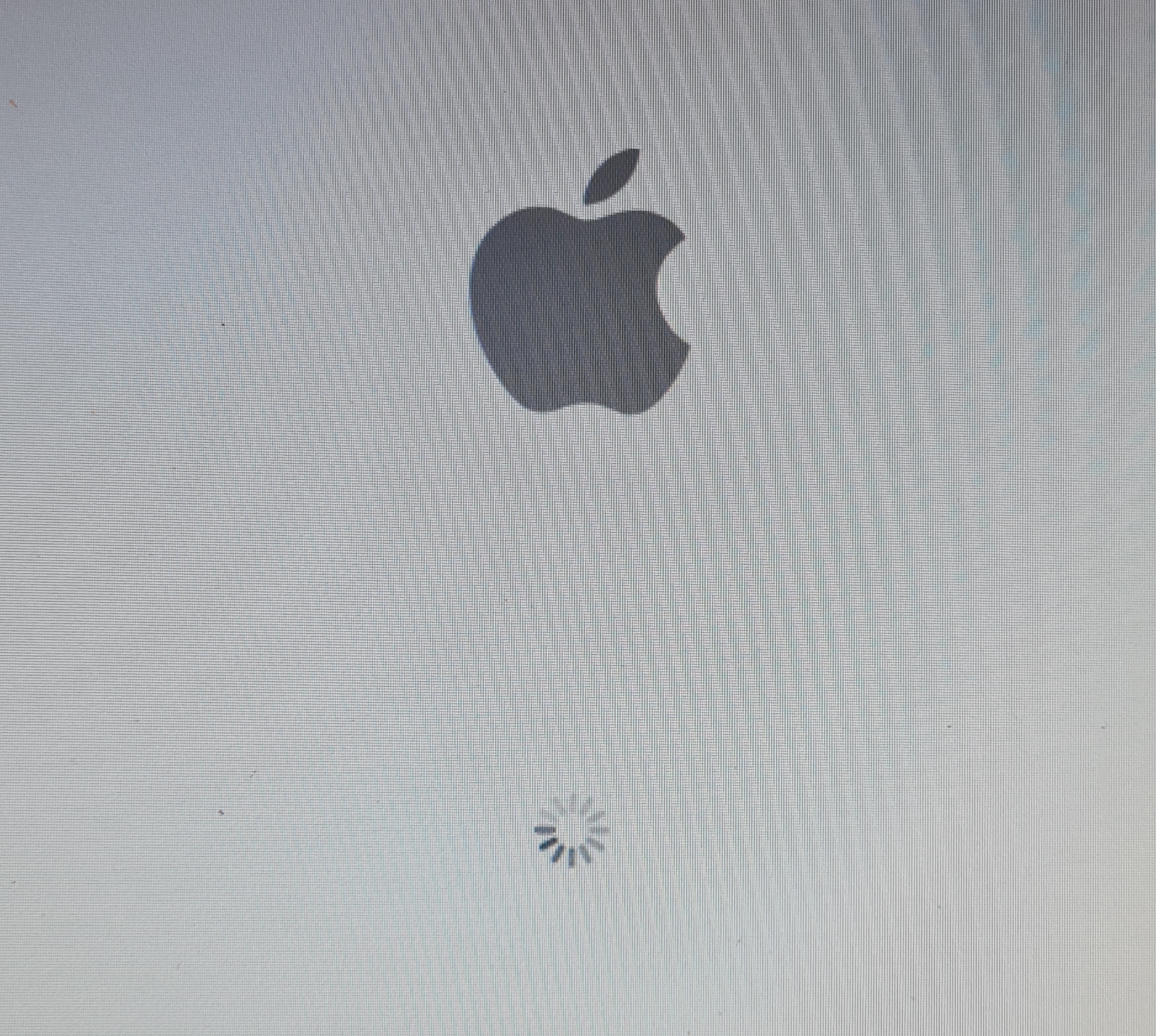

Burned the Server edition, it looked good after selecting it from the blue screen, Apple logo came up, started to spin underneath it for some seconds, then the spinning wheel just stucks and the fans of the G5 starting to blow very fast....

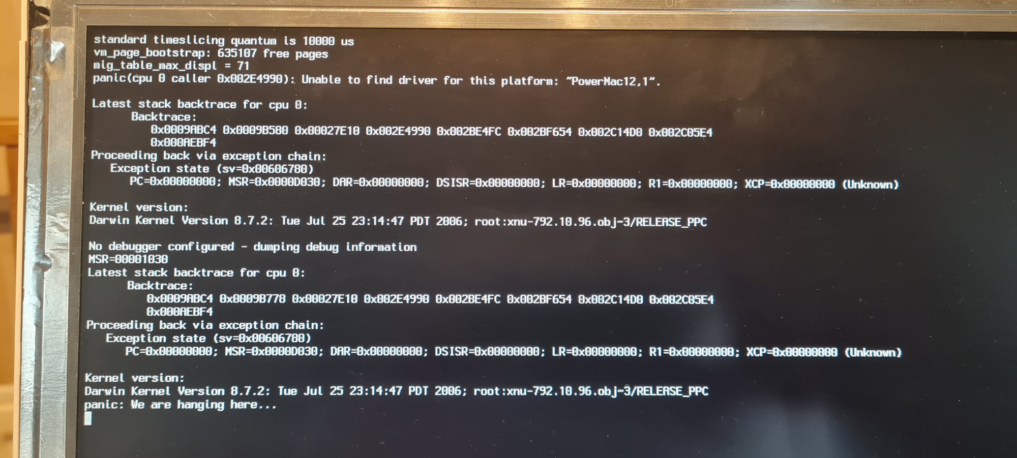

Boot with command and V held down so you know where it gets hung up at.
Thank you very much, done - This comes up, no idea what all that means.... :-( A kind of driver missing, maybe I still dont have the correct OS....(what I used was - Mac OS X v10.4.7 Server (DVD).dmg)
Unable to find driver for this platform usually means this version of Mac OS X is not compatible with the Mac you're trying to boot it on. Seeing that you used the universal 10.4.7 Server disc, this is a tiny bit unexpected as it's for compatible PPC and Intel Macs.
Maybe the disc image is corrupted, the DVD wasn't burned correctly or the DVD drive is faulty.
My next advice would be to try the retail 10.4.6 (client) disc/image which is for PPC Macs only. This one has to work on your iMac. If that doesn't work either, something fishy is going on.
