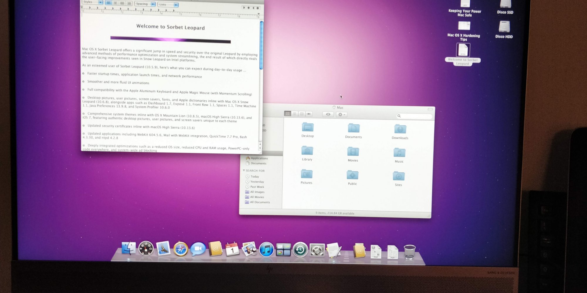

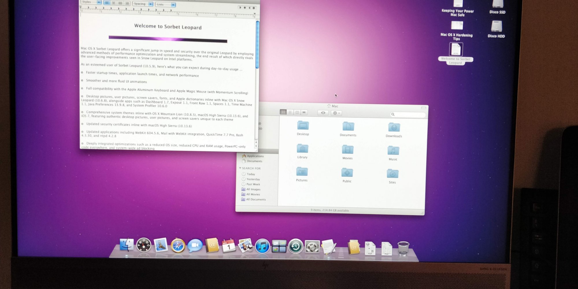

SUCCESS!
Sort of. I was able to finally load OS X 10.4. Then I got an SSD drive and installed Sorbet Leopard. Took some finagling, finally did it. There's just no way for win and mac to get along. Oh well.

SUCCESS!

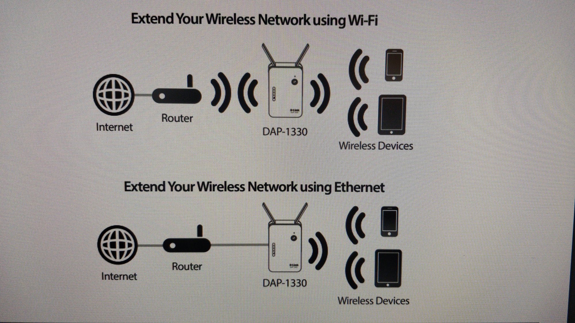

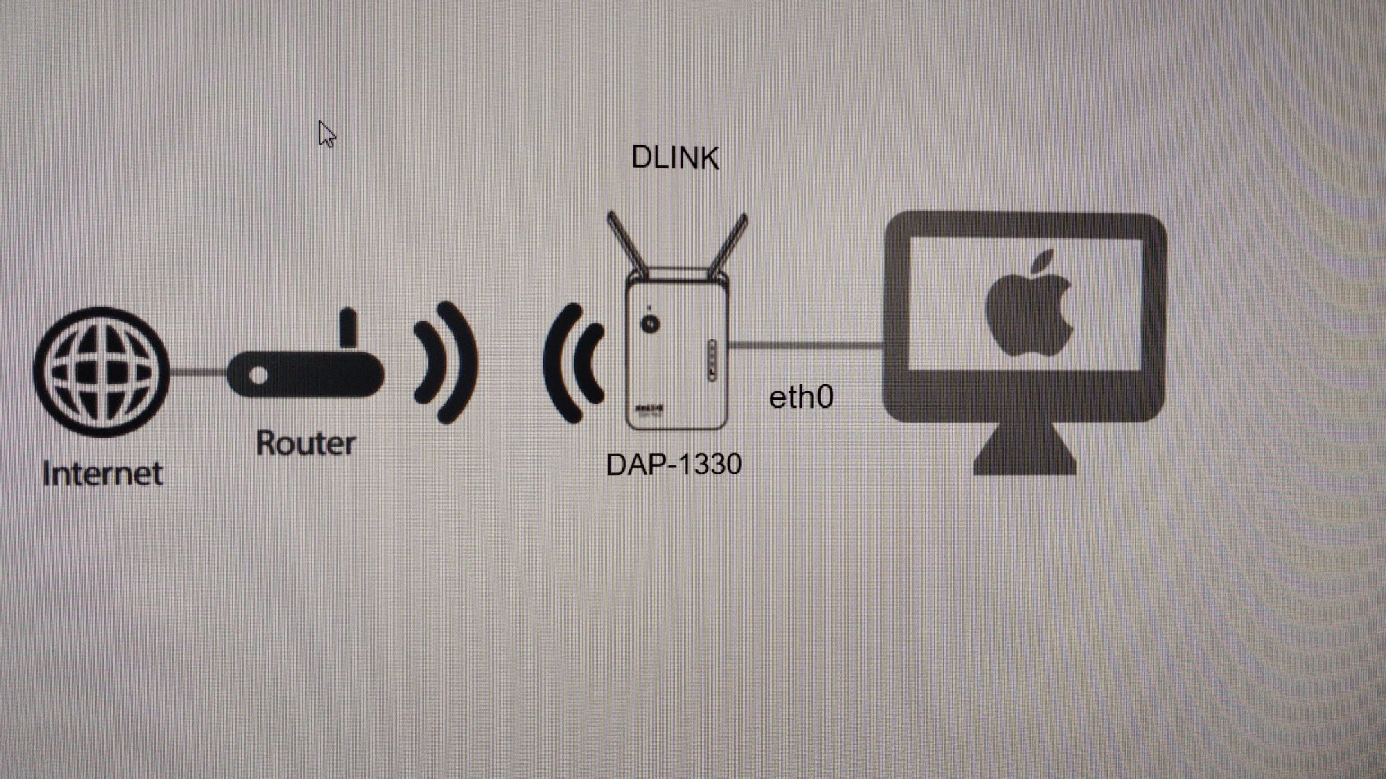

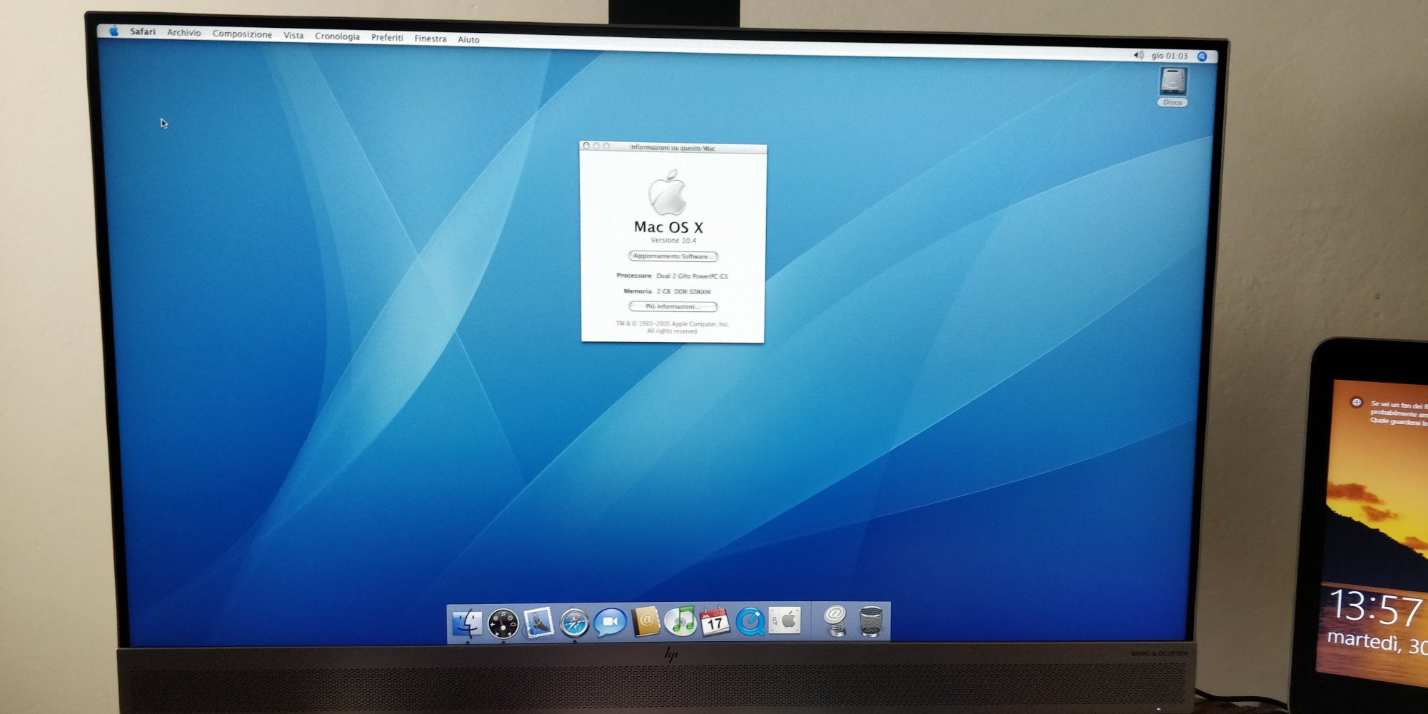

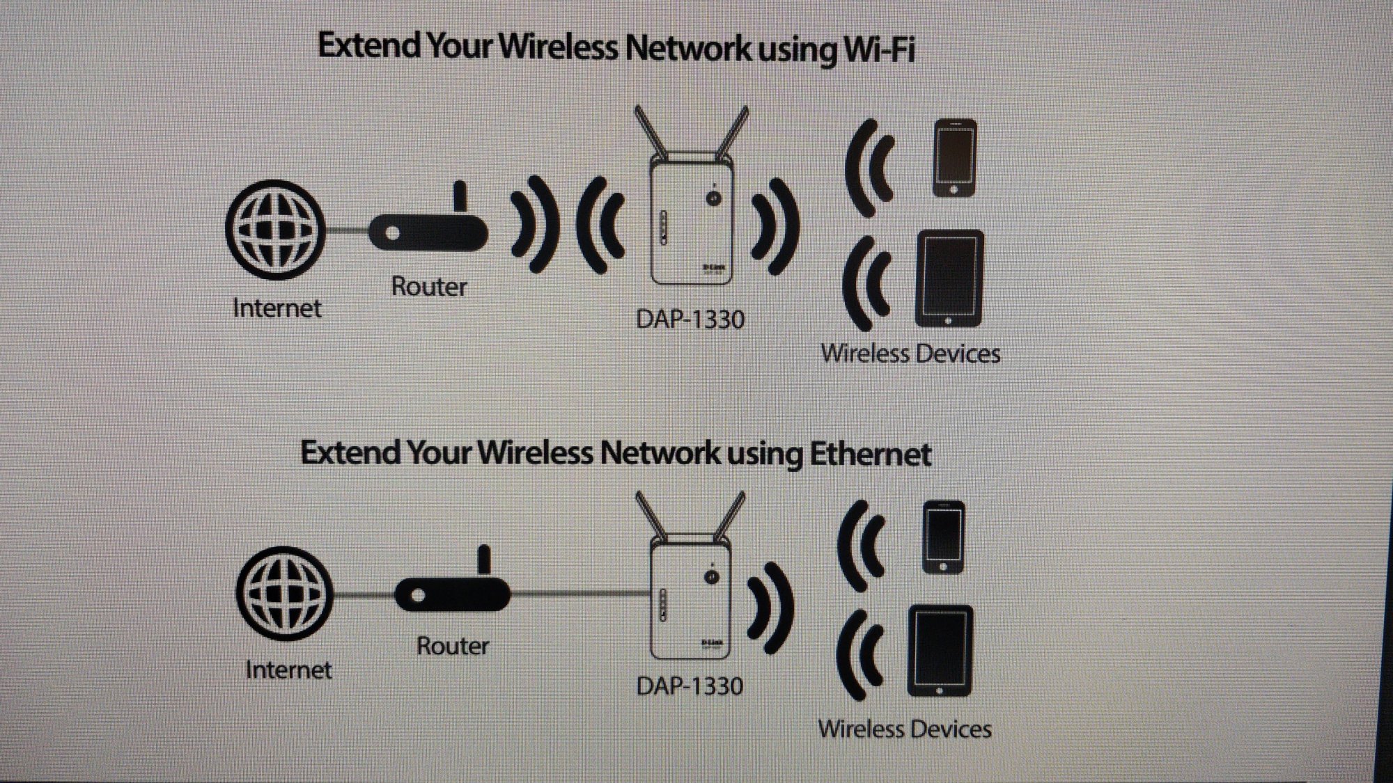

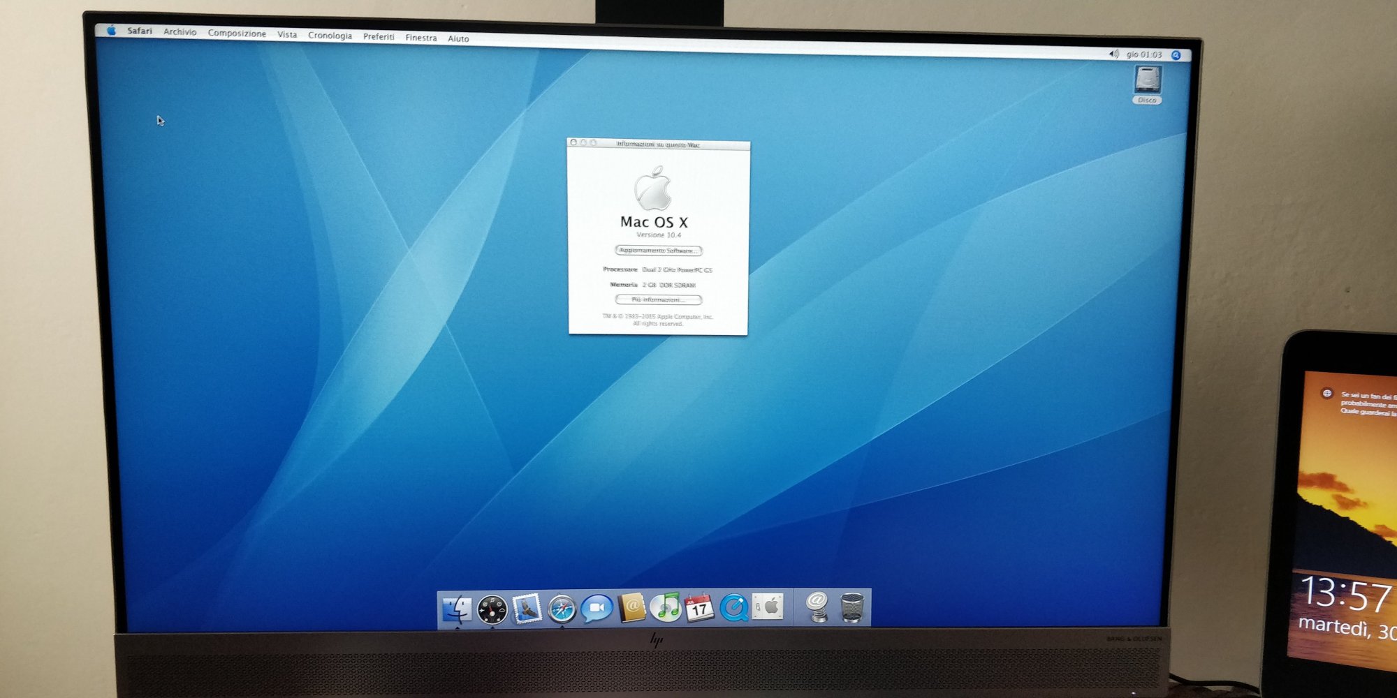

Hi all, success (of sorts). Nope, I was never able to boot from USB, despite major tinkering. In the end I borrowed a Tiger DVD, installed that on the hard drive, then copied the Sorbet Leopard .dmg on the Mac desktop and used that to restore the image onto a purpose-bought SSD.

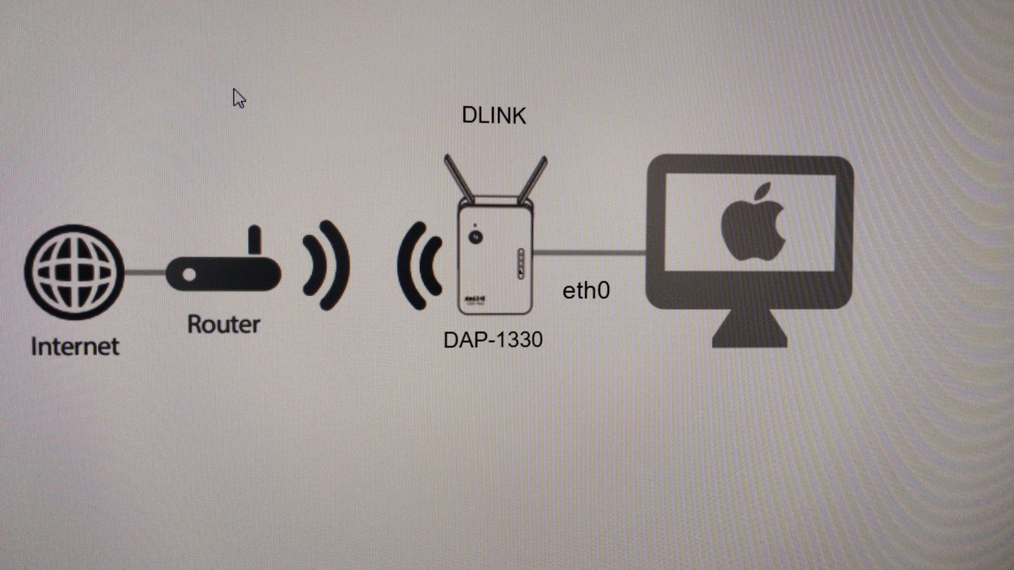

Also, the PowerMac came without the little airport daugther card, so only wired ethernet for me. I'm currently connected to the Internet in a way that shouldn't work but does?
I have a little range extender, D-LINK DAP-1330, that allows you to extend your wifi network.
This is how the manual says you're supposed to do it
And this is how I'm doing it
Like I said, shouldn't work but does... the mind boggles.
Ciao everyone! Thank you so much for all of your suggestions and insights.
Luca from Italy
